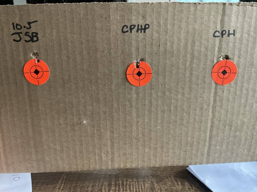

About four weeks ago I noticed a drop in the POI of my HW 44. At first I thought it might be a scope issue, but that checked out ok. I then chronied the velocity and found that it had dropped by about 200 ft./s. I checked to make sure the probe seal was not the problem and there was no blowback from the receiver. The weapon was still under warranty, so I gave AoA a call and they said to send it back. I sent it back and they fixed the issue. I know that others on this forum have had the same problem. Here is what AoA said the problem was and how they fixed it:

CPHP = Crosman Premier Hollow Point at 7.9 Gr
CPH =. Crosman Heavy Domed at 10.5 Gr
