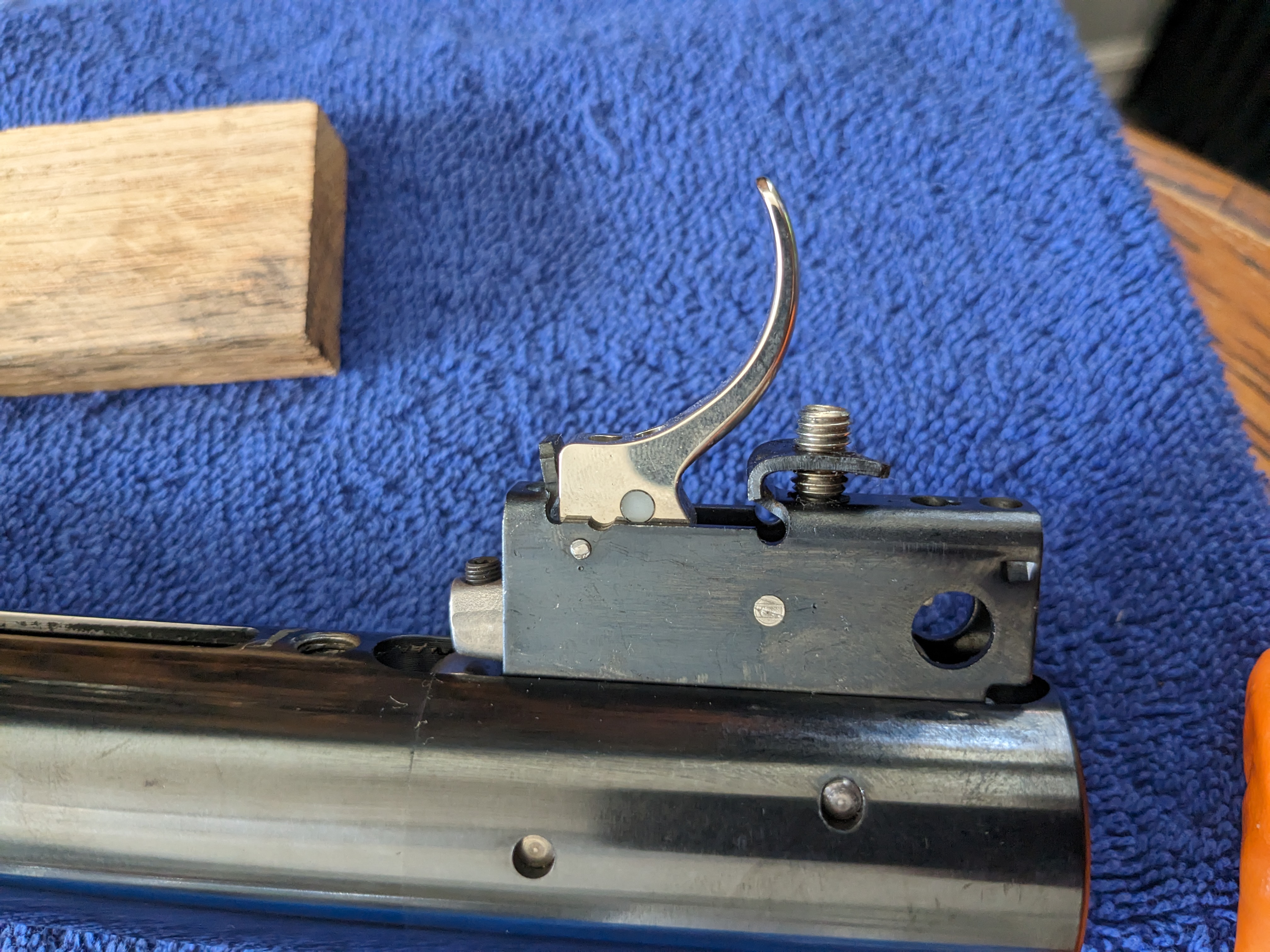

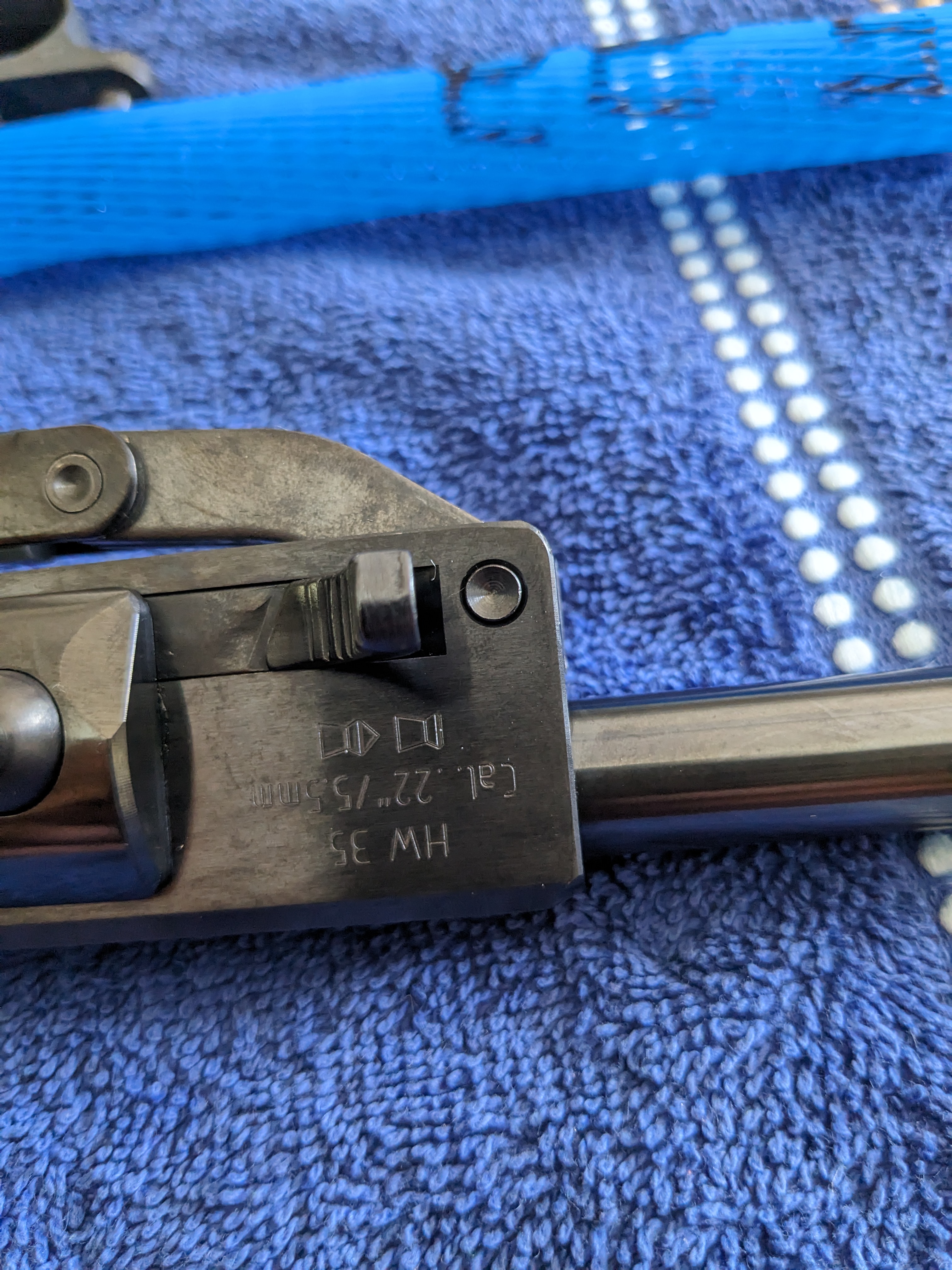

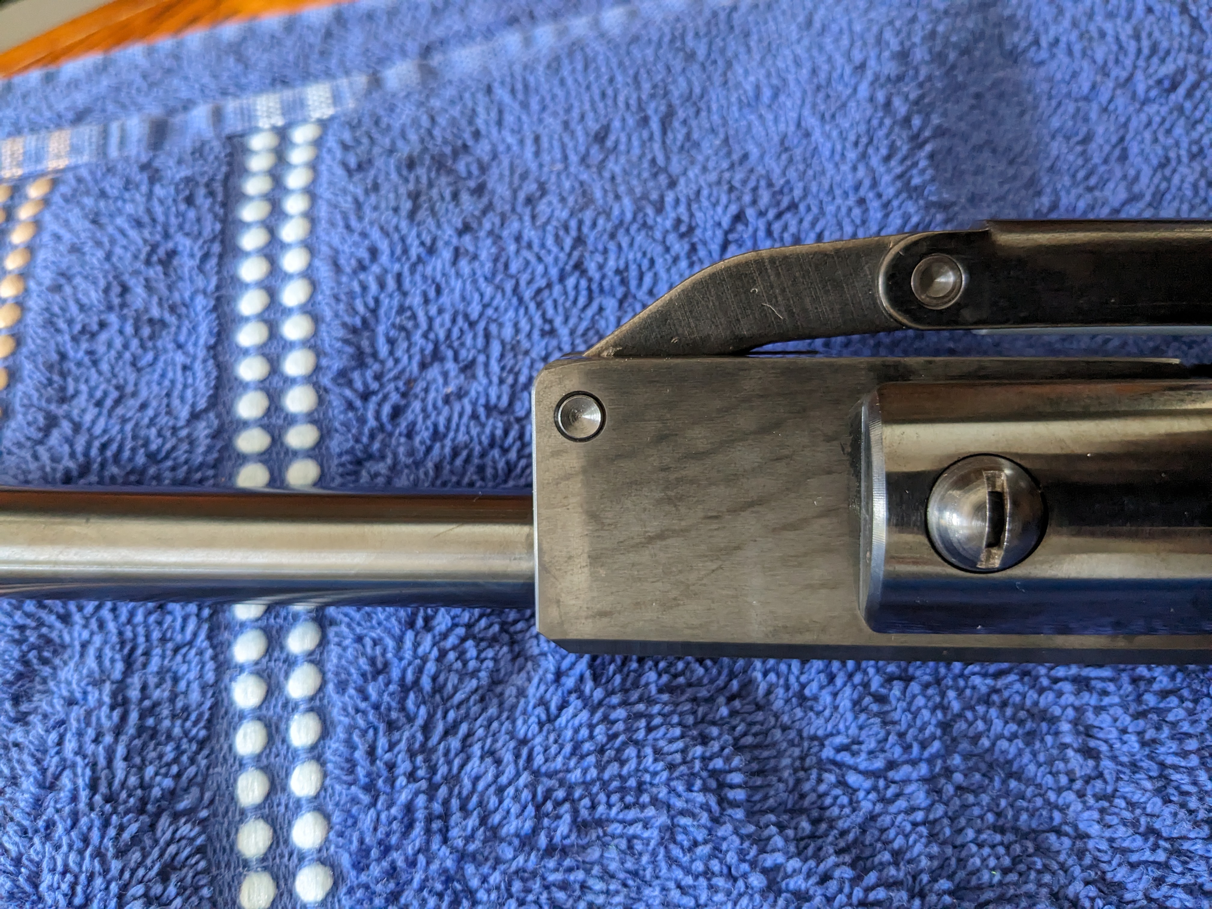

I'm finaly getting one of my 35e's back together with new barrel & finaly got to cocking rivet & remember this as something I want to go a differant route then smashing the factory replacement rivet as I don't think I can pull it off without damage. I thought I seen threaded sleaved rivets before for gunsmithing.? This is what I would want if possible. Anyone done this to HW's or a 35 ? Smashing that rivet in a vise looks easy enough but i'm sure I'll screw s.. up. 35's are to nice for just a regular shoulder bolt in my head. any help would greatly be appreciated. I also noticed I changed the trigger out in this years ago to a SS setback trigger made by who knows who. my old 13mm 35e also has this trigger so I must have liked them. also the linkage rivet pics just show the new rivet sitting in place & not pressed, it is just slipped in & loose.
Joe PXL_20230804_214448630.jpgPXL_20230804_214519780.jpgPXL_20230804_214459232.jpgPXL_20230804_214429385.jpg

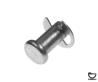

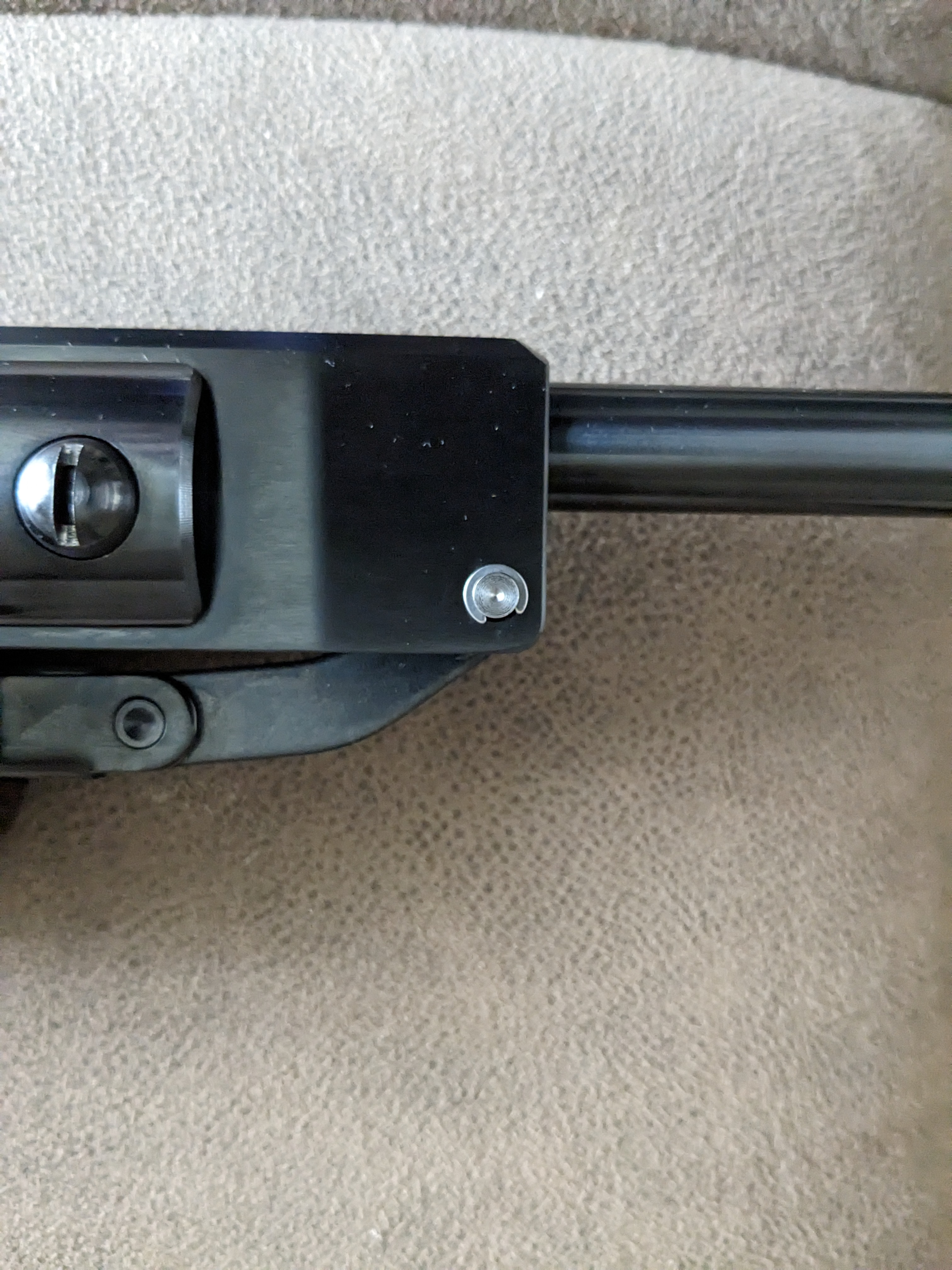

I have used these with good success. Easy on/off with no hassle.

Thanks for the info EM

These look pretty easy to make. Case hardened would work. Doesn't need blued because the screws are already black when you get them. Round stock is probably available in the pin diameter.
