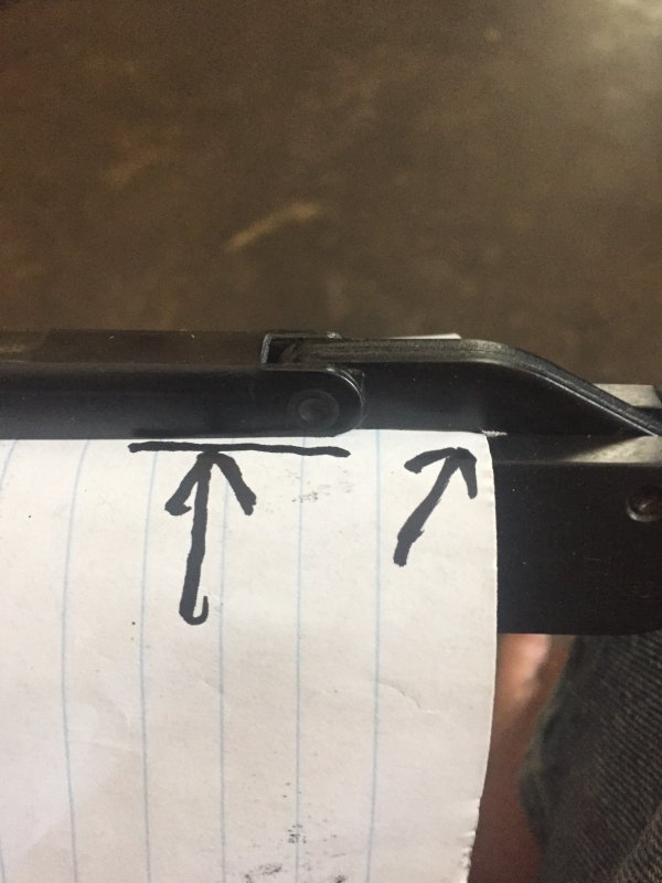

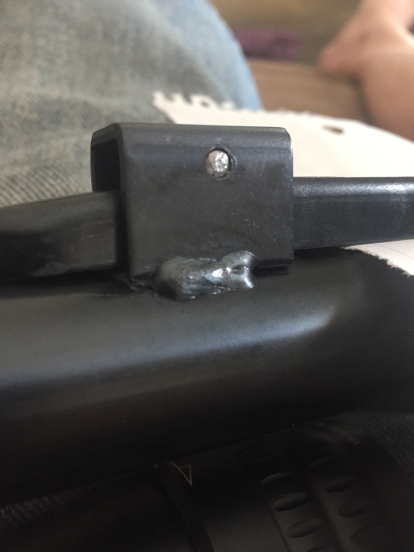

I had the exact same problem when my 30 was new. It came with the common gauling problem from the cocking lever. I discovered that both pieces of the cocking lever were binding against the bottom of the action and the barrel would not lockup properly. The pic below shows where i had to remove material to correct this.
I had the same problem with that pin pressing the mechanism to tight against the air tube,i removed the barrel and pivot assembly and took it to the grinder
And removed at least a 1/16 of an inch then found a plastic coat hanger cut a piece to fit into the lever mechanism ( had to custom fit that piece but it was easy, a little off each side then a little off the the thickness until it was a little thicker then the machanism) no more rubbing some as silk.
Shouldnt have to do that to a new gun but it is now perfect

If you have a newer gun, did it come with the plastic insert in the cocking lever? That piece is supposed to prevent the galling the newer HW30s have. On my newer "stainless look" HW30, it felt like that piece didn't let my barrel completely lock, and I'd get the same effect: a tight pattern of 4 shots, but a fifth shot way low. I removed it and got a more positive lockup and no more odd low shots.
If you feel some galling later, then deal with that issue by grinding away metal parts as shown above, or just shooting the gun until it smooths out.
