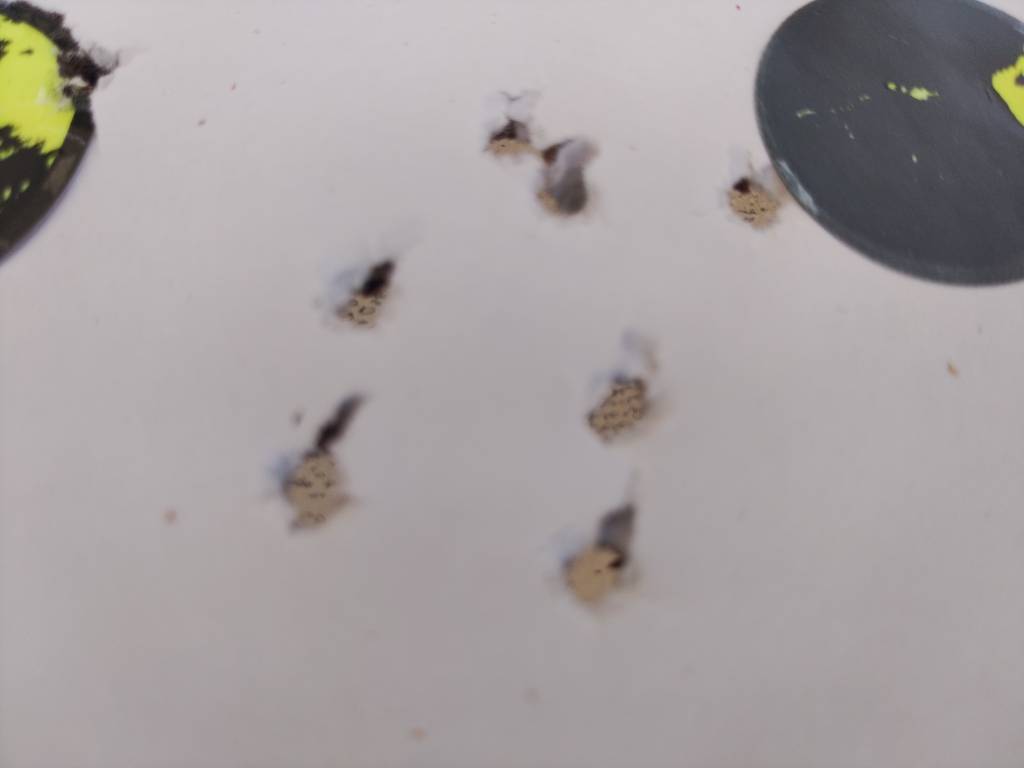

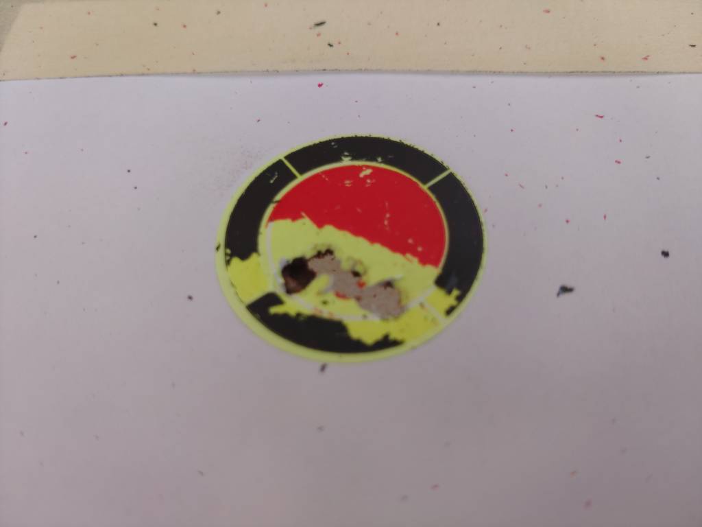

Has this happened to anyone before? I bought about 30 tins of JSB 13.43 before the pandemic and still have about 20 tins left. The Huntsman hasn't been shot for 3 weeks and I also noticed I didn't have a 40 yard holdover mark for it. At forty yards I noticed the pellets were all over the place. I figured the barrel needed to be cleaned. After cleaning the barrel, I shot the 13.43 grain and the 10.34 grain. The 13.43 was still shooting the same but the 10.34 group were touching. I must've shot 50 pellets of each weight and the 10.34 out shoot the 13.43 everytime. This sucks because I only have about 5 tins of 10.34. Every pcp I've own has always stayed with the same pellet but the Huntsman had a change of heart.
JSB 10.34 at 40 yards 5 shots
JSB 13.43 at 40 yards 5 shots. The pellet hole at the very top was my POA
It could be that the air is turned up to high for that pellet. It might do better if the regulator is turned down slightly or it could be needing to be turned up just a bit.
