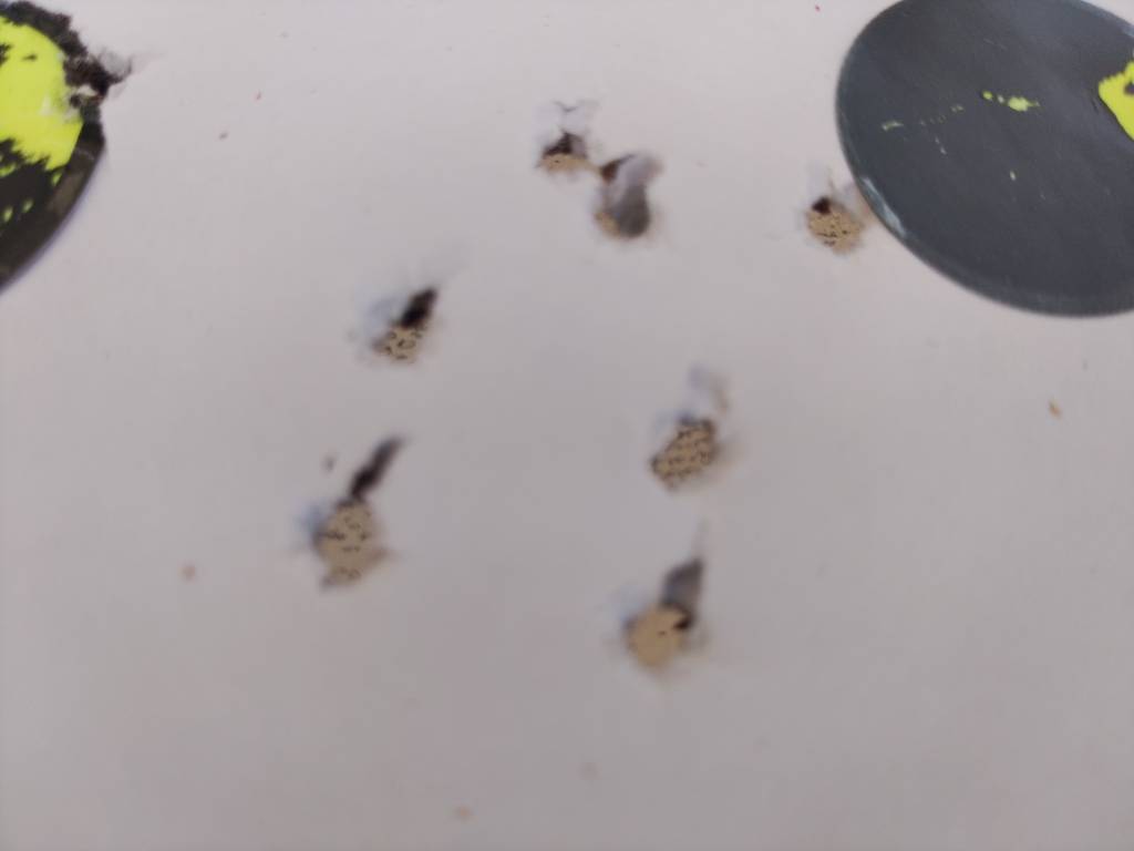

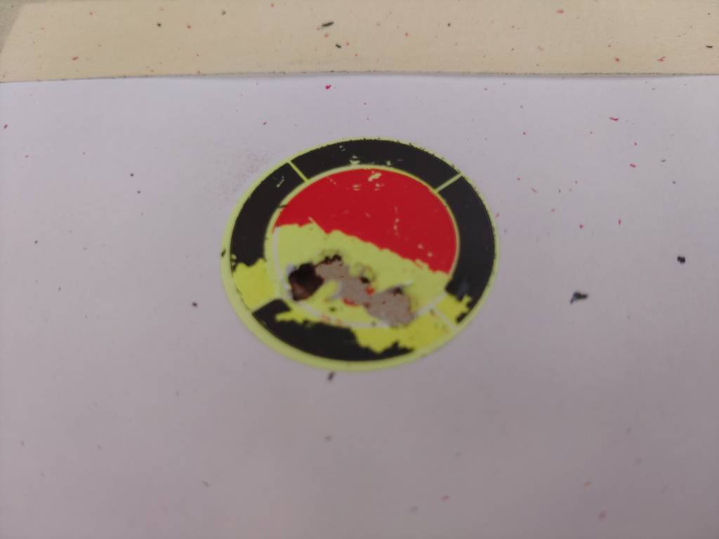

Has this happened to anyone before? I bought about 30 tins of JSB 13.43 before the pandemic and still have about 20 tins left. The Huntsman hasn't been shot for 3 weeks and I also noticed I didn't have a 40 yard holdover mark for it. At forty yards I noticed the pellets were all over the place. I figured the barrel needed to be cleaned. After cleaning the barrel, I shot the 13.43 grain and the 10.34 grain. The 13.43 was still shooting the same but the 10.34 group were touching. I must've shot 50 pellets of each weight and the 10.34 out shoot the 13.43 everytime. This sucks because I only have about 5 tins of 10.34. Every pcp I've own has always stayed with the same pellet but the Huntsman had a change of heart.
JSB 10.34 at 40 yards 5 shots
JSB 13.43 at 40 yards 5 shots. The pellet hole at the very top was my POA
@Wyshadow I have experienced something similar with my Edgun Lelya 2.0 with heavier pellets at 35 yards. I didn’t figure out what caused the issue. I also cleaned the barrel in attempt to remedy the issue. I think it could have been the pellets from a particular batch/lot number or maybe a MKI vs MKII issue. I also had some metal magazines that I stopped using. They didn’t seem to pair well with certain pellets. I’m really not sure which factor or combination of factors were at root of the issue. The gun did go back to shooting the way I was used to and has remained this way after cleaning the barrel, sticking with the lighter pellets, and plastic mags. It will shoot certain heavy pellets. I just have to refer to my notes for the different holdovers corresponding to them.
Do you have any DOPE notes on the heavier pellets from any other distances? Have you obtained any new mags? Have you performed any new tunes or replaced any parts recently?
