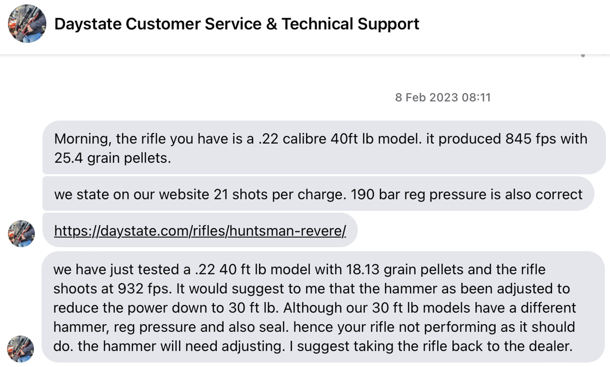

Here's Daystate's side:
Well, it sounds like Daystate sets up some 40 fpe .22 Revere rifles. IMO, this is a marketing result of the current high power popularity. If that power and shot count are what you want, nothing wrong with it, but it's not the way I would choose to enjoy the Revere platform. It sounds like someone tried to achieve high power performance by tuning up a standard power rifle, with the obvious results. Good luck with a satisfactory resolution.
