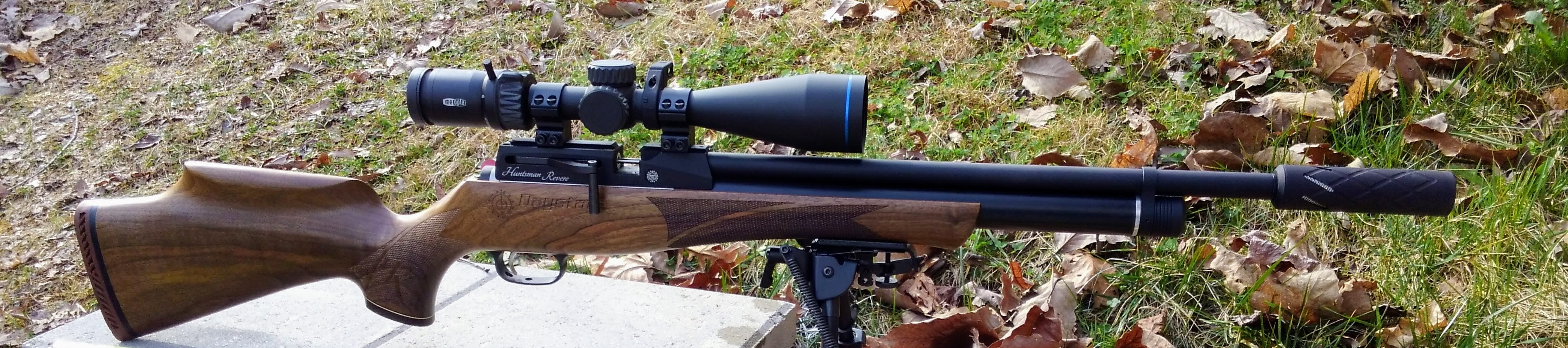

I also own a Daystate Revere .177 unregulated . It seems to shoot very consistent from a 210 bar fill down to 100 bar. Without running it over a chronograph , I would say that there is very little spread in the velocity , based on it's accuracy. It is one of my favorites. Congrats on the inbound Revere . You'll love it.

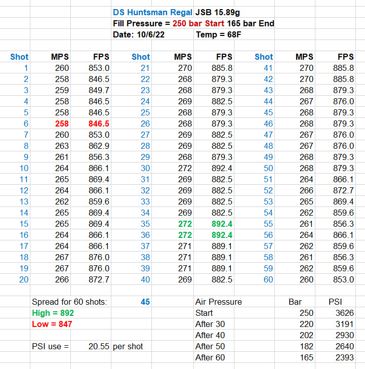

I have a Huntsman Regal .22 unregulated.
Attached is a shot string from 250 bar fill.
I also have a Huma reg for it. Huma reg did not noticeably improve shot count in .22 cal. So I took reg back out - as you can see it doesn’t need it.
I think .177 would benefit most from reg - in terms of improving shot count.
As you are thinking.25 cal, I’d skip the reg.
If you buy unregged and then add reg yourself, thats the best setup because you have foster fill. Use compressor gauge for fill pressure.
-Ed
-Ed
