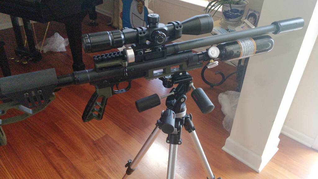

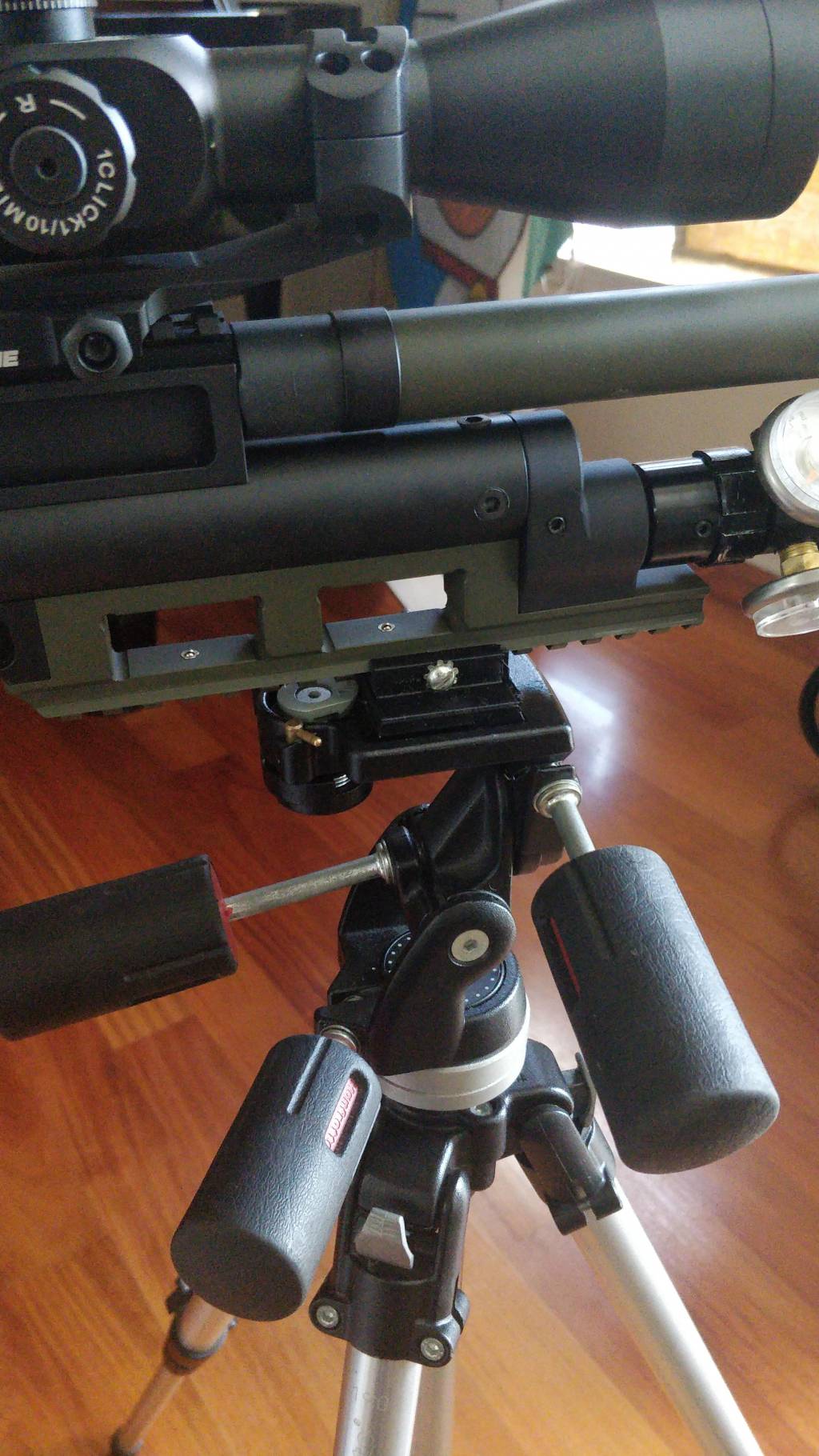

I haven't taken my tripod out hunting (yet). For stationary shooting I designed and 3D printed a picatinny to 200PL/RC2 adapter to mount my JSAR Raptor Mini on my camera tripod. The center of gravity of this gun is within the bottom picatinny rail section so it balances very well. I wouldn't trust the 3D printed part on a gun that has a strong rear weight bias. I originally made the printed part as a test to see if the tripod would work for this, with the intention of machining a metal version, but the plastic one worked so well I called it done.

In my case the tripod head has independent axes for pitch, yaw and roll. The yaw axis doesn't tend to move on its own, I leave it loose. If the yaw axis is plumb the roll axis equates to rifle cant, so I set it and lock it. I keep some drag on the pitch axis so it can move but not too floppy. Usually I'm shouldering the rifle but if I need to let it go I firm up the pitch axis.
