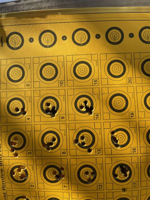

Ok, today I bit the slug, figuratively, not literally. Cranked #1 on my Mav .22 Compact up to 150bar, cranked #2 up to 130 bar, moved my HSA out to 20.0mm for starters, as a note, one full turn = 1mm. STOCK Hammer and Spring. Slug Probe and Slug on the transfer port. FX/RMR 22gr slugs, 25 yards. started shooting and moving the HSA until speeds fell of of 930fps, backed it off and tweaked a touch.
Shot count: 10
Low: 921
Hi: 942
Avg: 930
Spread: 21
STD Dev: 7.5
921
926
939
930
926
942
926
939
923
926
Sound was a nice Pffffffttttt, no extra air.
#9 and #14 are the last groups 25 yards, occasionally I'd get 5 in a hole then something would head off. I'm calling this good. Monday I'm going to try for squirrels at my Horsemans permission. If anyone has the BC for these besides .8 please let me know According to RMR it's .093.

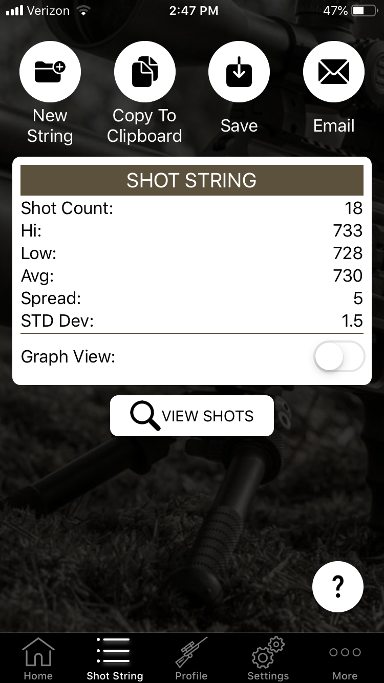

Not sure if that is the best you can get from it. Here is what I get from my Dreamline Lite Bottle in .177 and my current setup on the FX Maverick Compact in .22
Reactions: qball
View attachment 384364View attachment 384365
Is it the best, perhaps not but it's close enough. I was plugging Ground Squirrels at 100 - 120 yards today. The slugs are expensive, I'm not inclined to spend a ton of money that isn't necessary. I may sacrifice a few 18.13gr's and see if I can tweak it in just a bit more.
