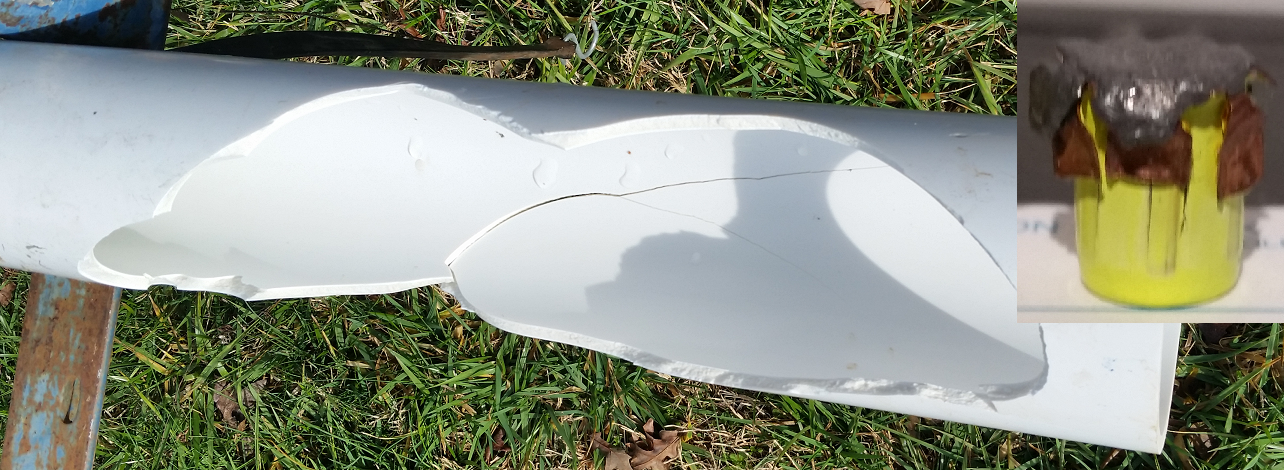

This is what the xtp does in a 4 foot long 6" sched 40 pvc at 90 yards, bullet entered as near to perfect in center, plastic grocery bag strapped over entrance side to hold in water, rubber test cap on other end held on with screw hose clamp. Had it resting on the lifting forks on back of tractor held down with bungee cords. Over 16 lbs of water, blew entire pipe off tractor forks, blew out rear test cap and water spray everwhere.
