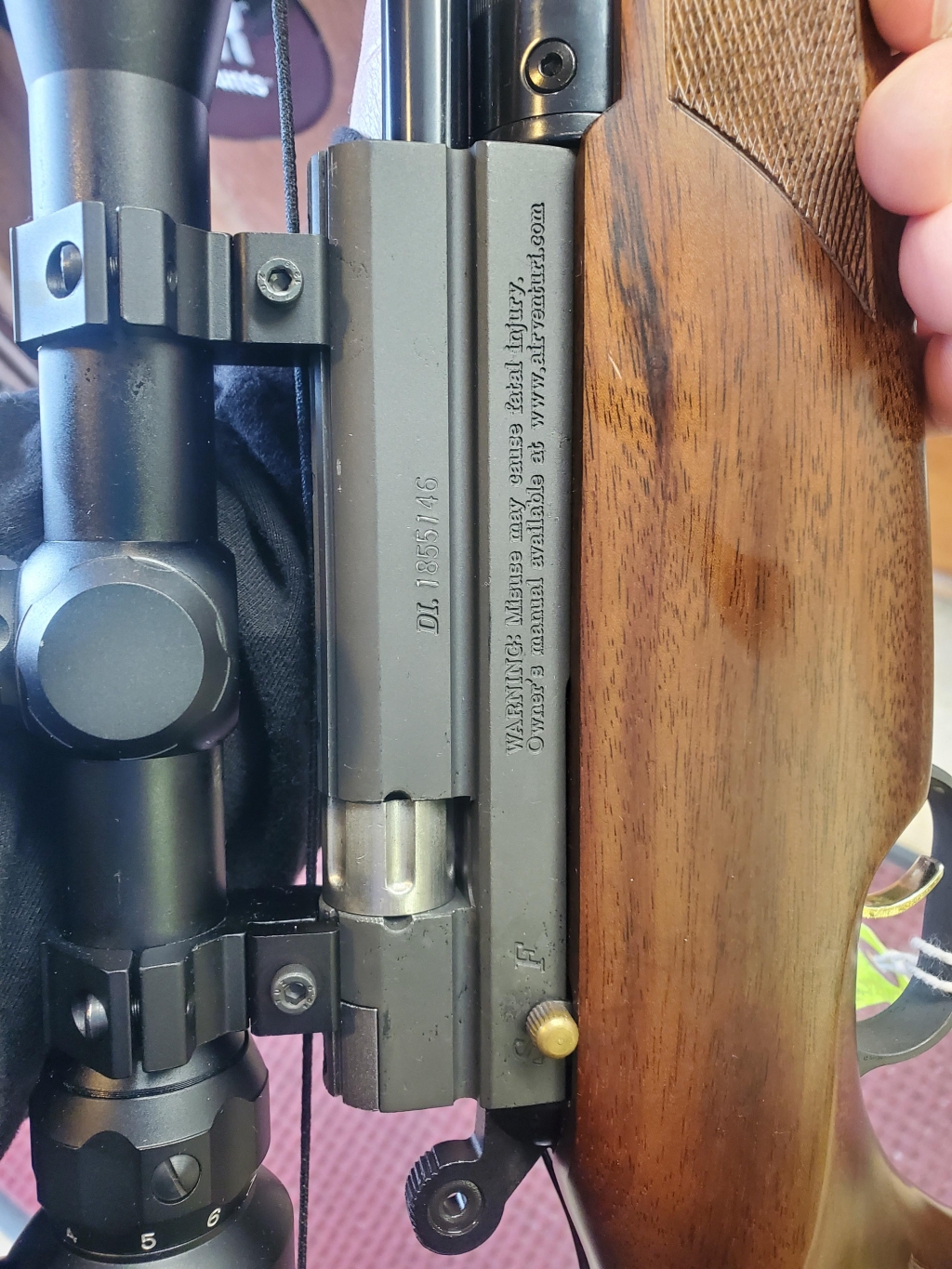

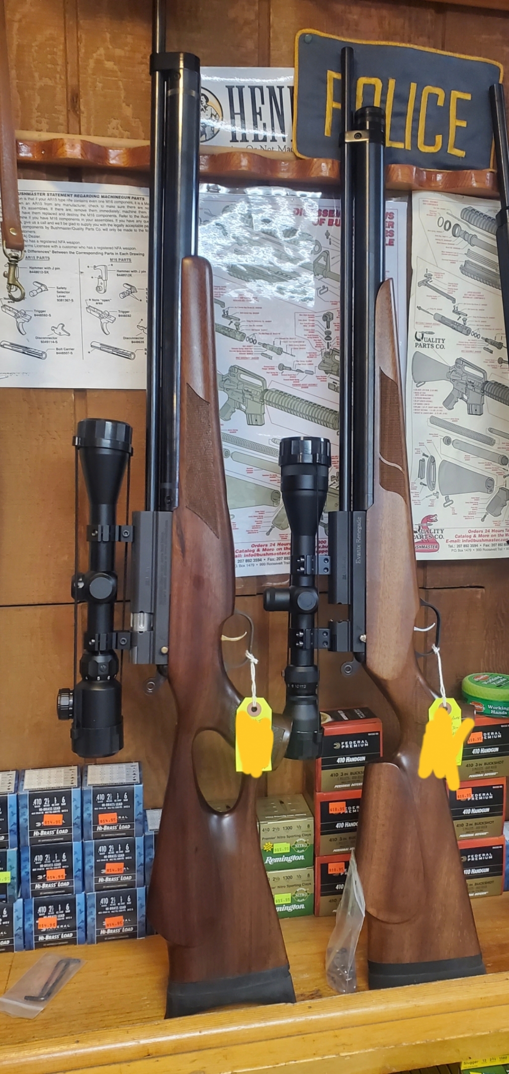

Hello can anyone tell me about these pcp air rifles?What are they worth how old they are? Thank you for any info Matt
Pretty nice, light, powerful hunter that's reasonably accurate if the cylinder indexing is adjusted properly . The pellet is blown from the cylinder rather than pushed like a Sumatra so might be pellet fussy. Mine needs the indexing fixed so isn't accurate. I made a hammer stop buffer out of a faucet seal so it can use lighter pellets or take the buffer out to run full power. To check the indexing , pull the trigger as you pull the hammer back all the way and see if the cylinder has any play while still holding the hammer back. Should be minimal. To check cylinder alignment , do the same but push a cleaning rod from the muzzle to feel for misalignment.

I believe they may be current production models. The old ones in the mid 90s early 2000s had barrels almost flush in relation to the end if the air tube. You should be able to use a shim such as cut to fit rubber or plastic washers even from an old throw away rubber slipper in varying thickness to lower the power and stabilize the shot string or add a regulator if you want to spend the money. Id say worth as is $350.00-$400.00 used. YO!
