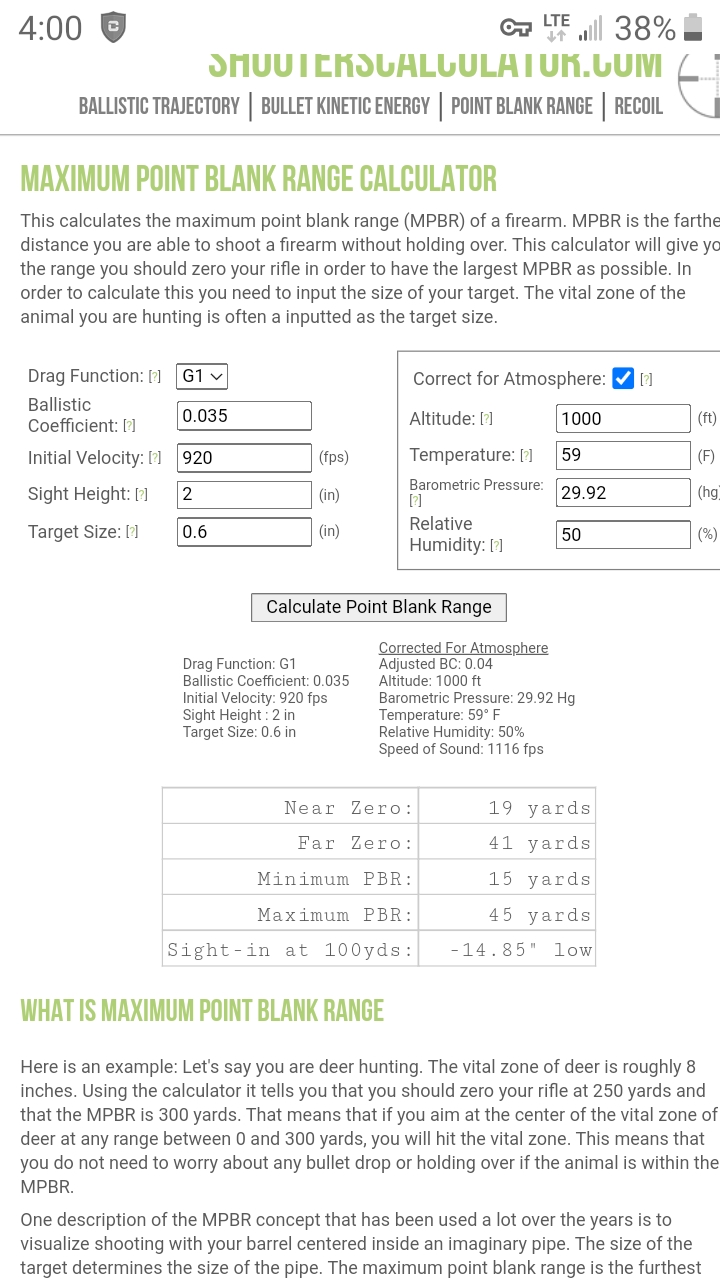

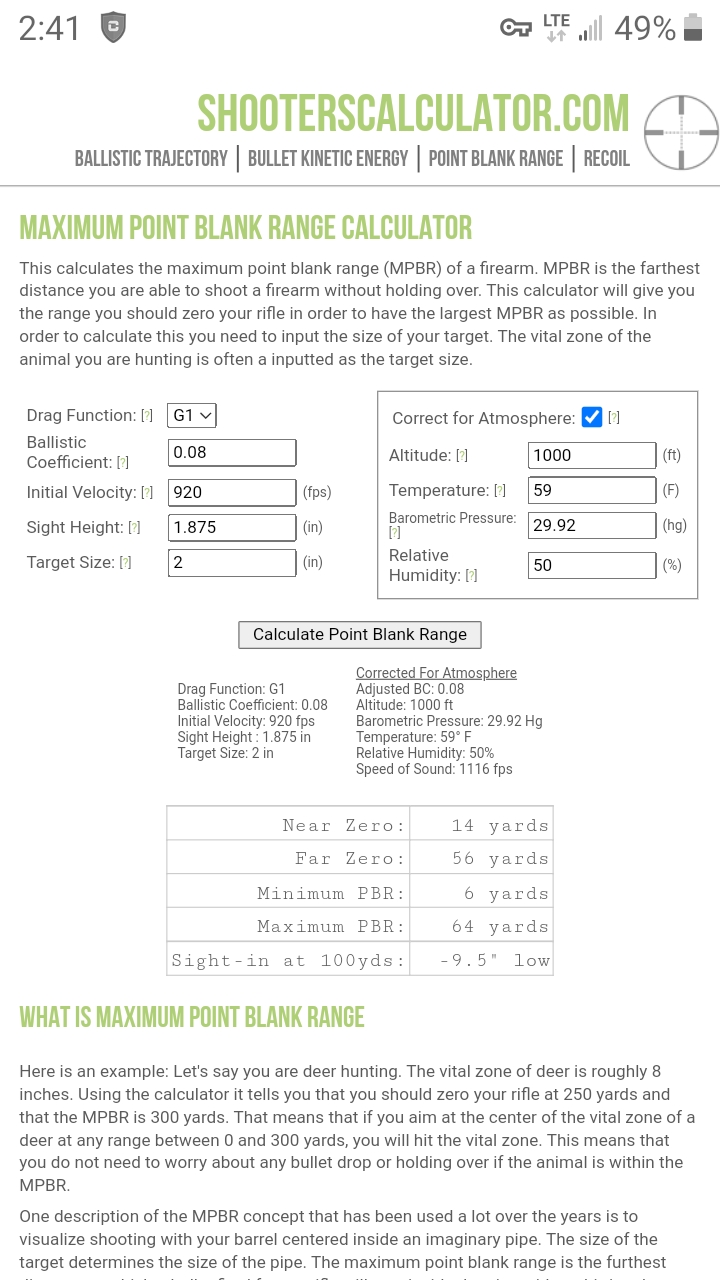

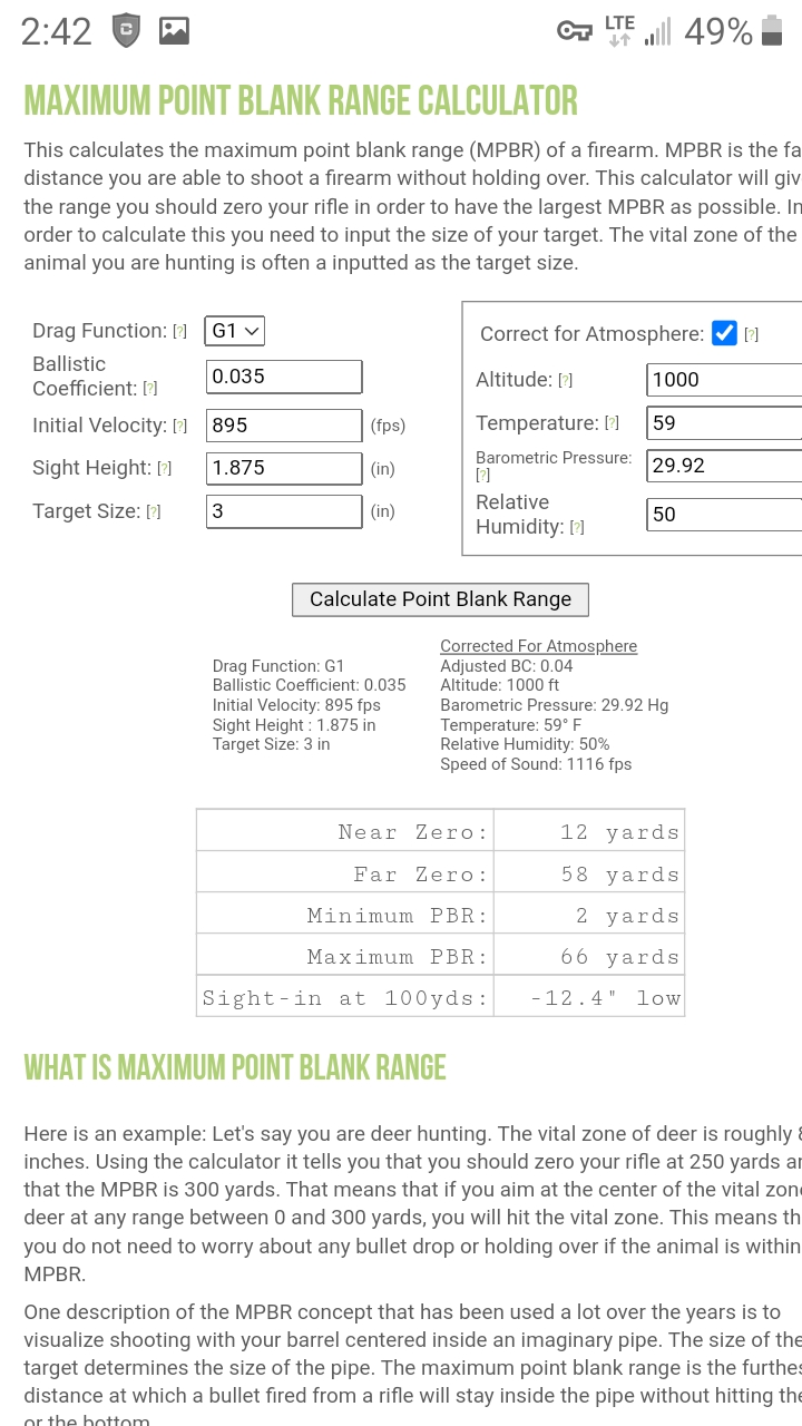

No, Not Pabst Blue Ribbon , it's Point blank range sight- in. Since most of my hunting is in the woods, a 75yd shot is sorta rare. 50yds or less is more likely. But this PBR sight -in method will make 100yd shots easier also. A PBR calculator will tell you the range you can shot without hold-over. You will need to choose a target size, ( kill zone). For squirrel, I use 2". This will keep the projectile to +1" high to 1" low for a range of yardage. In other words, if I shoot down a 2" pipe, how far will travel before it falls out of the pipe? My PBR allows me to head shoot a squirrel upto 63yds with no hold over. At 100yds I need 2.5 mils elevation. Use G1 for drag. Have fun with this, it surely makes things easier.
