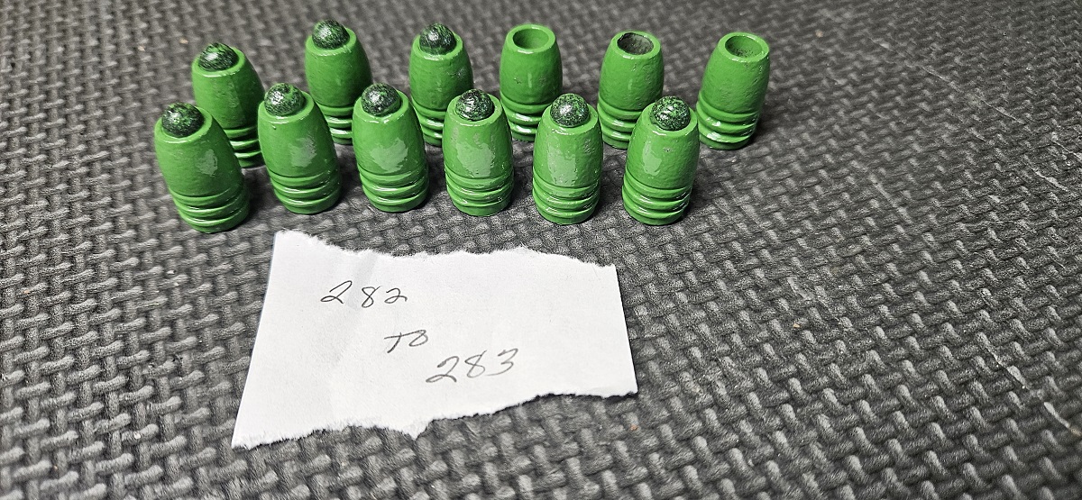

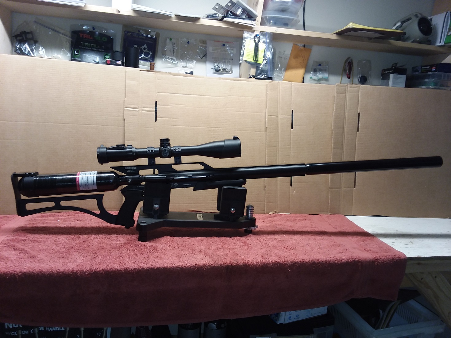

Here's some bullets I cast from a NOE 460-315 mold that I PC'd these have some blemishes on them but shoot fine in my modified Texan with a RL Shroud, I modified it by cutting 4 inches off the barrel and frame it will still push these 282gr slugs at 926fps.
