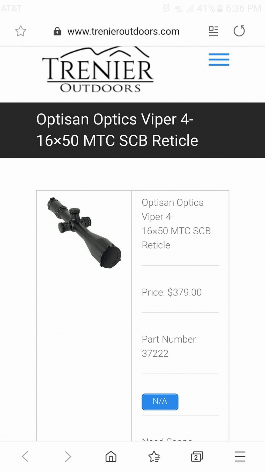

Scott, this one?
I'm going to be sooo screwed when my current HFT scope dies .... It is the obsolete OPTISAN VIPER 4-16x50
This scope IMO is still the best scope in use for HFT. & ranges excellent, great christmas tree SCB reticle & illumination too !
4 state championships, a nationals win & 2018's Gran prix all won using the optisan viper.
Seeing and looking threw a LOT of other scopes on competitors guns, I really have no friggen clue what i would choose in current optics to use at 16 x in hunter class ?
