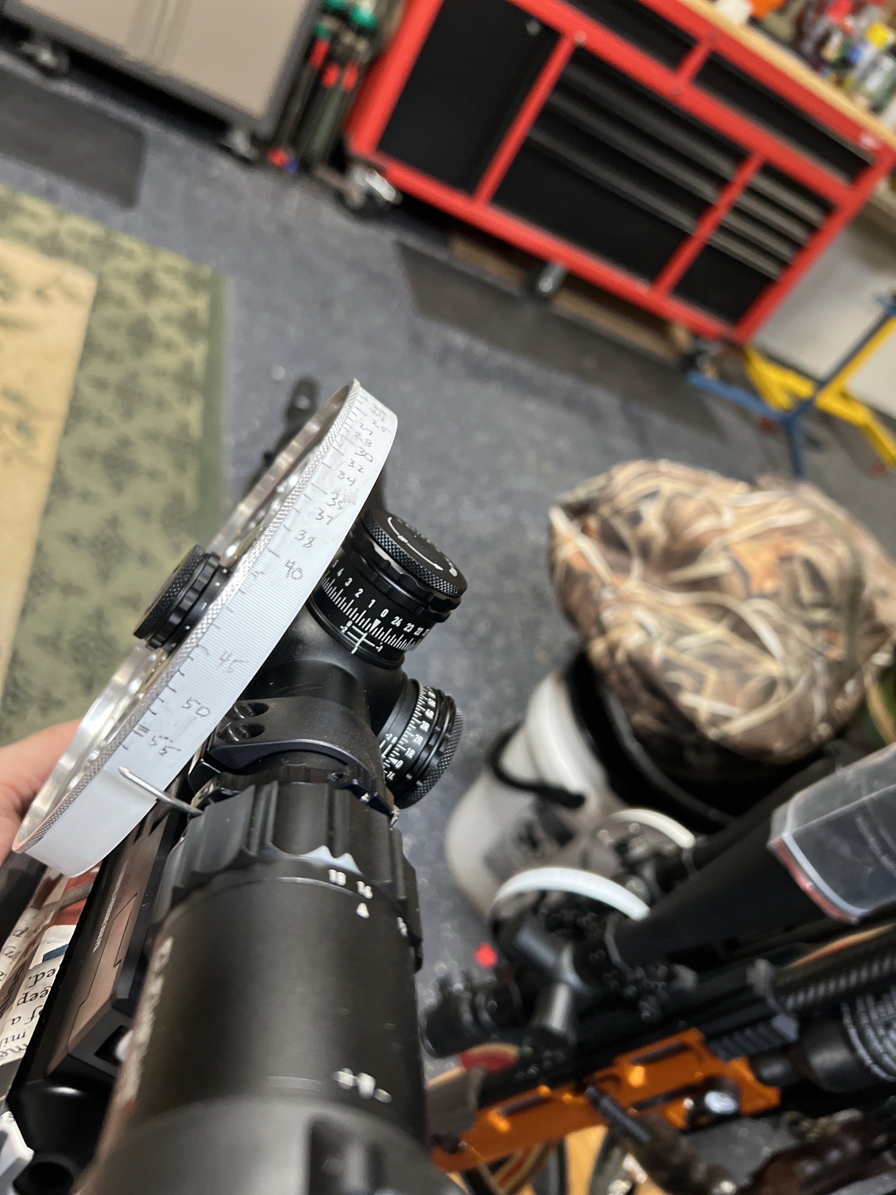

Money - it’s a waste to buy too much magnification when what you really need is a scope that ranges accurately and repeatedly; thus accurately determines your distance to your target which is critical.
Consider finding a scope with a parallax wheel which really spreads out the distance markers. See picture below which is an Element Titan 3-18 with 34mm scope tube body with a 6” parallax wheel.
It’s also important that the scope can precisely focus down to 10 yards.
Many scopes will separate the close distances nicely but suffer from a lack of adequate separation past 40 yards.
Learn to range (focus routine) exactly the same way every time at every target.. this routine should be exactly as when you’re doing the initial set up.
JD Garland or skope werks make excellent magnetic parallax wheels.
