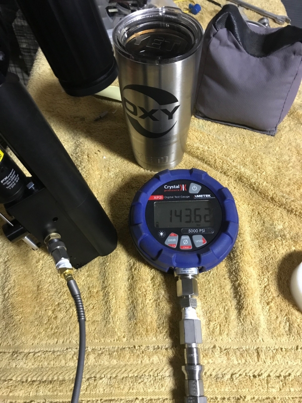

I hooked up to the receiver to determine my regulated pressure. Looks to be set at 143bar according to my Crystal test gauge which should be on the money. Thanks for the links of the videos Chuck..
Jimmy
Hey Jimmy, Man that is one beautiful gauge! How much does something like that cost? If I had known about something like that I would have bought one to screw into my Wildcat bleeder hole, instead of trying to use those little tiny gauges... Which I was never sure 100% if they were giving me a correct reading or not. Which is why I went ahead and order one of the reg testers. Well I am totally digging that tester! I'm going to go on my computer right now and look that thing up. Thank you so very much Jimmy. All the best, Chuck
