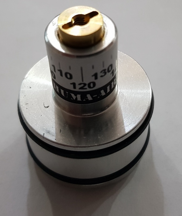

But after several thousand rounds the new FX regulator developed the same fluctuations as the original one had done! I felt like screaming when I saw the proof of this…but instead, I sent an email to Huma in the Netherlands asking if they could make a regulator for my Wildcat – which is exactly the same as the one in my Streamline, just the plenum spacers are different sizes. This developed into a discourse with Huub Andriessen at Huma who graciously agreed to develop a regulator for my Wildcat, on the condition that I take all the measurements he required.
He sent me a parts drawing to which I took the appropriate measurements with my digital calipers and filled in the blanks for him. He then created not one but two regulators for me. The first prototype was about a thousandth less than ideal for me to use the regular standard size FX o-rings, so he made me a second one slightly larger to accommodate my wish to use the regular size FX reg. o-rings. This is the very same Wildcat regulator now for sale on his website and at AOA.
While I was waiting for Huub to make me a regulator for my Wildcat, I also purchased a Lancet MK8 regulator from Robert Lane in the U.K. so I could try out both of them and see which one would retain its consistency the best over time. Well for me it was the Huma Regulator hands down! I have a Huma reg in my Wildcat and a Huma reg in my Streamline, and even after thousands and thousands of shots, both Huma regulators function with flawless consistency, very low extreme spread, and a standard deviation of about 2 ft/s. As an added bonus the Huma reg gives my Streamline 51 shots - instead of the 30 shots I got from the original FX reg; and the Huma reg gives my Wildcat 64 shots instead of the 40 shots I got from the original FX regulator.
