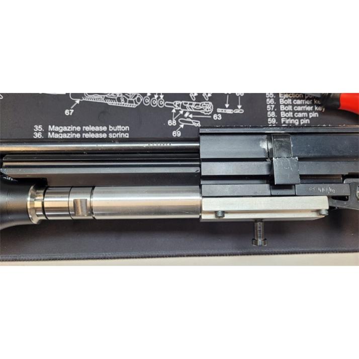

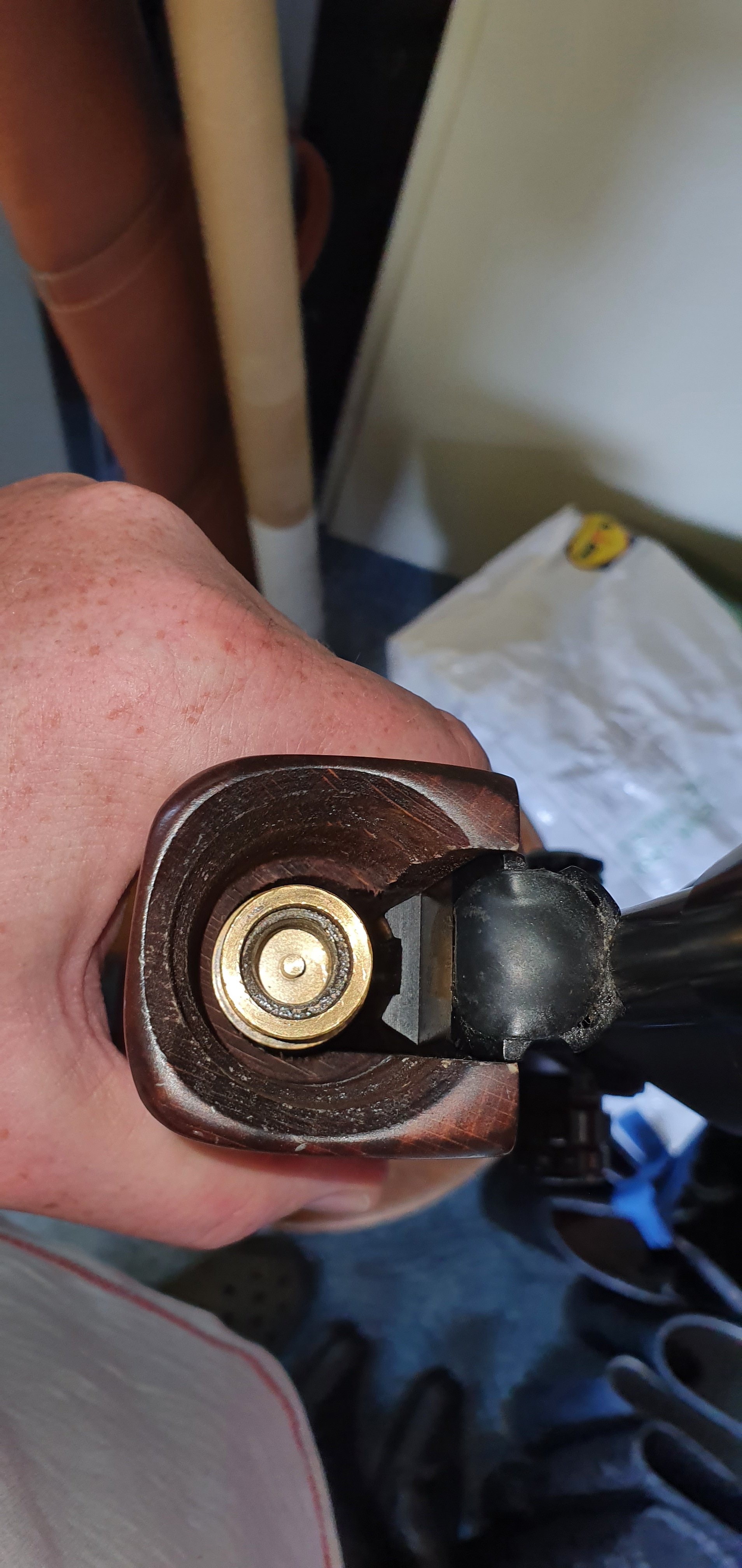

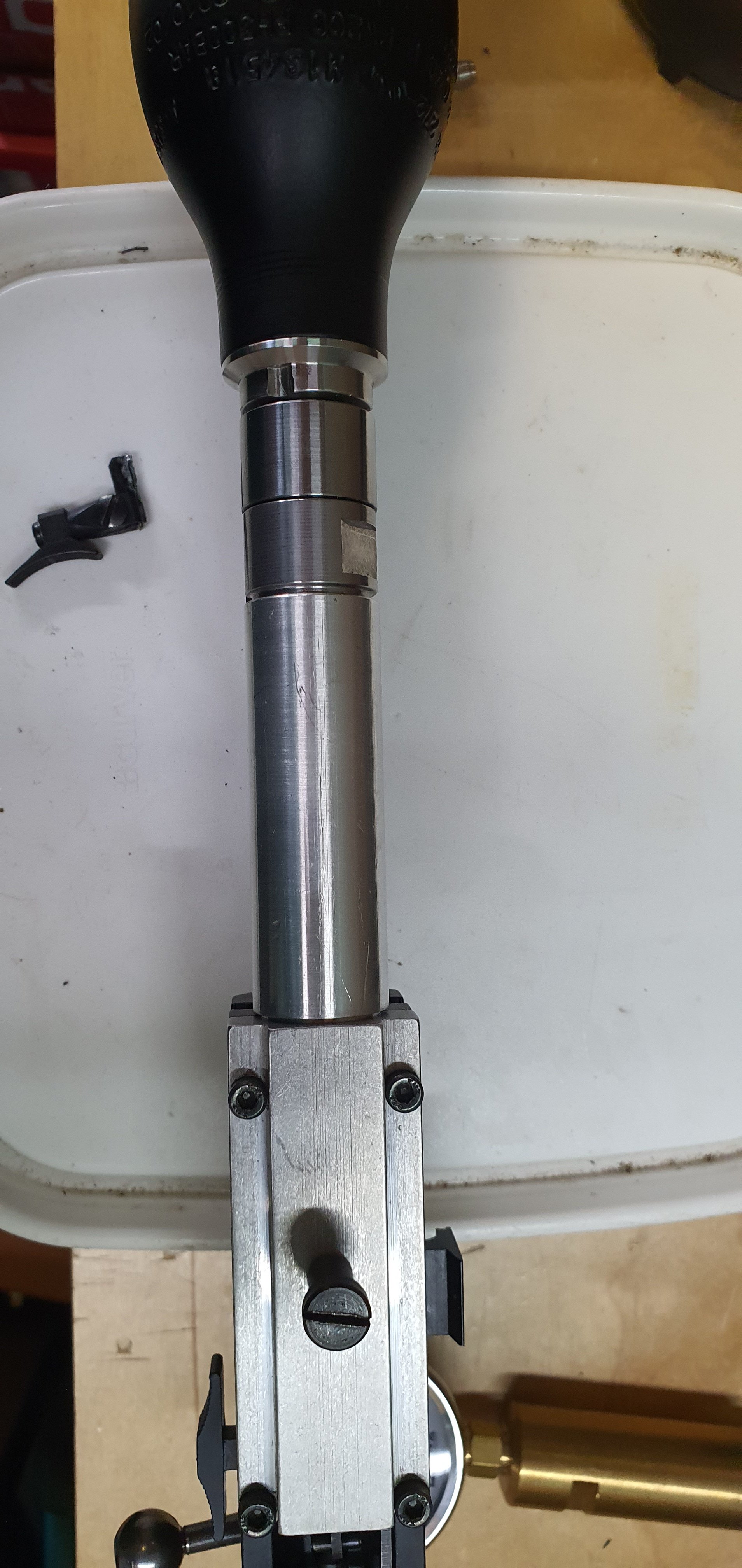

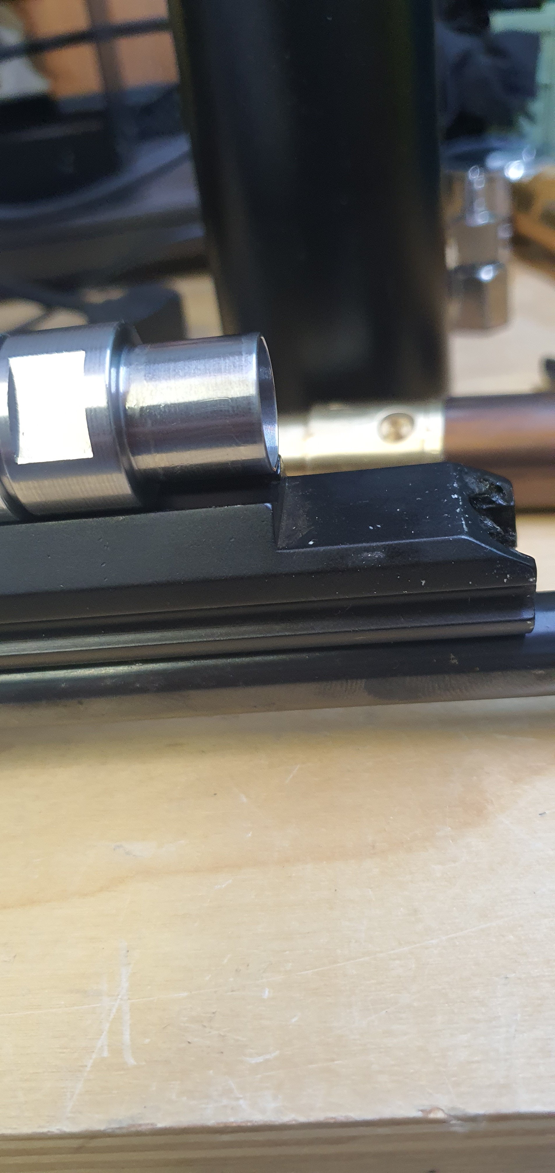

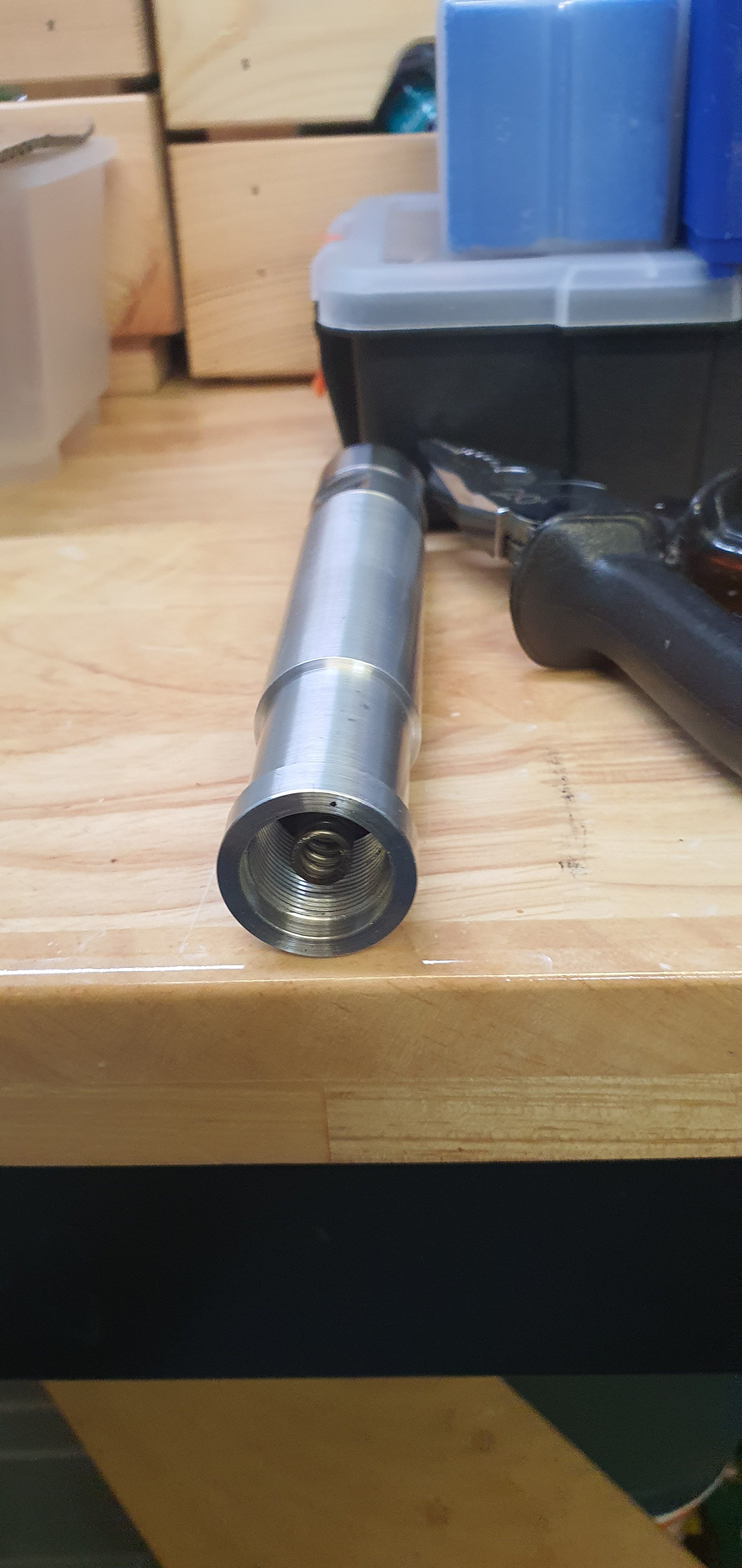

I asked if Huma had an regulator for the BSA Super10, they did not butt where interested in making one.

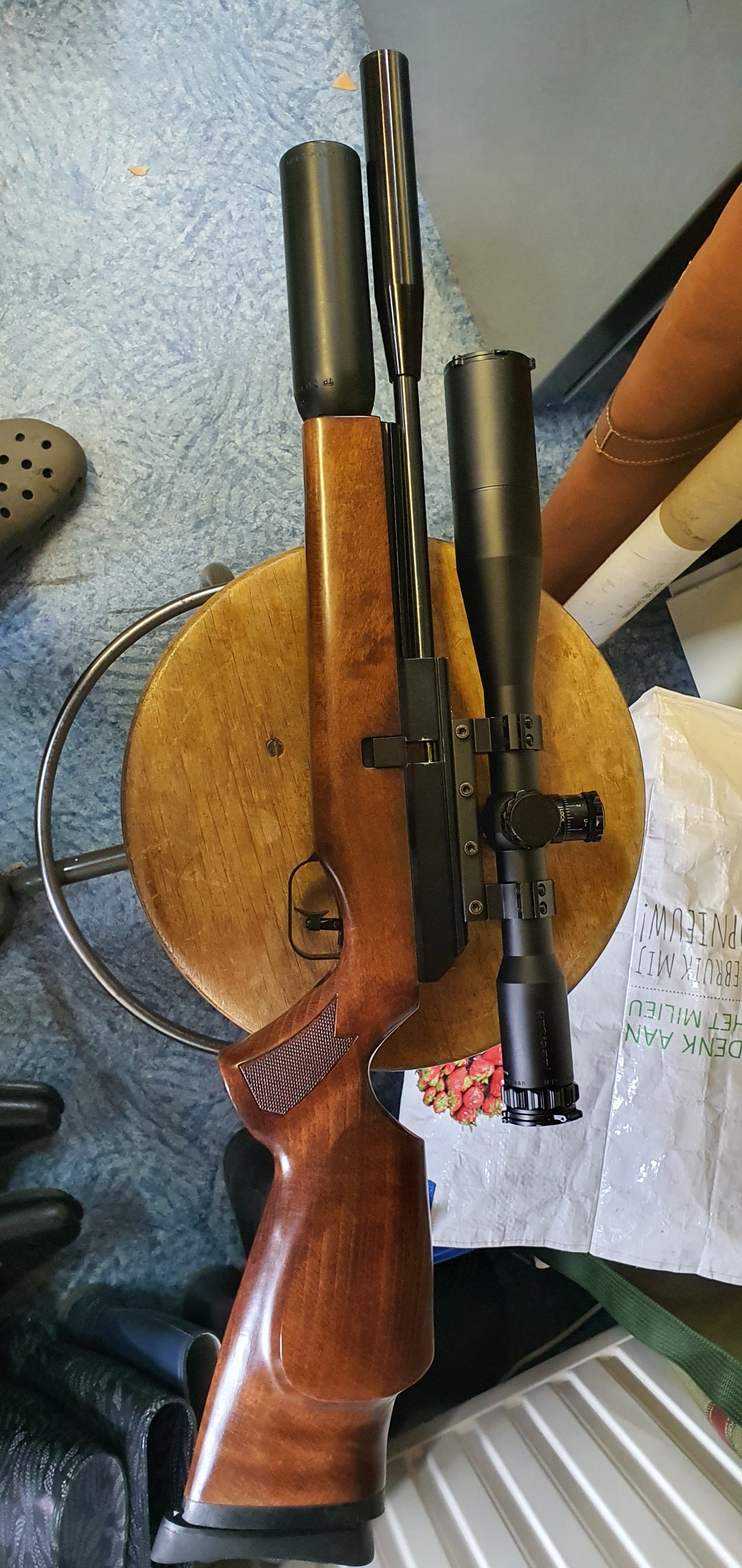

They did need a rifle to make one so I send mine and a regulator prototype was made.
It words like a charm and very accurate, has a bigger plenum than original. So greater power would be possible.
If it will go in production depends om the demand so if you want one give them an message

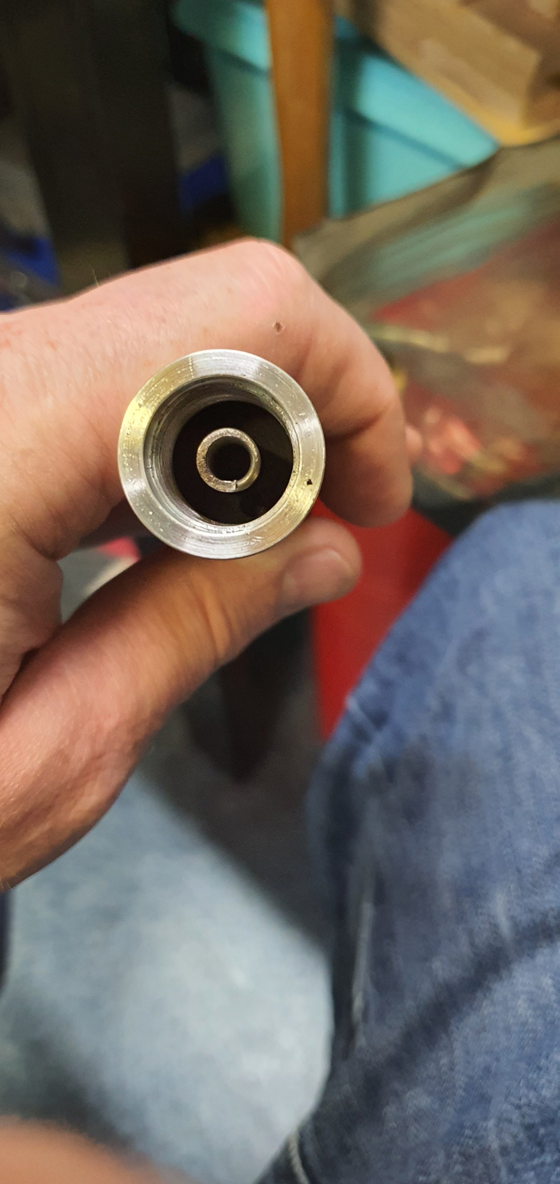

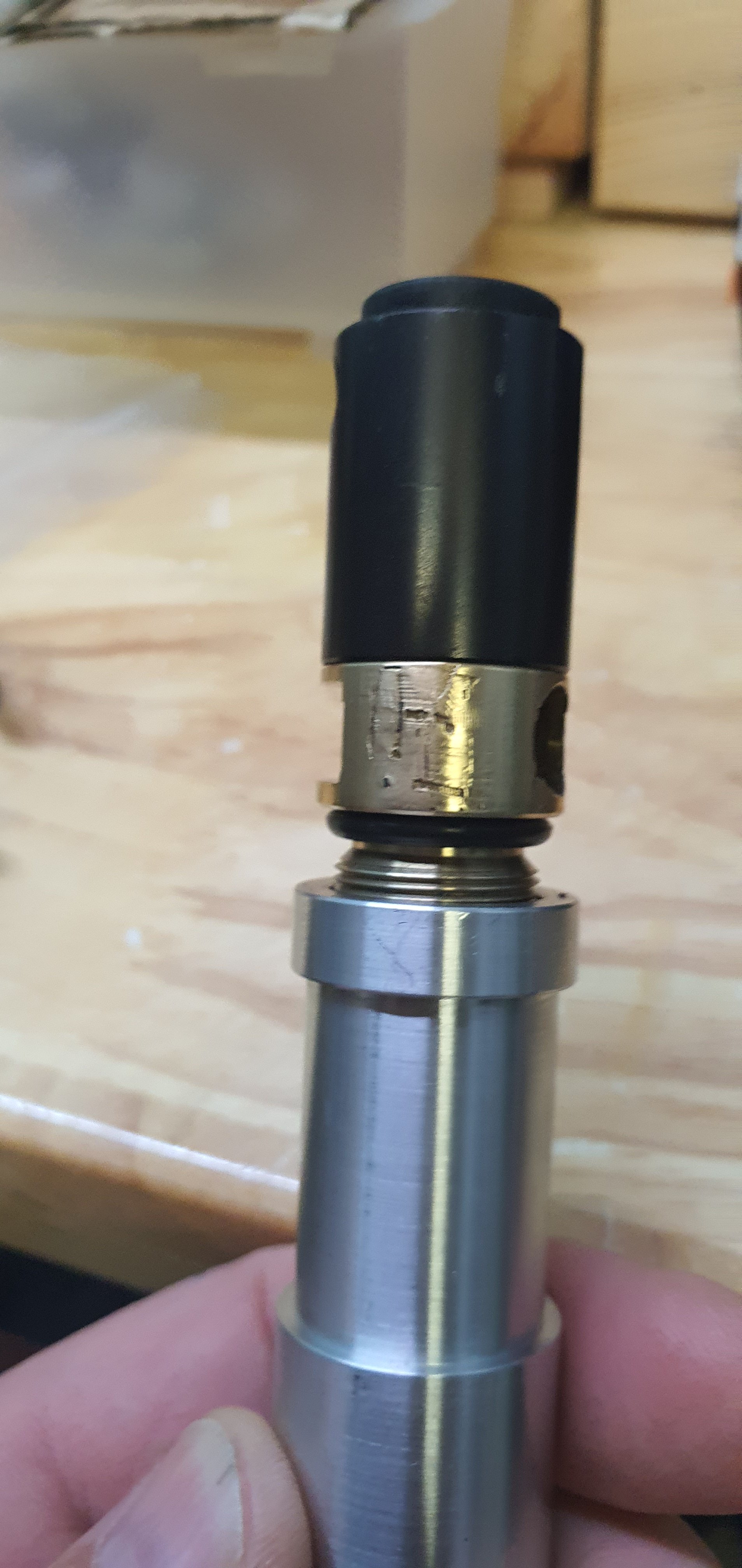

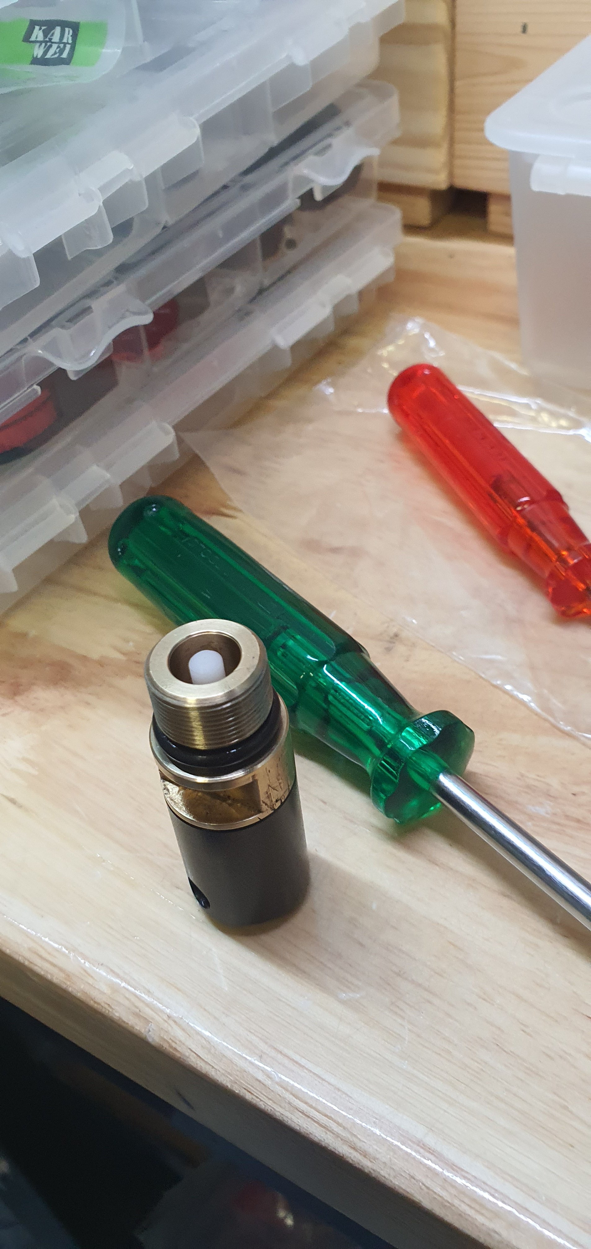

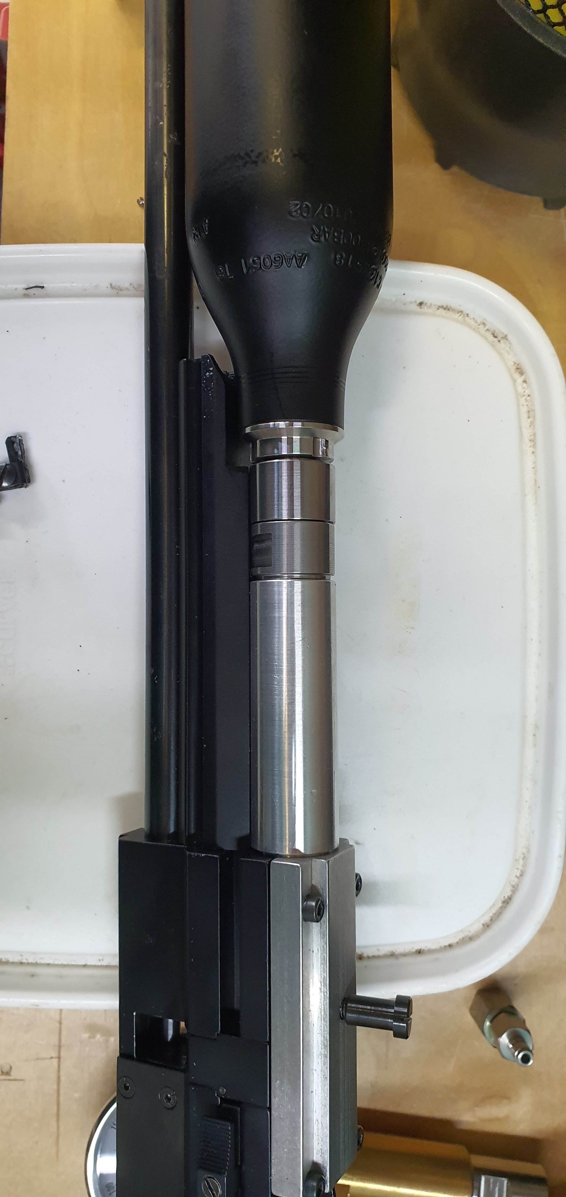

Very easy the used a RAW/theoben reg as basis and it went from there. So unscrew the knock open valve on the old regulator and put on the new regulator tube. You can adjust the spring pressure on the valve and the pin that opens the bottle.
They put a sleeve arround the bottle adaptor so maybe they have a quickfill in the future
