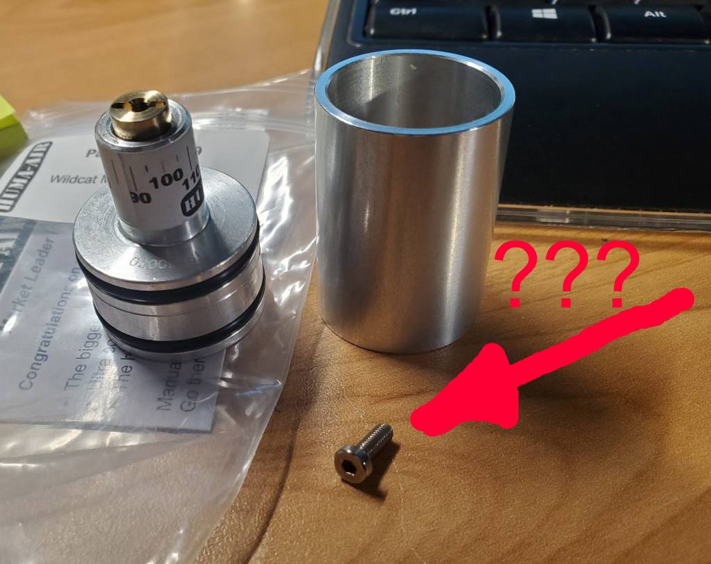

I've exhausted on-line sources to find out what this small screw (see photo) is for. It came with my Huma-Air Part #FXA01-19 Wildcat MKII AMP Version replacement regulator.
The screw will thread into the hole on either side of the regulator. However, I can't find any source that tells me why I need this screw. It is not in any install video and it is not in any written instructions.
Does anyone know what this screw is for?

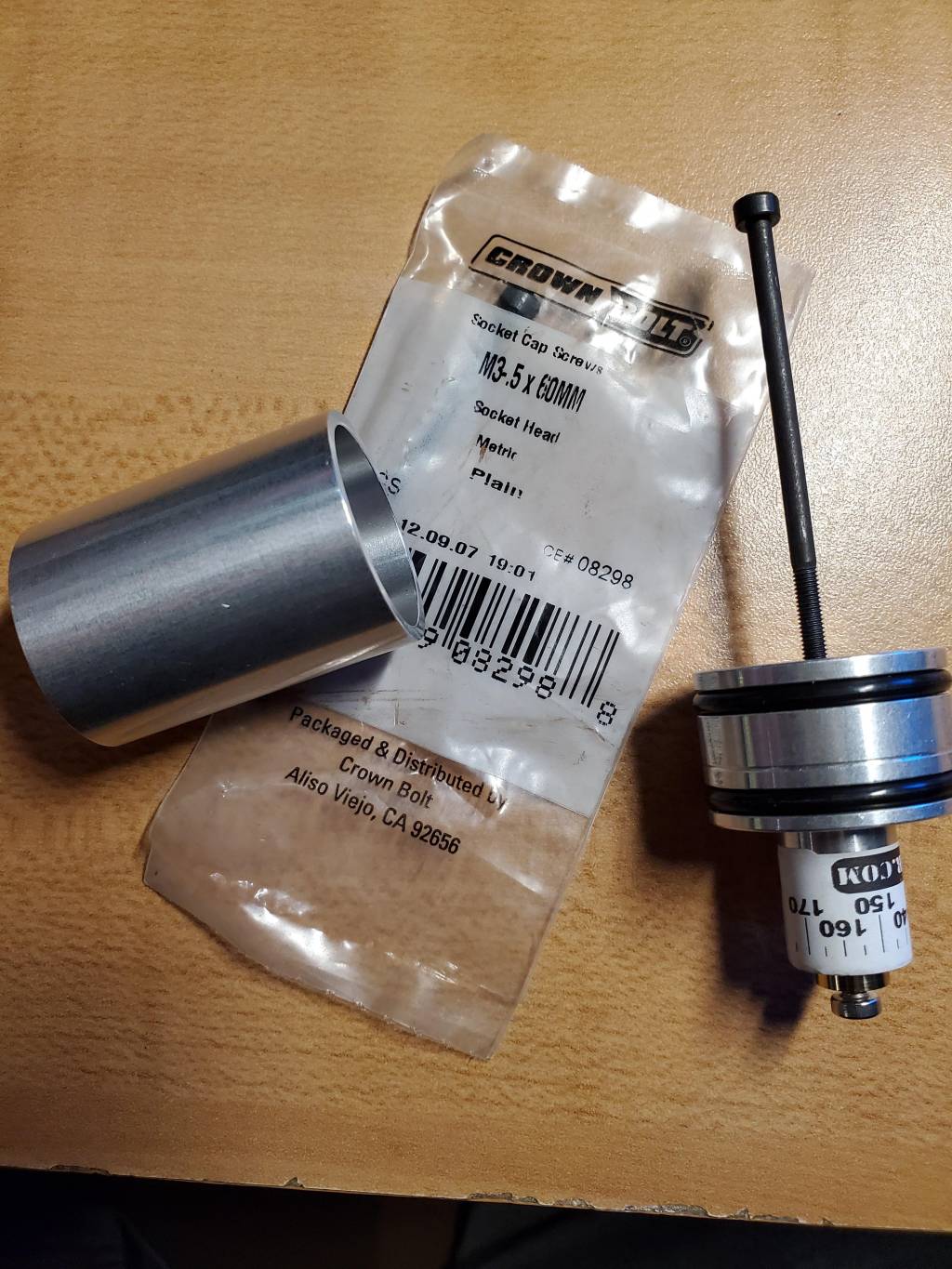

Went to Home Depot and bought a package of two M3-.5x60mm bolts for $0.70. Now, when I want to pull the reg (if I ever get it installed) I just need to finger thread the bolt on the back of reg and pull. It is long enough that you don't have to fiddle with fishing line and you don't need to leave anything inside the plenum.
