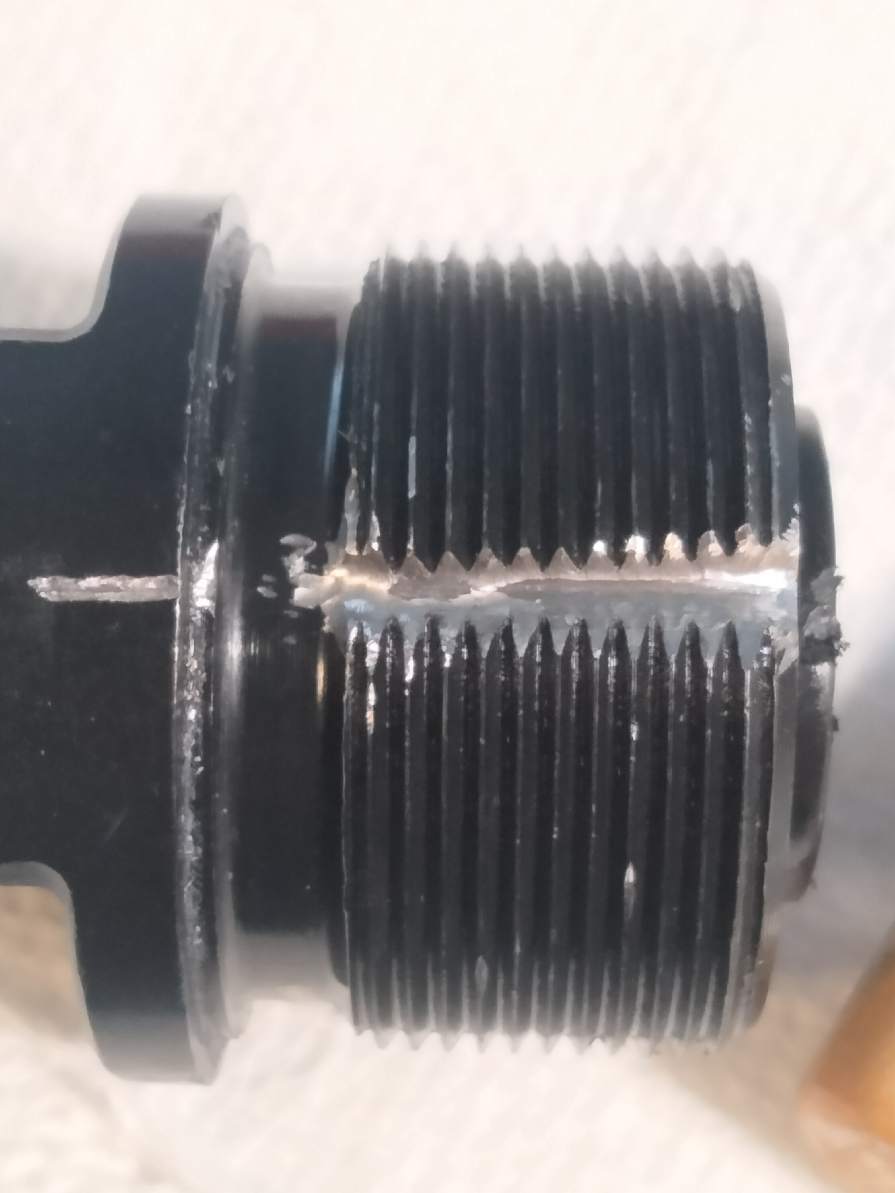

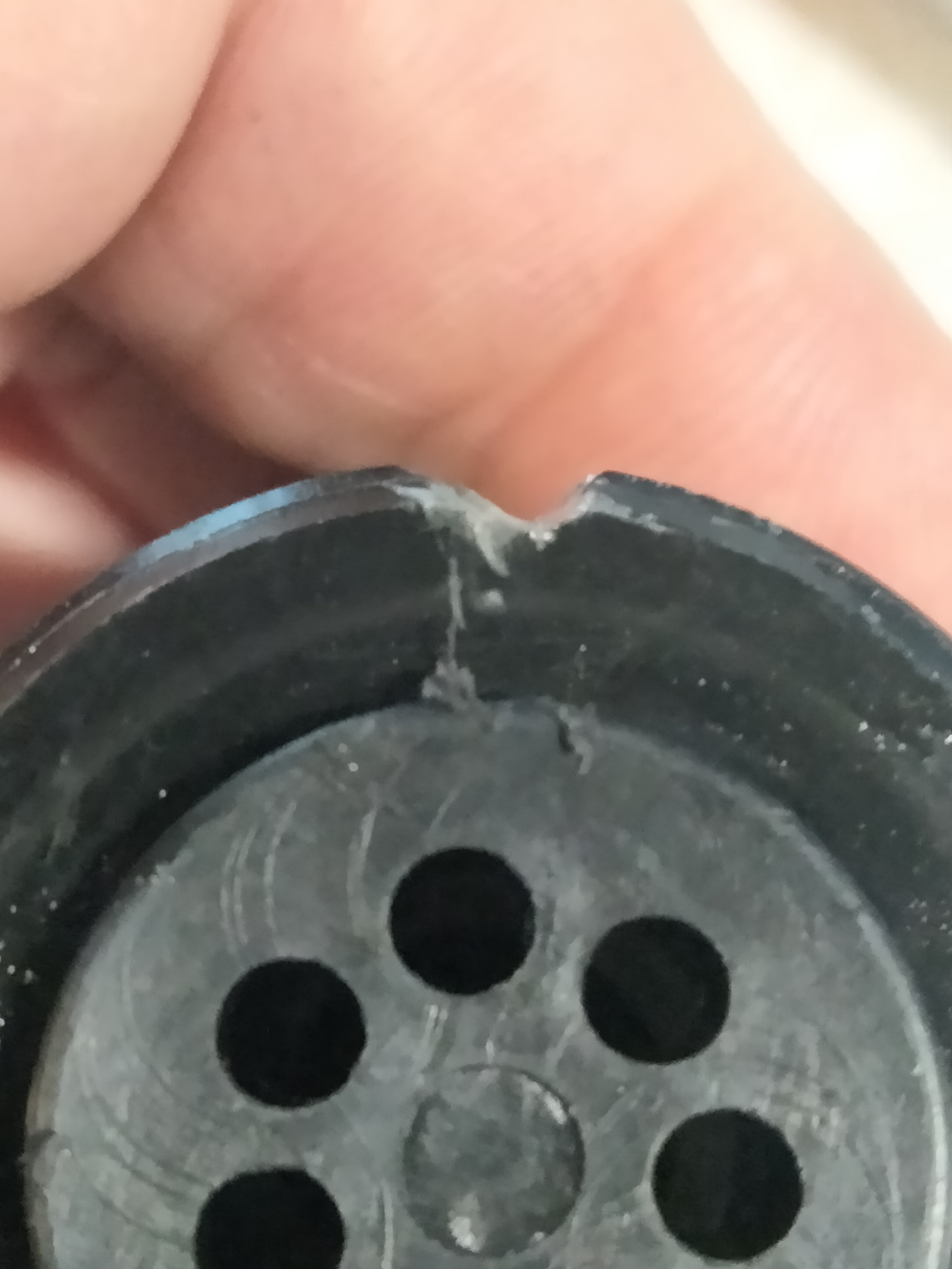

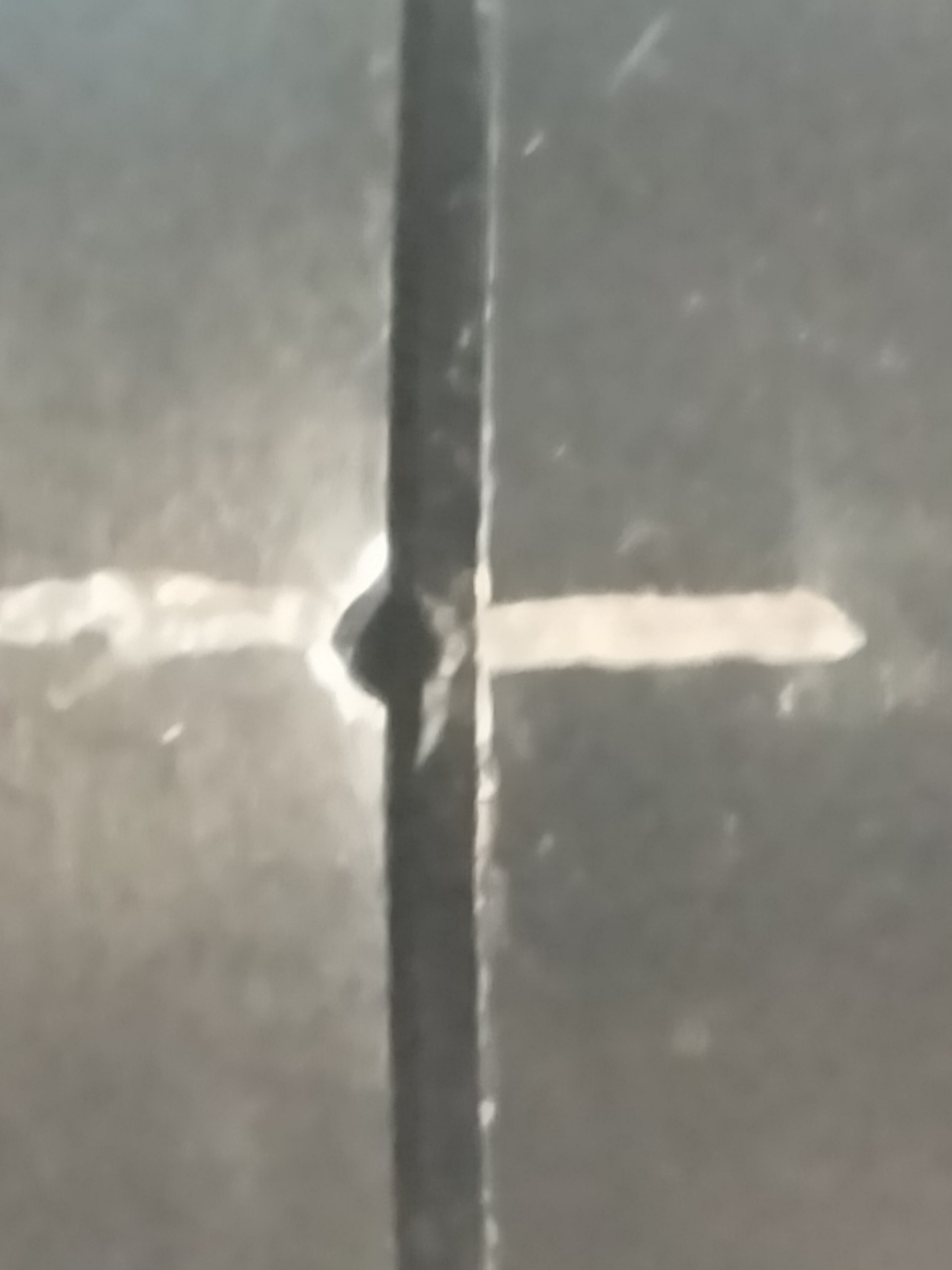

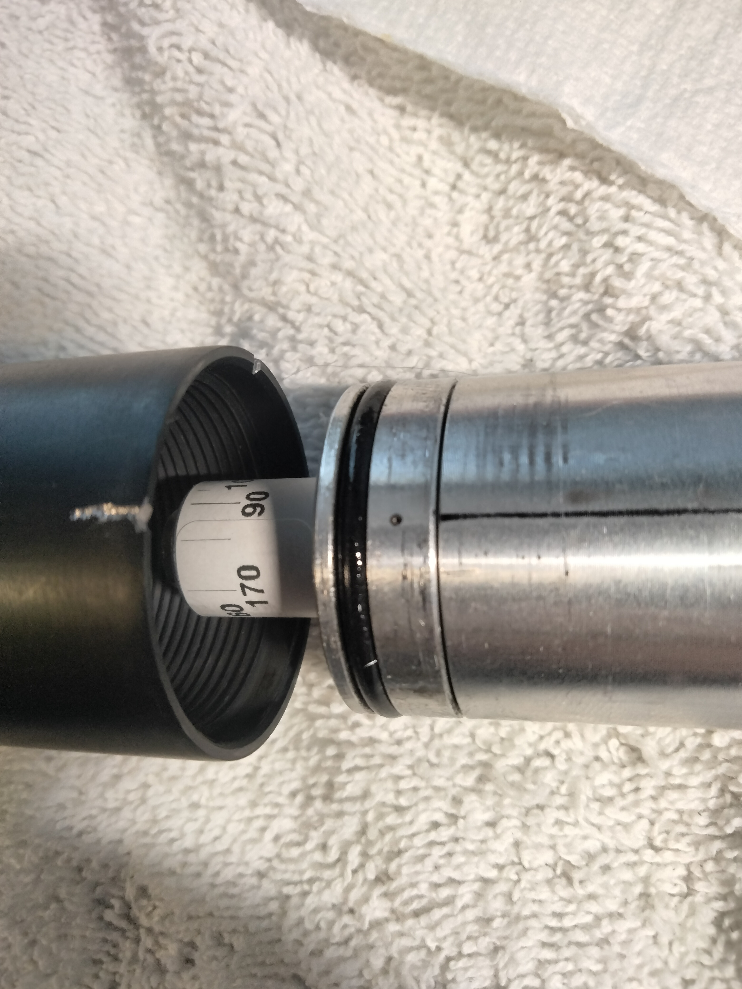

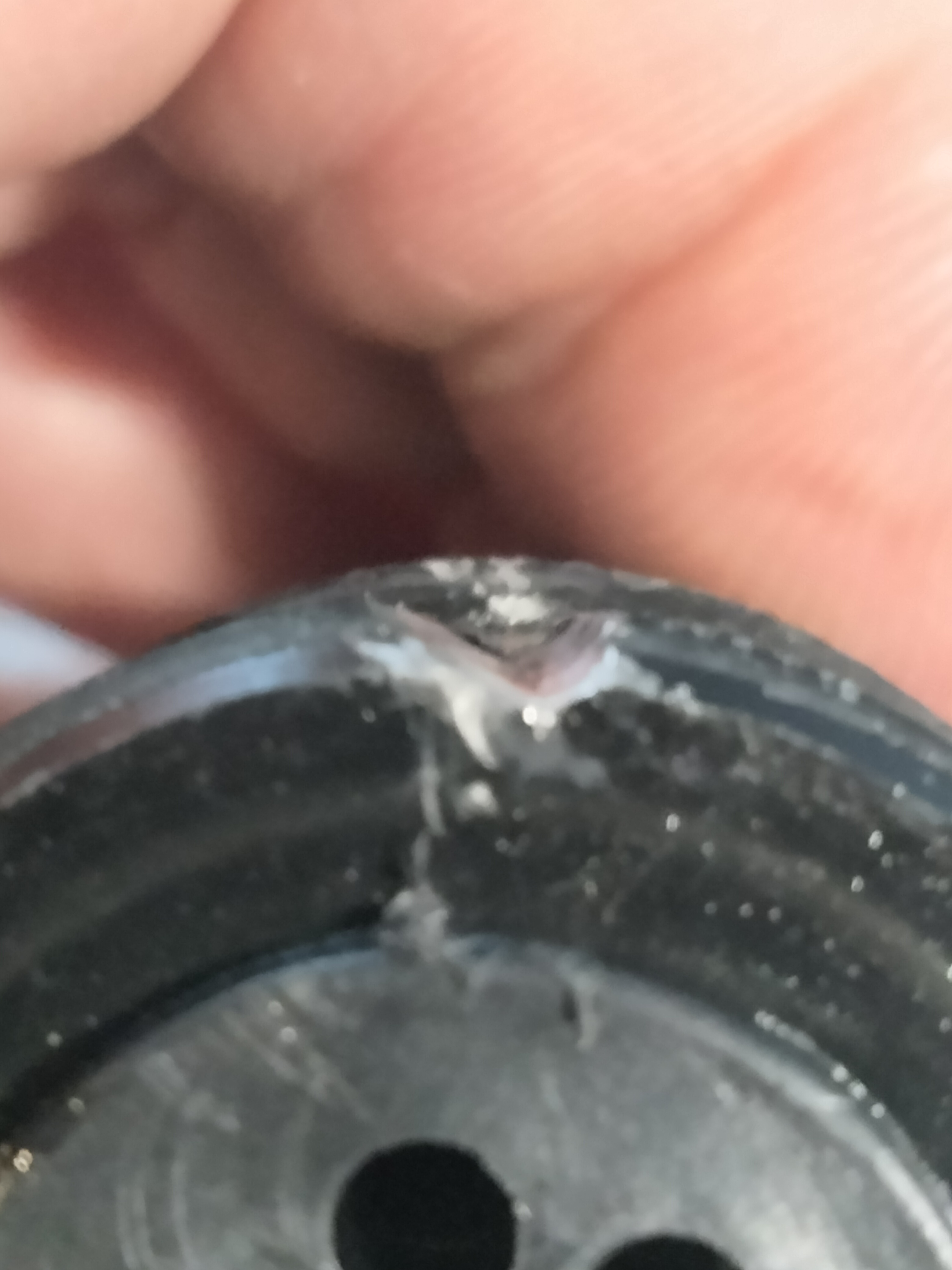

Hey everyone, needing some opinions on this. Installed a Huma regulator in my Hatsan Vectis .25. I'm pretty sure it's installed correctly-see pics. I installed it so the vent hole will be facing up when inserted back into the air tue. I've pulled it in/out seveal times playing with the pressure and wondering if it's actually venting. It's currently set at 145bar. I think so, but don't hear or feel anything coming out like I do my Huben. So do regulators take a while to vent through all those threads in a pressure tube? If so, maybe I'm okay. Prior to this I was getting a string that made me think it was never consistent, so I took another look at the groove in my threaded receiver (?) and left one turn out when tightening it up. This is my current shot string of 30 shots. I don't know if this is really good or not when looking at the shot string. Please look at these and provide your inputs. Thanks

The notch you’ve made in the threads looks to be more than adequate, seeing as how it goes below the root of the threads.
Don’t worry about the absence of air exiting the vent hole. There should be no perceptible amount coming from it. The vent is there to allow the escape of an infinitesimal amount that diffuses through the O-rings.
Well that's what I thought. So I'm thinking my shot string is pretty much okay then.
If you’re wondering if you have it in correctly, always point the adjustment end of the regulator towards the fill port of the gun. The high pressure unregulated air is always going to be uphill of that Huma adjustment screw
