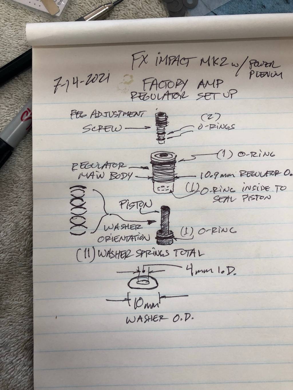

I just rebuilt the regulator on my newer Mark II and noticed on some of the older impacts the regulator sealing o- ring inside of the body of the action is a smaller diameter. So I am assuming it was machined different in the body on earlier models. The newer Mark II's take the larger o-ring. Also the regulator piston is shorter on some the older impacts. Having said this, I'm assuming that's why some of the Huma regulators for the older gen1 and gen2. Impacts won't work in the newer Impacts.

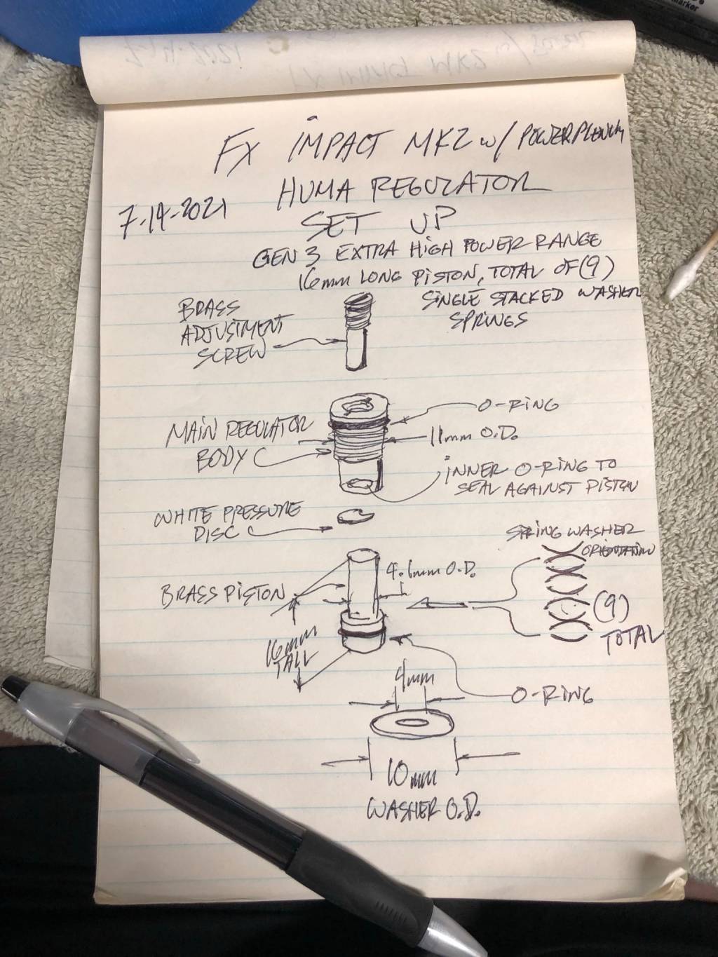

Best thing to do if you are unsure of your version, is to pull the factory reg out.measure th diameter of the piston body, along with the washer spring outside diameter.
just did an install on a MK2 bought in April of the this year, and pulled measurements for my own future knowledge-
Maybe his will assist you.

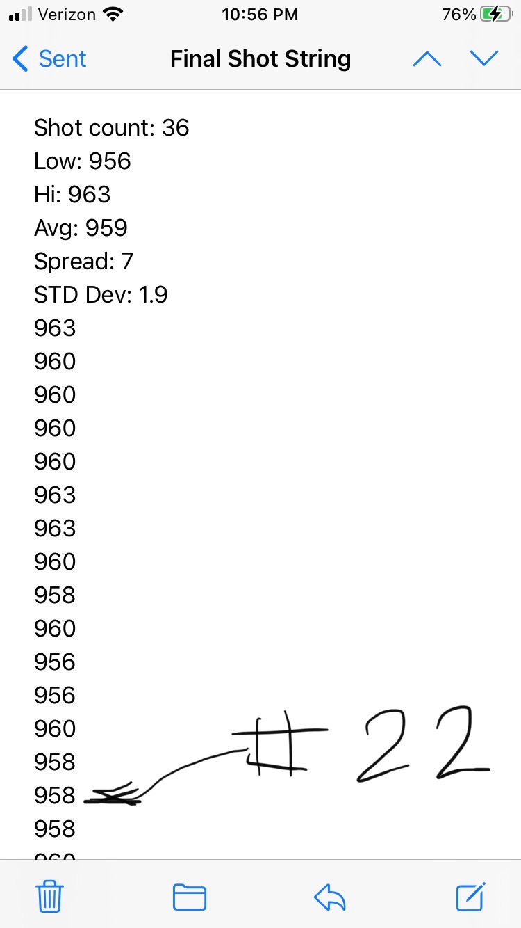

How were the results after your install of the Huma? Did you have problems before or what was your reasonings to replace the AMP?
The results were awesome. Here’s the shot string of 36 shots that I emailed my friend on how his impact was doing after I did the install and tweaked on the gun. I sent him this email thru the FX Chronograph app.
These are with the 30 cal, 44.5 FX Hybrid slugs-
