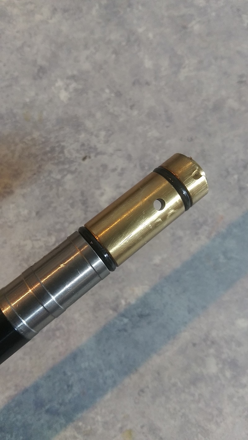

what i would do: crank the reg close to 100 bar and then get a brass barrel attachent with a transfer hole for sub 12 air riffles. be aware that if you dont have enough
hammer force to open the valve, then valve lock occurs and you get inconsinstencies
