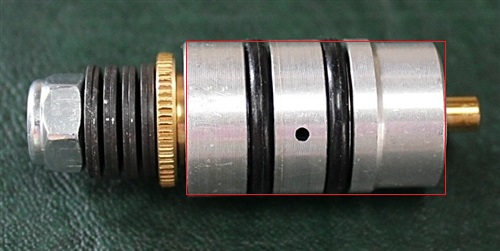

I've just bought a 2nd hand sub 12fpe FX Royal 400 .177 calibre here in the UK which is the later smooth twist barrel and 3 setting power adjuster model but it doesn't have a regulator fitted (it's also had the factory moderator/shroud removed and replaced with a weihrauch moderator). It's shooting spot on and I'm very happy with the accuracy but I'm thinking of fitting a Huma reg so is it just a case of drilling the 2mm pre-drilled hole by the air gauge all the way through, removing the internal plastic sleeve and then fitting the reg and liner or is there something else that needs doing as well?

My gun had a 2mm pilot hole started....found under the pressure gauge (manometer).
I removed the plastic spacer and packed paper towels in the air chamber to prevent aluminum drilling chips from getting deep into the working of the gun....the 2mm drill will follow the pilot hole but I suggest a drill press...
Things to watch for; go very slow and lubricate the drill bit...then be extremely careful inside of that air chamber...no scratching inside or burrs on the new hole...1500 grit paper very lightly near the new hole...remember that at least one oring needs to slide over and past that new exhaust hole and seal the regulated side from the exhaust hole and another oring seals things so the bottle air goes through the regulator and does not leak out the exhaust hole...keep it perfectly smooth so the orings do their job...
