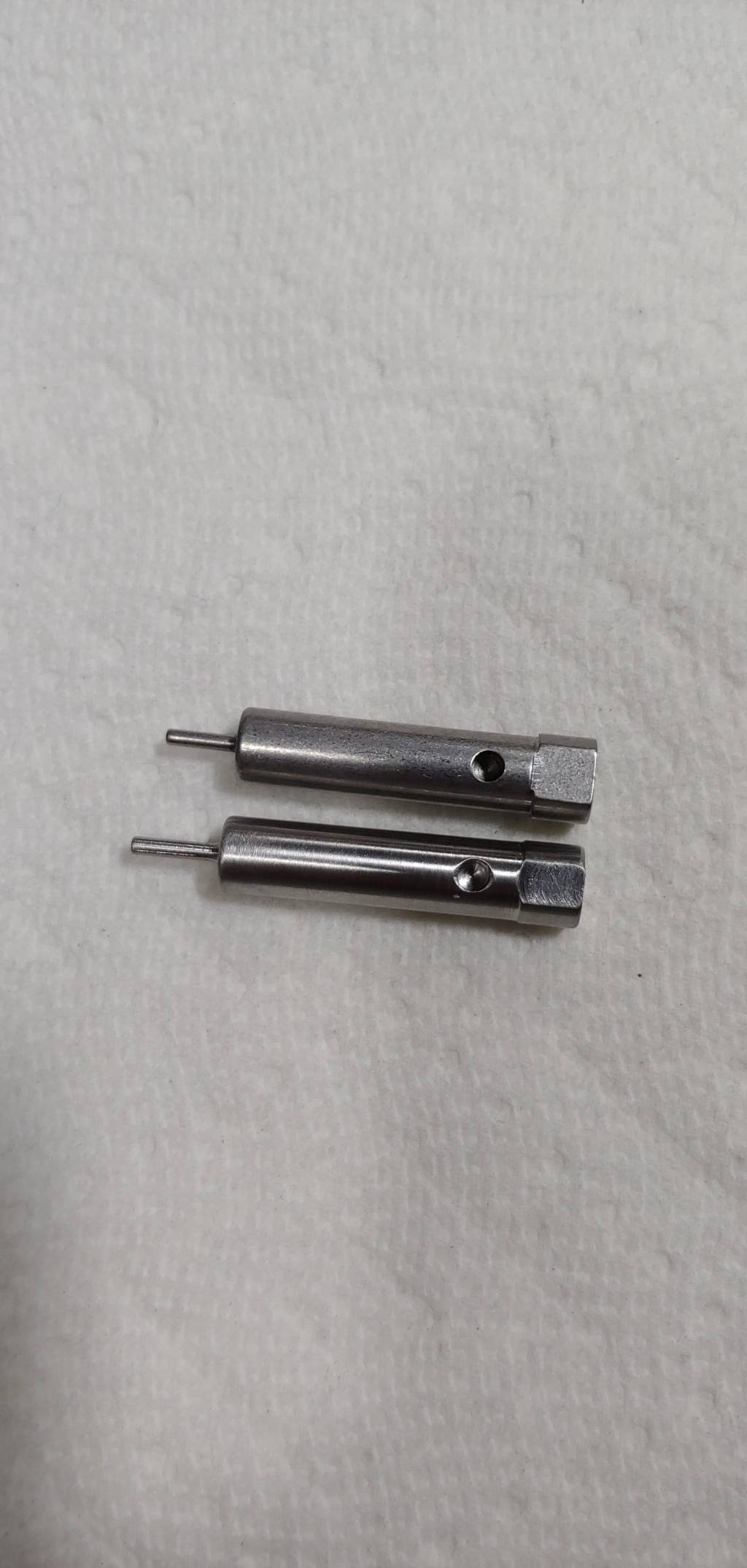

I haven't had a feeding problem with my Huma probe but I did find that it did not push the slug I was using far enough into the barrel to clear the opening of the transfer port. I Ended up machining one that was a little longer . Now the slug sits just past flush of the end of the transfer port opening. Huma-top one.
