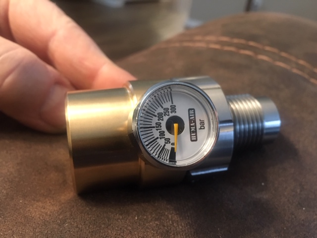

I recently purchased a Huma inline regulator and want to do the spring washer adjustment to raise the regulated pressure.
Has anyone done the changeover ?
The Huma instructions say to remove the spring clip (snap ring) and then from the opposite side screw a 3mm screw into the threaded hole and extract the piston. Then you arrange the spring washers per the instructions from Huma.

I need the maximum setting of 250 BAR so I stacked the washers for the “high” setting as shown in the manual.
With the external dial adjustment set to max, and locked with the setscrew, I only get 230 BAR. I have a note off to Huma-air with no response yet. Anyone been able to use this regulator at 250 BAR max?

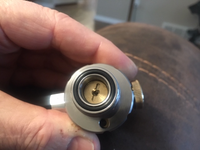

Yes I already moved the external adjustment to max and could only get 230 BAR. According to Huma the max pressure for the range can be increased with the slotted screw at the inlet.
I heard back from Huma. The proper way to adjust maximum pressure (within the range established with stacking washers) is with the slotted screw at the center of the inlet. Facing the inlet, clockwise = decrease pressure. Once the range is selected with the washers, and maximum pressure of the range set with the inlet screw, then you can use the external adjuster to fine tune within this range. I also determined its best to lock the external adjustment with the periphery set screw to keep pressure stabilized.

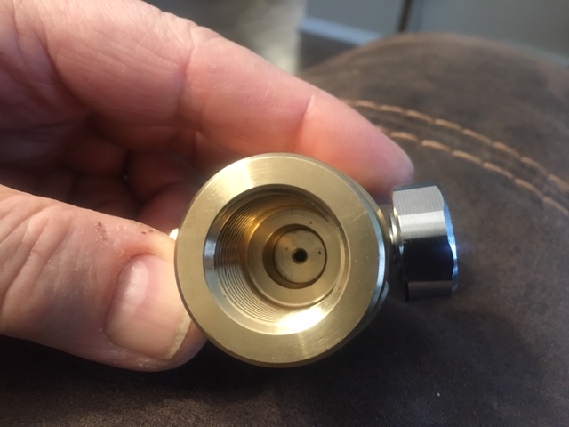

I recently also bought this regulator, however, one thing doesnt make sense for me. Initally when I connected it to my 300 bar scuba tank, I opened the main valve of the scuba tank and the regulator red 0, even though the manometer of my scuba tank red like 260 bar or so. Then I loosened the big bronze screw you show here, turning it counter clockwise. Now I get outgoing pressure. However, in the manual, it says the regulator comes with the standard spring stack setting(max 200 bar). However, if I turn the big bronze screw counter clockwise enough, I can also get outgoing reg pressure of 220-230 bar, even though I didnt change the spring stack, so the maximum should be 200 bar, I am somewhat confused.
