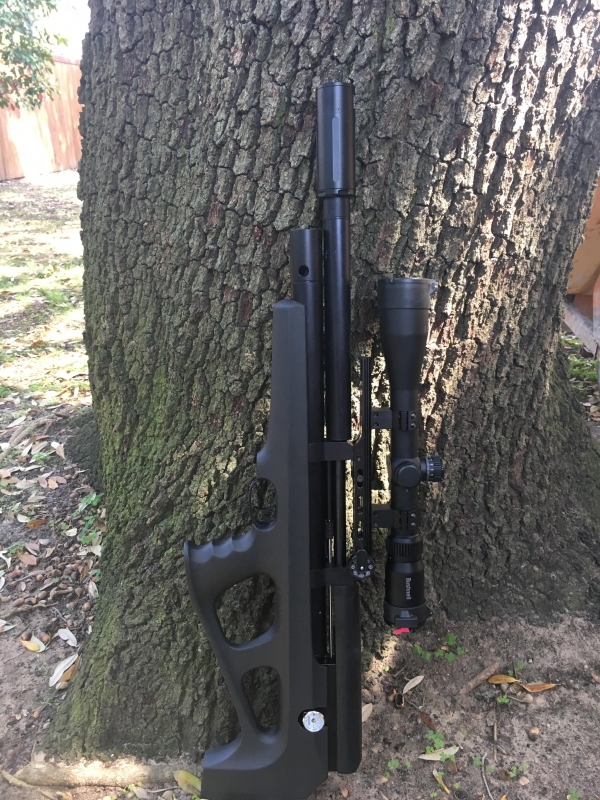

"CHUCK - This really makes sense when you consider that all the Edguns and many other air rifles are capable of being filled up to 300 Bar with no ill effects. These Huma regulators are built to withstand and operate at much higher pressures than the FX regulators. And for the naysayers out there let me remind you that these air tanks are tested to a minimum of 9,000 psi for safety…so no worries there for me either."
Chuck, please fill us in on this 9000 psi test pressure, and where that number comes from? I see a SWP of 250 bar, and know that the periodic hydro test is 5/3 of SWP for 1 minute. Are you referring to a design pressure? Just curious where your numbers come from and the rationale behind them... Thanks,
