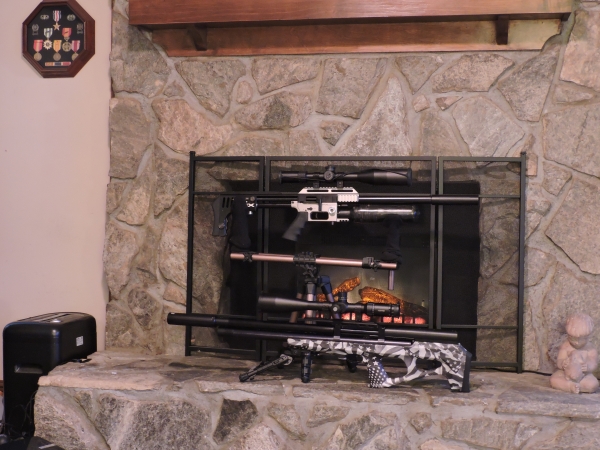

Here is the little girl all tuned up and shooting like the queen she is :)
Tatsu DonnyFL moderator and Huma reg with Huma gauge installed to tell me the reg pressure. Love this gun. Really loving this Bushnell Engage too. It gives the gun a very nice balance.
Monkeyshine, notice the gauge orientation :)
My 25 is starting to look at me funny as if I don't love it anymore.
Crusher
"Centercut"Super nice tack driver! I like the Tatsu, the Bushnell scope, the Reg pressure gage, Great shot strings, mag holder, Huma reg... Are your .25 WC and .25 Crown jealous?
I'm pretty sure they are. I think I heard one of them crying in its pillow last night.. ;)
Time to get the 25's out the range and let the big girl WC and the Crown stretch their legs a bit. They have 50, 100 and 150 yard stands. Anyone want to go with me ??
It has really been fun and enlightening to work on the WC. I have no fear of any part of the gun now. Well, maybe a little fear of that air stripper thing that is welded to the end of the barrel AND the shroud at the same time. (what a bad idea). But now that I know how to keep things in alignment, we are good to go.
Hey Tominco, How about you make a short video about putting the barrel back in the WC and how to get the pellet probe depth correct. All the other helpful videos I've watched and I never see anyone explaining how it is done. Now that I've done it a few dozen times (really), I can almost get it exactly right by eyeball. I still use the caliper to be sure though.
