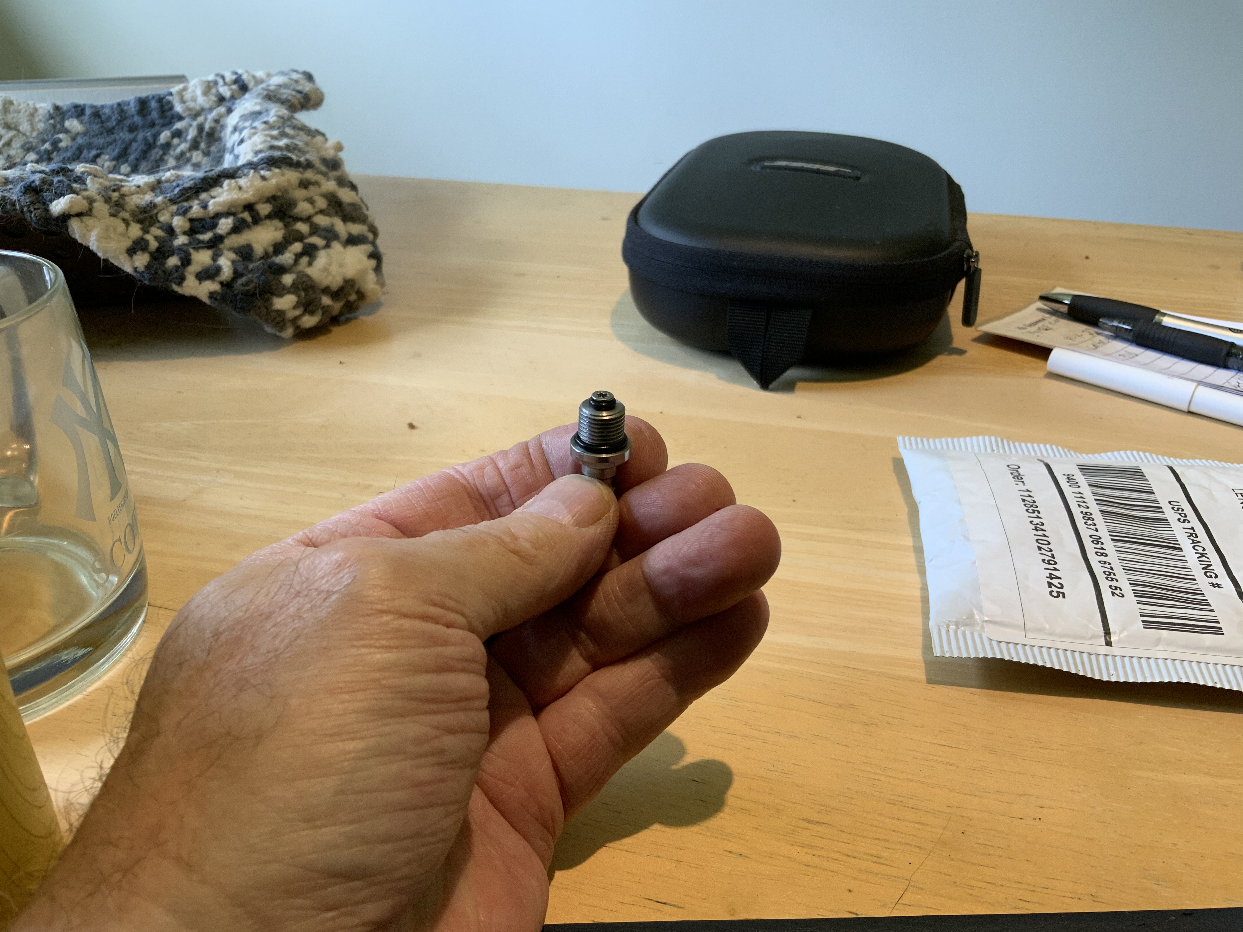

Hey all, quick question about this fill valve. This is the first of this style I’ve seen. Can anyone tell me how snug this screw/o-ring combo should be? It is brand new and would not seal, I have changed the oring, but have not reinstalled it yet. This is for a new Huma RTI regulator, which of course is giving me fits, also Covid is currently fogging the heck out of my brain, so probably not the best timing for a reg change. To be clear, it was not holding bottle bottle pressure, as sent.
That screw adjusts your fill rate. I have a Huma on my RTI and it required some work to get its creep under control. When I took it apart I was surprised at the shoddy machine work in the business end of the spool and immediately knew where my creep was coming from. When you put that foster in, just make it snug. The flow screw, don’t make it snug or bottom it out. Just compress the oring a little when you turn the screw in.
