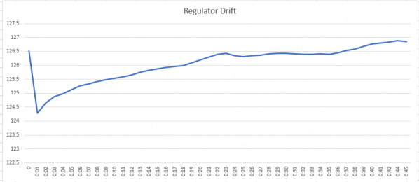

I think we may get bogged down in minutiae. Below is a test I did with the Huma prototype over 45 minutes. The initial pressure was set to 125 bar. I set it outside on my shooting table in the sun and came back about 10 minutes later. You can see that the pressure increased due to the heat. I then did one shot and took a reading every minute for 45 minutes. The SD for the entire test was 0.6, and the rifle shot fine. I checked it the next morning in the house and pressure was back to 125.
