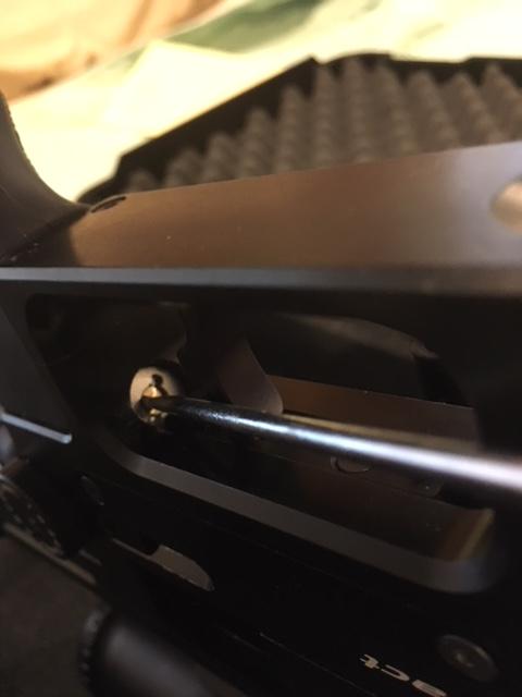

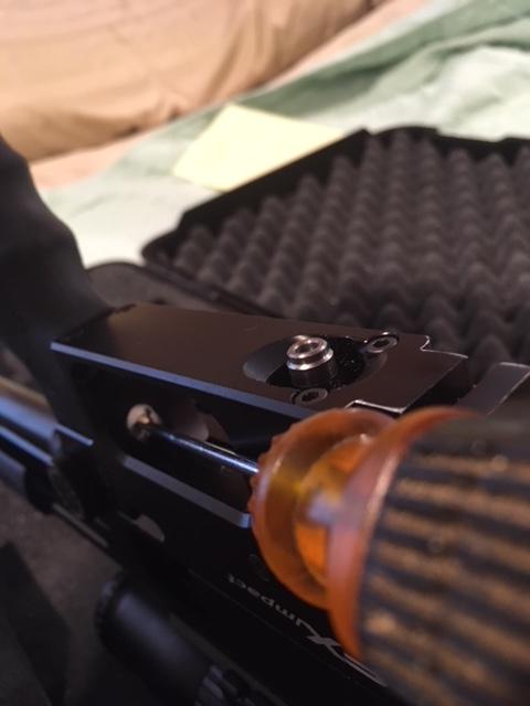

The FX regulator uses hex wrenches for both the regulator housing, and the regulator adjustment screw. The Huma uses a straight edge. I really didnt think about that too much while I was putting the Huma in, but later it became apparent to me that this was absolutely idiotic.
To adjust the Impacts' stock regulator you use a hex wrench with a ball end. You come in at a bit of an angle, and it clears the trigger just fine. It's easy to make whatever adjustments you need without a lot of messing around. This isn't the case with the Huma at all. Since the reg adjuster uses a slotted screw, you cannot easily adjust the reg in a timely manner, because the trigger is in the way, and it's likely you'll scratch up the reg housing. I'll have to look into modifying a scewdriver for this purpose, but I shouldn't have to!

I use a long skinny screw driver to adjust the reg no need to remove trigger guard or trigger
