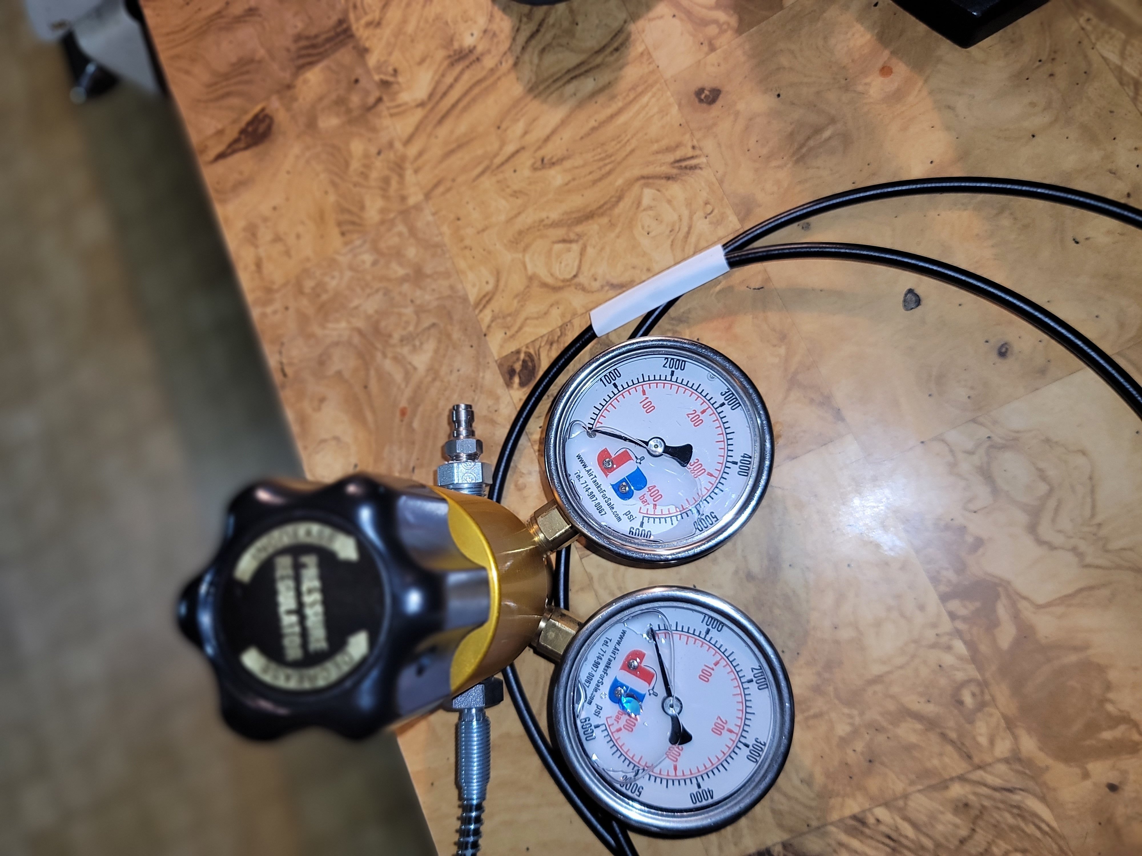

@JCarlin2778 That looks like a solid piece of gear. Their stuff costs, but they have nice build quality in my experience.Absolutely!! I think I'm just going to go with the regman 2.0. I was hopeing to find something a little more compact but understand completely your advice about higher pressure regulators for high pressure guns.

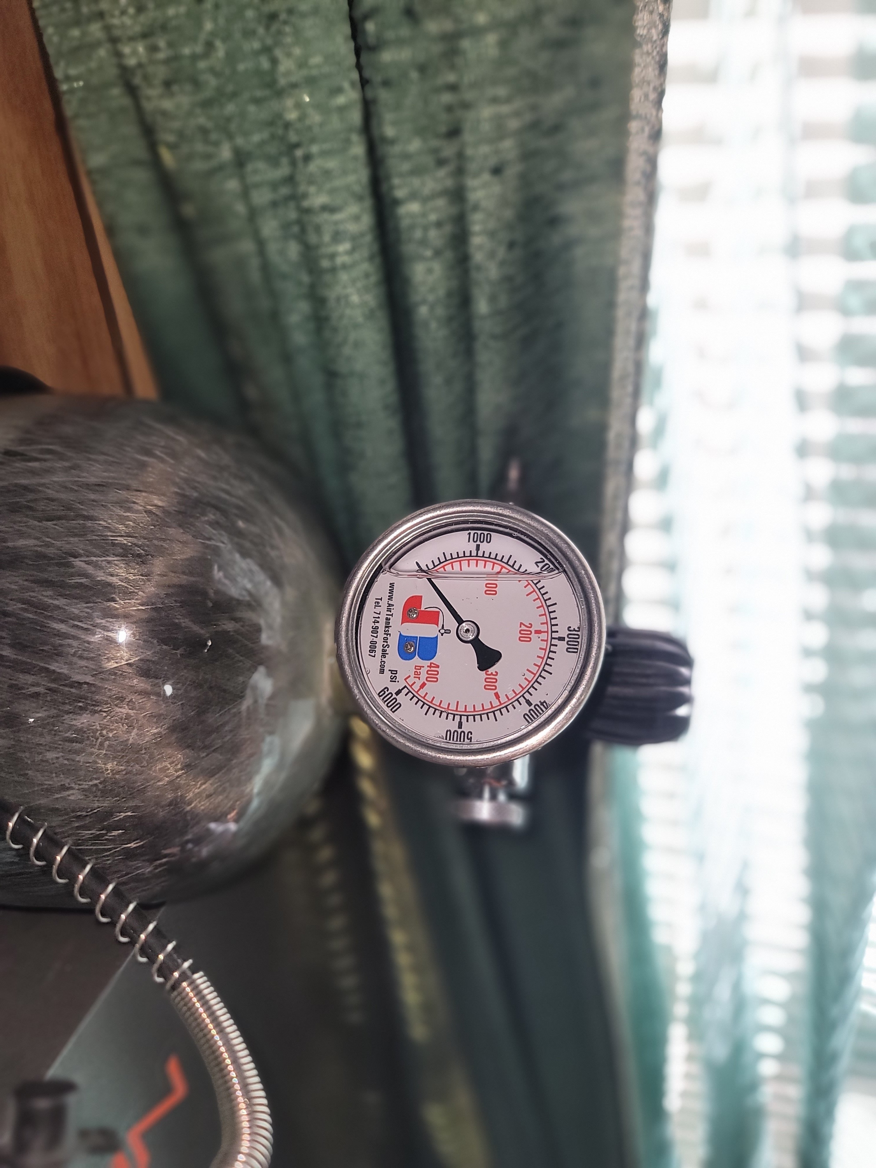

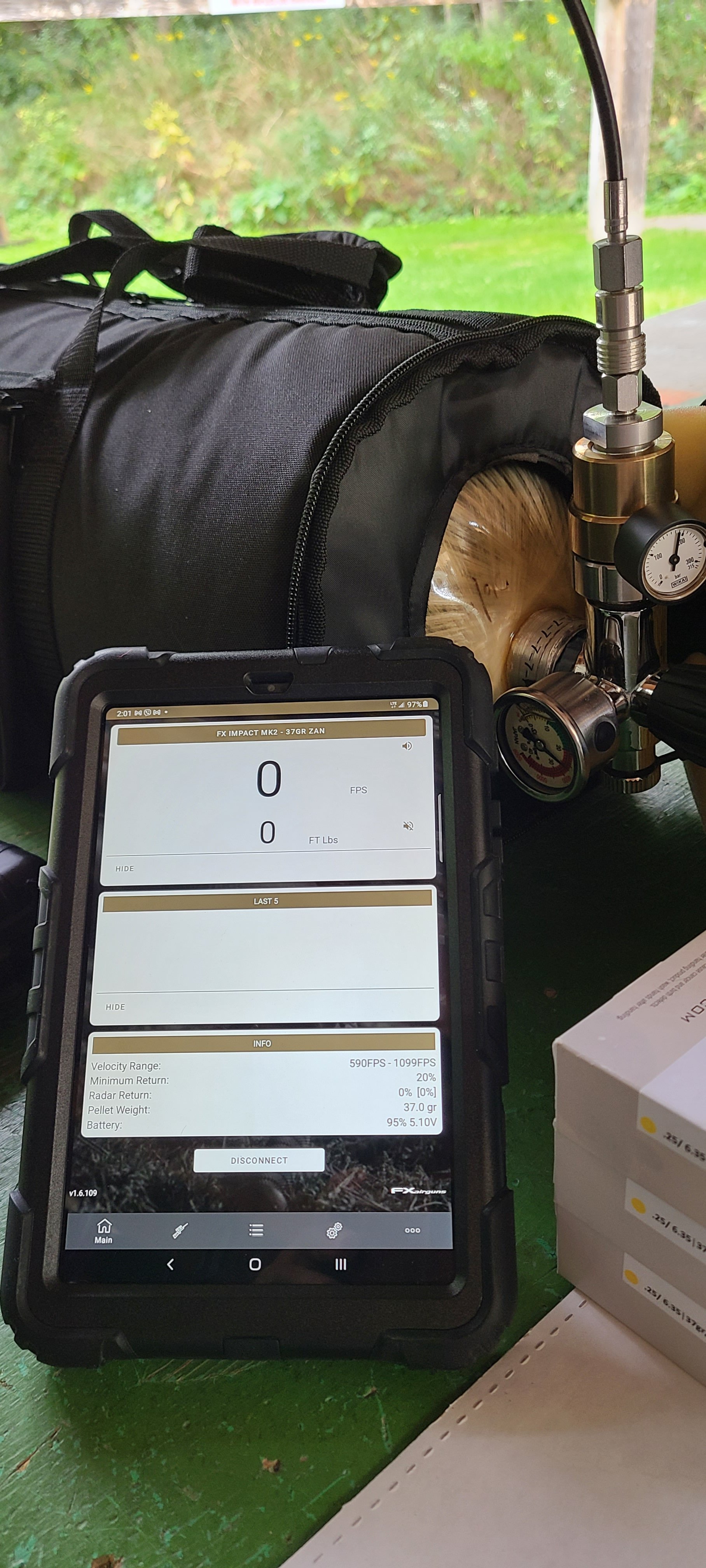

I should have taken this advice when you gave it!!!! I was trying to be cheap and it cost me more in the long run!! SMH! Someone on the forum told me by once, cry once!! He wasn't lying! I finally wisened up though!!!! Got these in yesterday!!Although it’s my first time seeing that reg being able to handle 315 bar input pressure , I suggest getting a larger reg for a big bore. Something like 5000 psi. The Texan with the TX2 valve has a carbon fiber tank can hold a higher fill pressure the the aluminum tanks on earlier Texans. You may get a Huben or something that can take a higher fill pressure or you may opt to rent a nitrogen tank. In these situations an in-line regulator that can handle higher pressure may prove beneficial in the future. Plus why constantly push your reg to the max?
