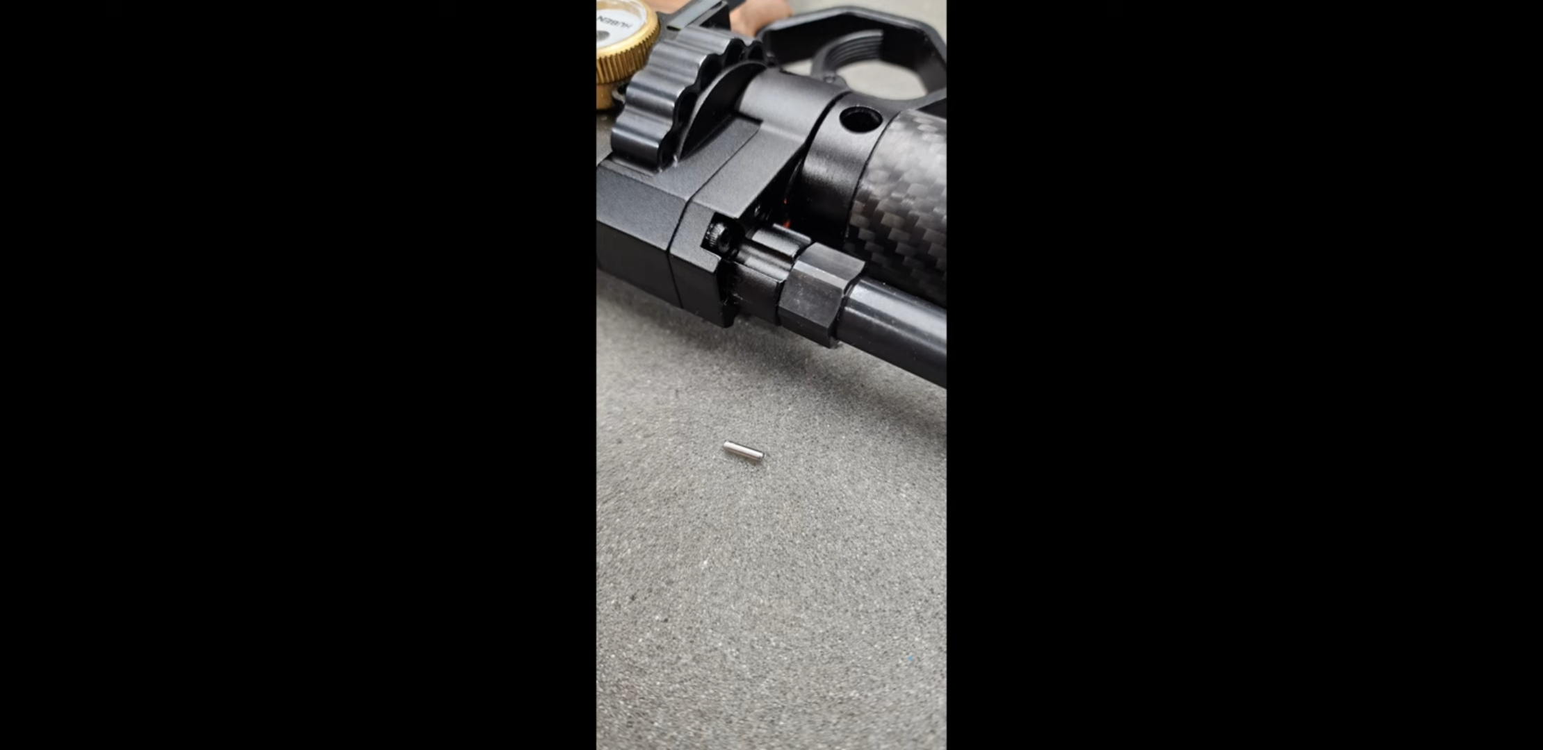

I saw the red dot install video on YT but its not very thorough. I was wondering about where the shroud is removed and pin is pulled out if I was going to need to drill and tap that area. Also do you reinsert the pin after you tap or is there no need or no space anymore once thats been done.
Is that what you will need to do?
If you have done it already do you have the drill and tap size off hand?
My GK1 shows up next week and I have everything waiting on it so this will be my first task.
I believe folks have been tapping it for an M3 bolt. No pin used after as the bolt takes up all the space.

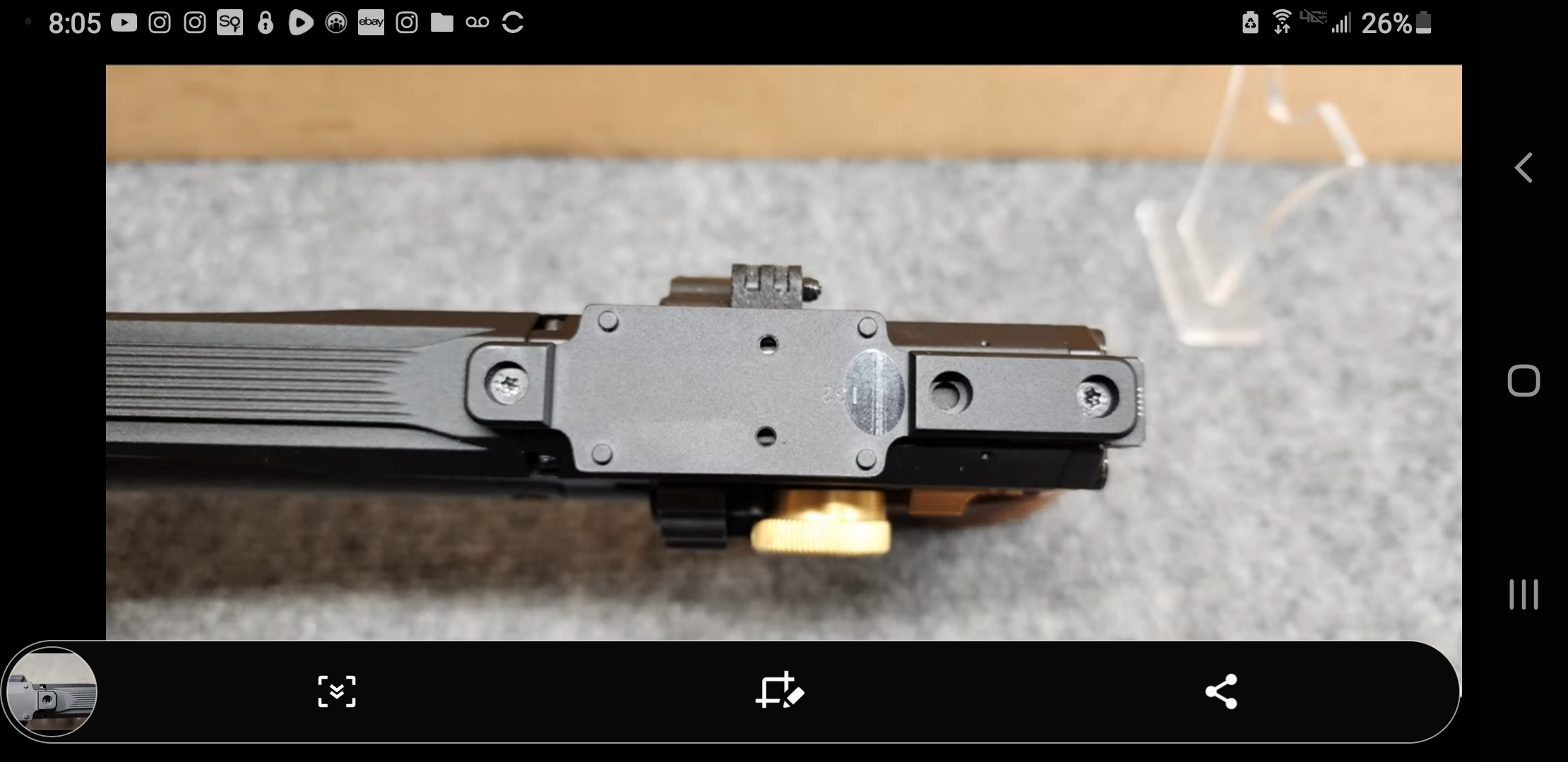

I designed/printed a rmr plate as I didn't want to tap the locating pin slot (even though I could). Wanted the challenge of seeing if I could design something that would work. Seems to work so far, was my Saturday side project because of a rainy day--need to make some slight tweaks and abuse it a bit to see how it holds up.
Thanks for the tap and bolt info.
How are you securing the front of your rmr plate?

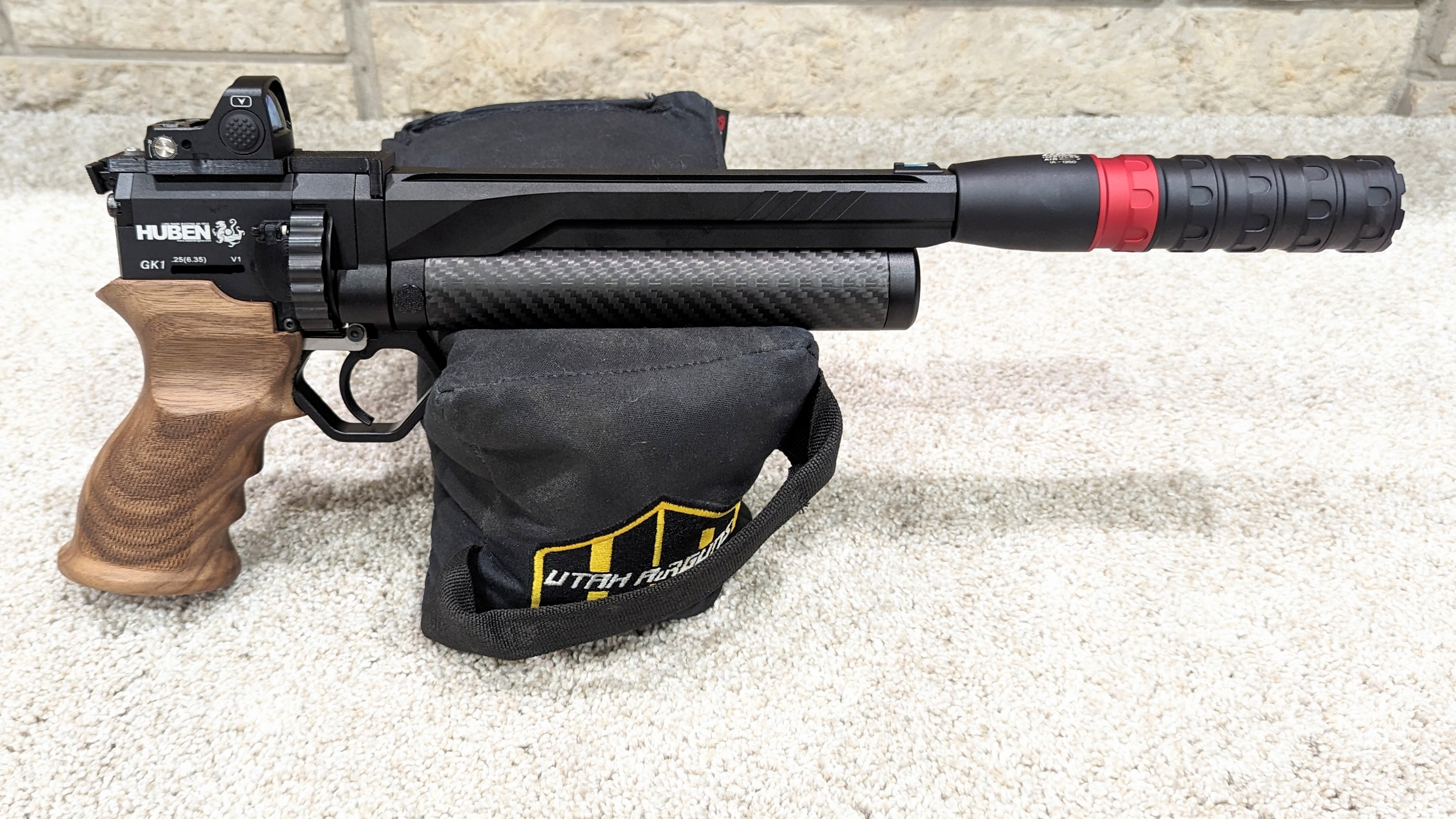

I believe the solution to all this 3D printing and sight clearance is simply new front and rear sights, which offers a sight line above the moderator. However, I have had such incredibly great experience with reflex sights on my PP700SA that I will immediately mount one with a side laser on my GK1 when it is delivered. When I ordered and paid for mine, I also paid for their CF moderator. By using the 11mm rail on the GK1 to mount the sight, it will also allow a sight line height above the barrel line of about 40mm. Problem solved without the use of micky mouse plastic.
Just a little design trick. I may abandon it for a more secure design, but I'm going to abuse it over the next week to see if this initial version holds up. I'm somewhat careful with a PCP like this but need to make sure it will be 'tough' enough to share.
Best thing to remove the pin is to clamp it on a vise with gun upside down. I wiggled the hand grip while pulling back, very easy and no mark on the gun. You also need to drill one hole on the rmr mount for the screw that protrude on the gun action.
Do I clamp the vise to the reciever? Not sure I understand where you are clamping onto the gun to wiggle the grip and remove the pin.
Any additional pics or explanation would be appreciated.
NO, it's going to scratch the receiver. After you remove the shroud, the pin will be exposed, I tried with visegrips but keep slipping off. Then I clamped the pin to the edge of my drill press vise and it's very easy.
