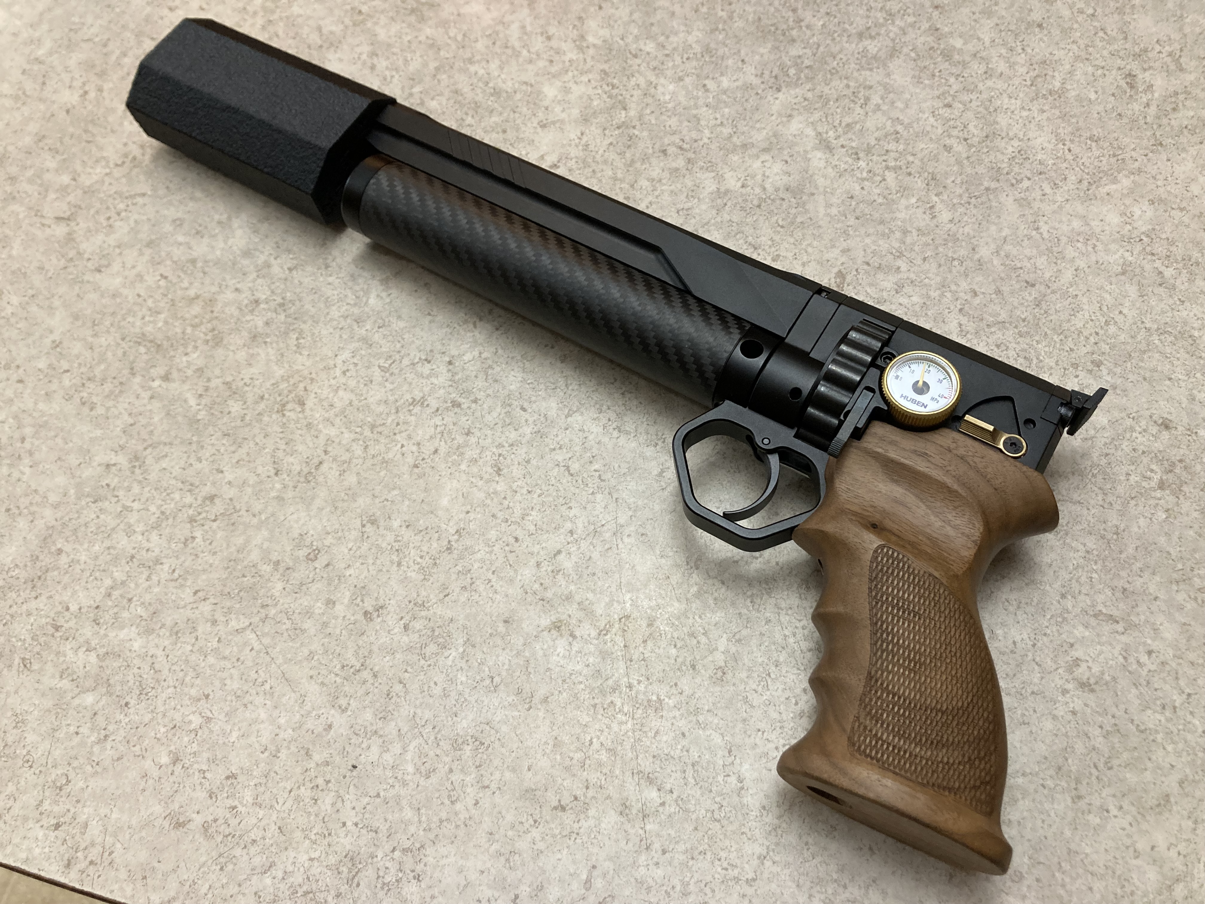

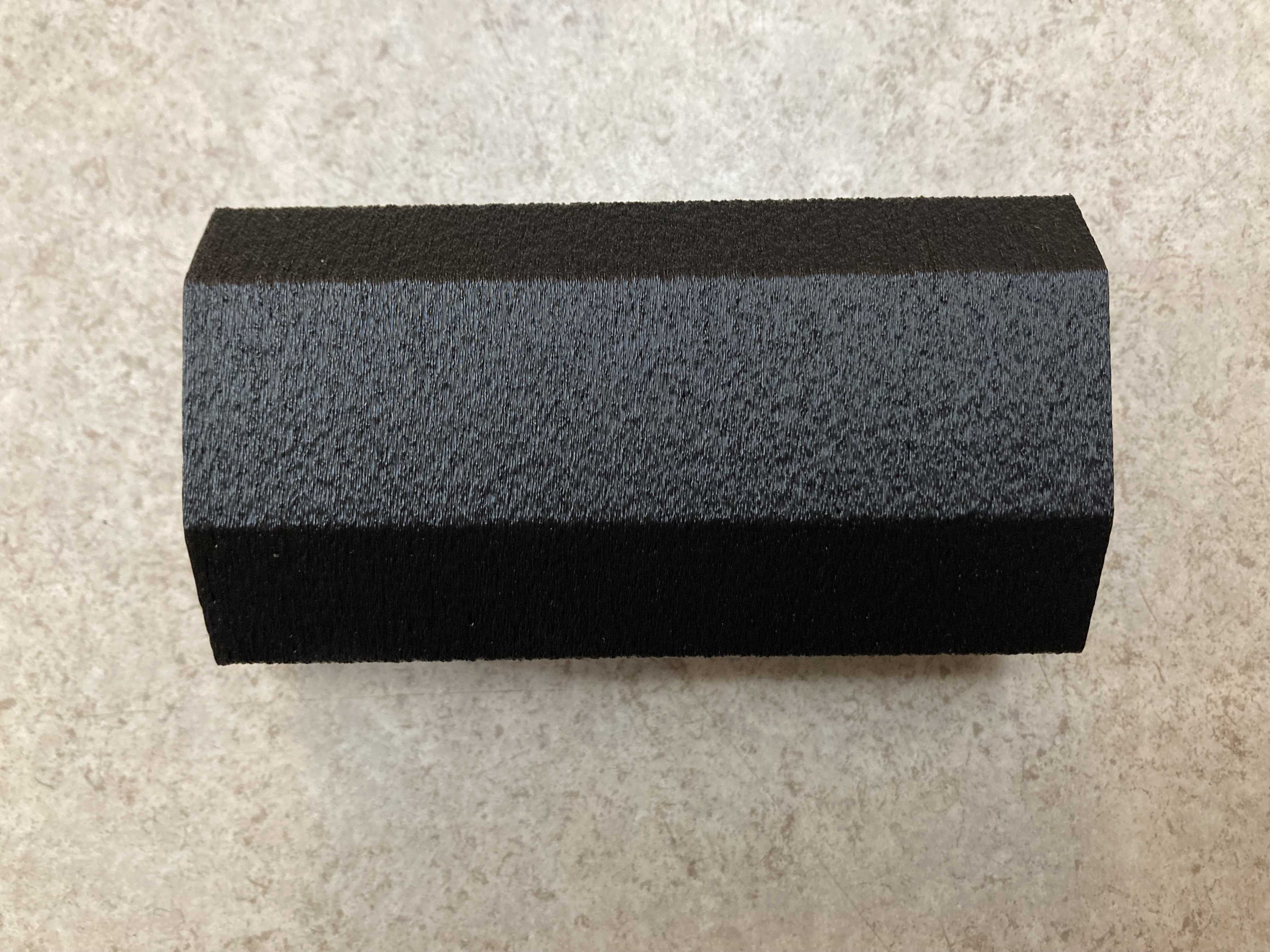

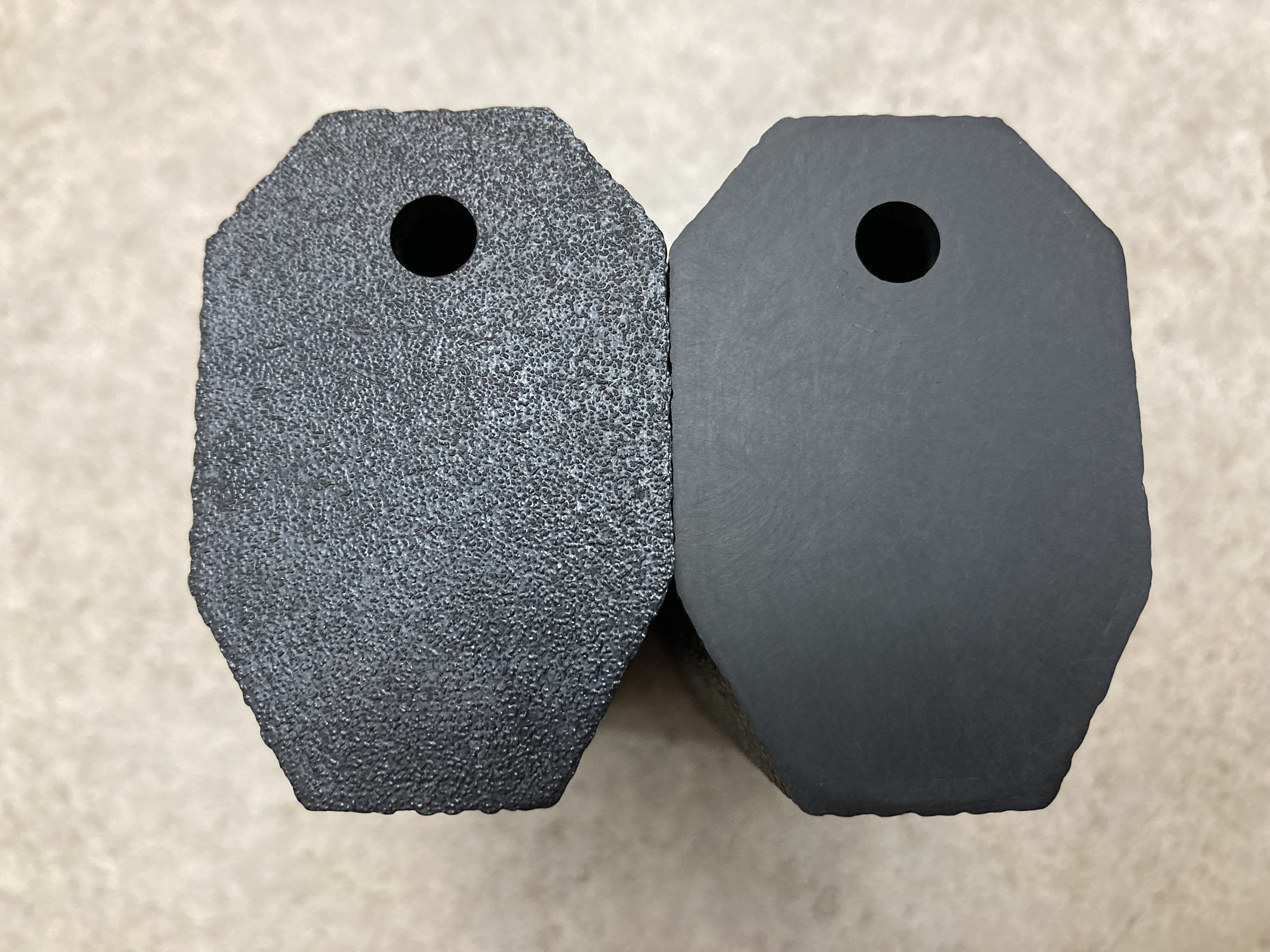

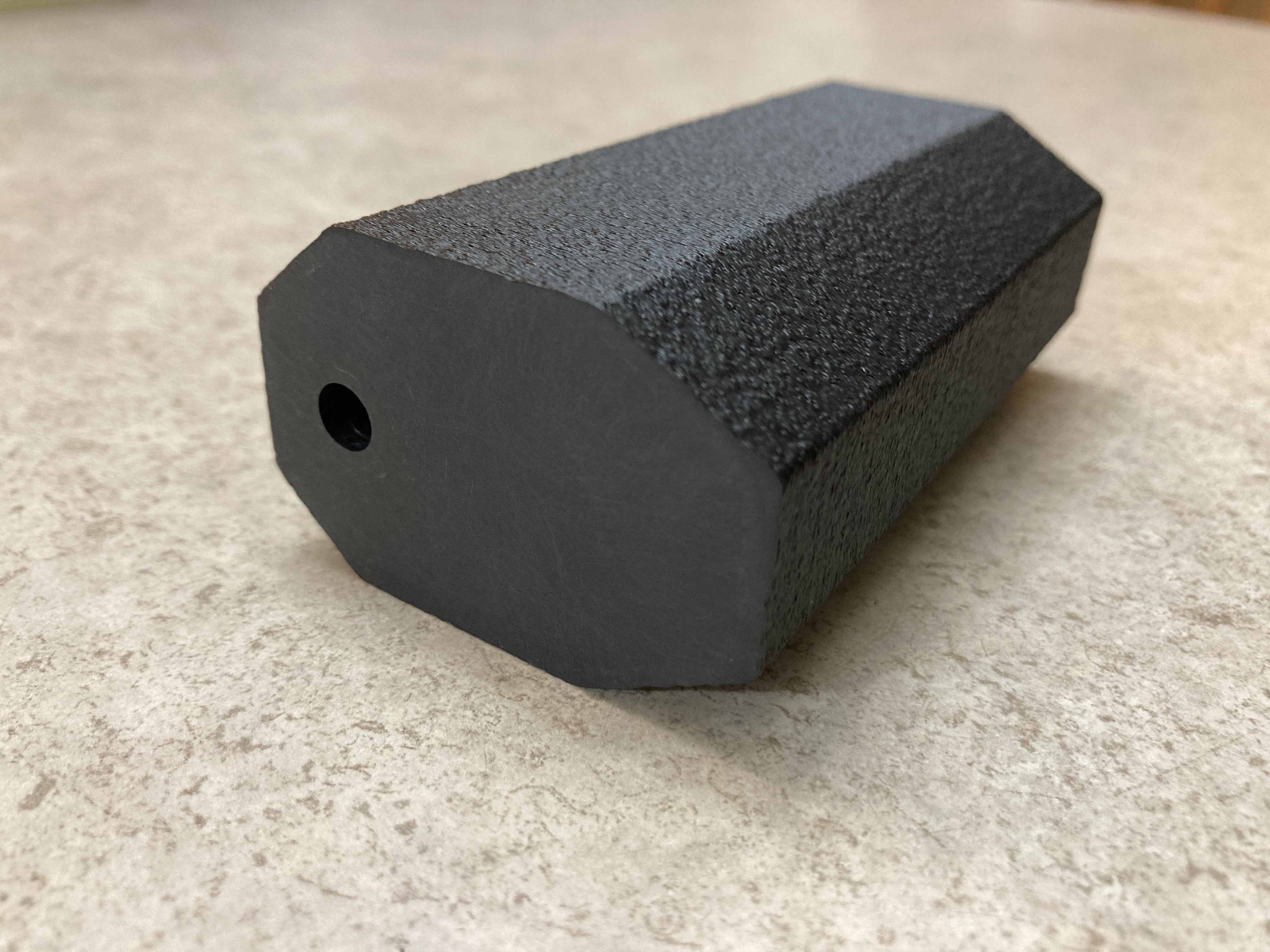

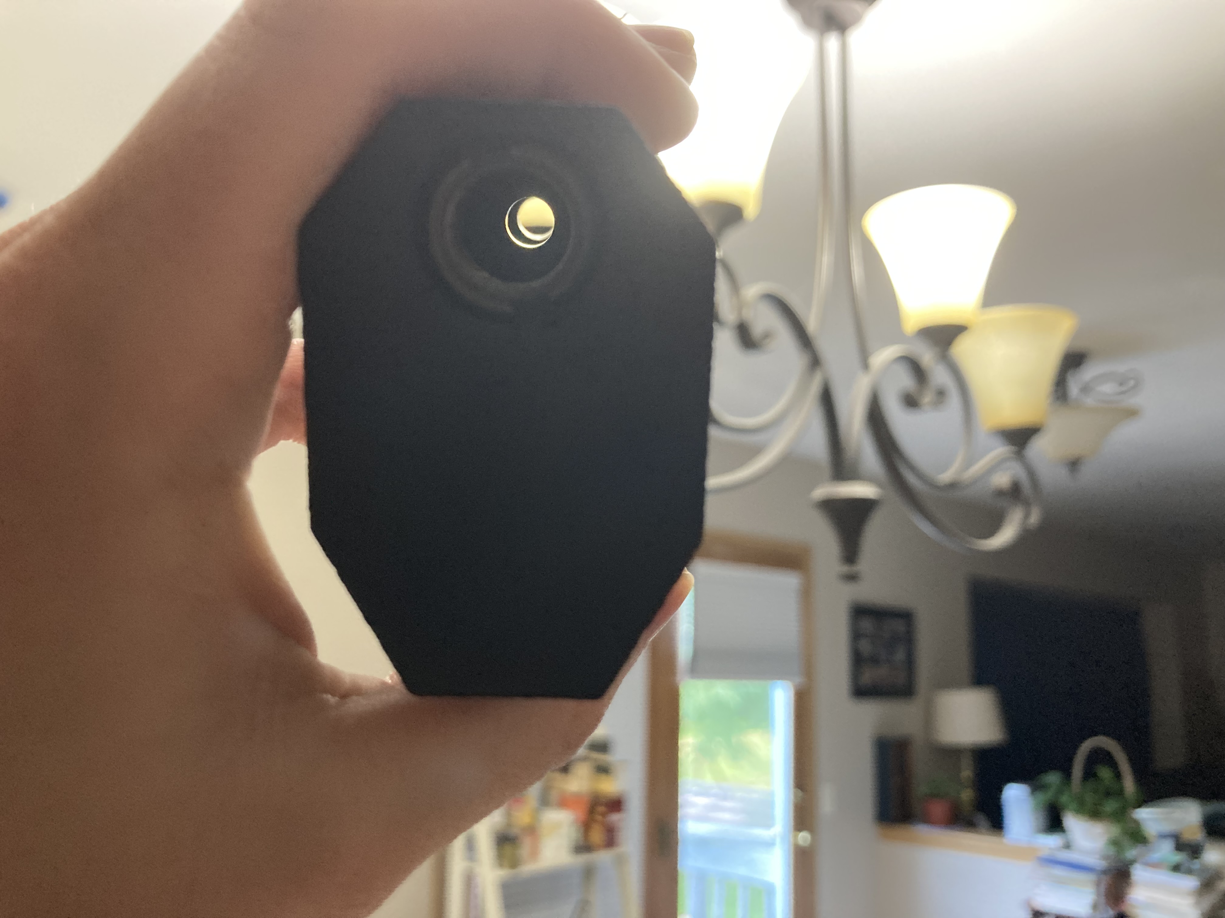

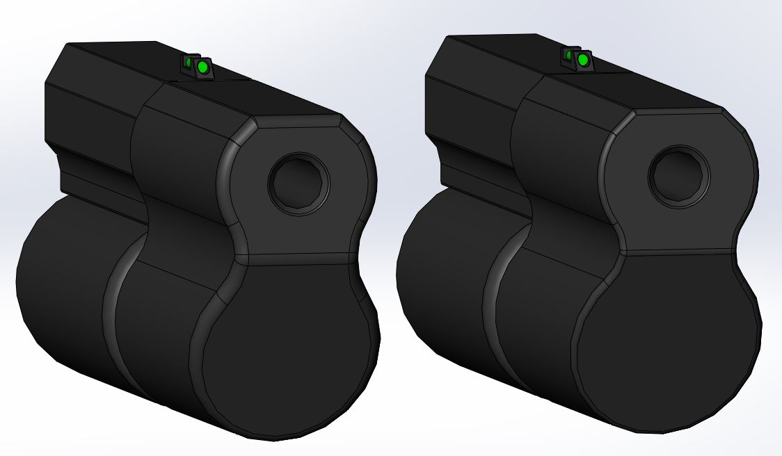

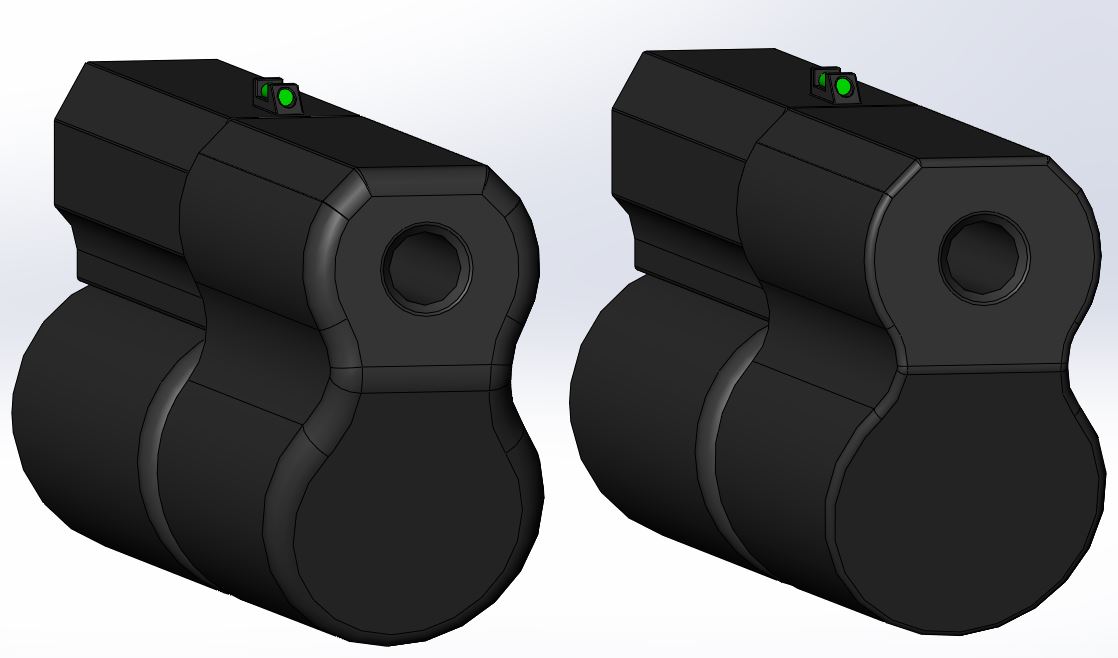

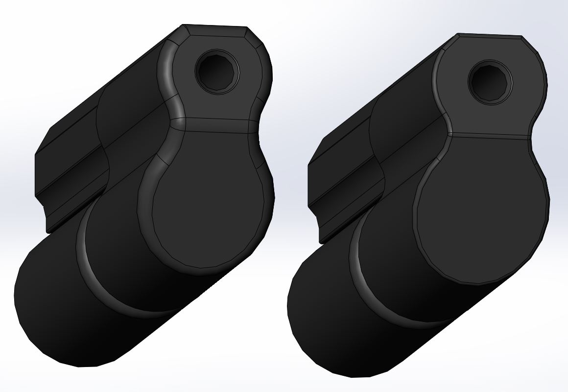

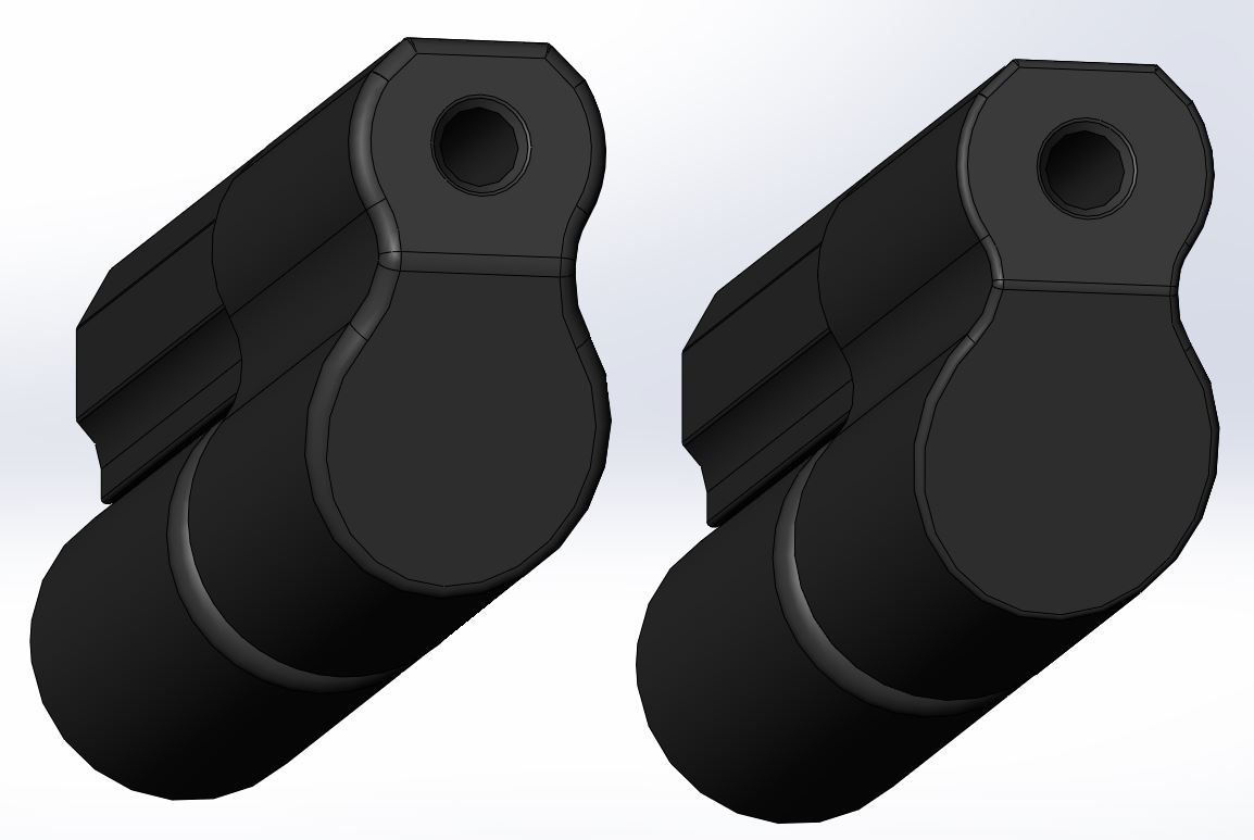

What about larger front face corner radii? Easier to get into a holster, and echoes the look of the air tank. Makes the Muffler look a little less bulky too.
The images below have the second and third muffler compared. The third one has the corner radii kept at 1 mm. The second muffler has the frontal corner radius increased to 2 mm; then to 3 mm.
Which looks better?
For reference, the 1.5 OD by 5" long offset muffler M0ist0ne printed (above) has a 2 mm front corner radius.
Personally, I don't mind the more squared-up with rounded corner look. I have odd rates though lol

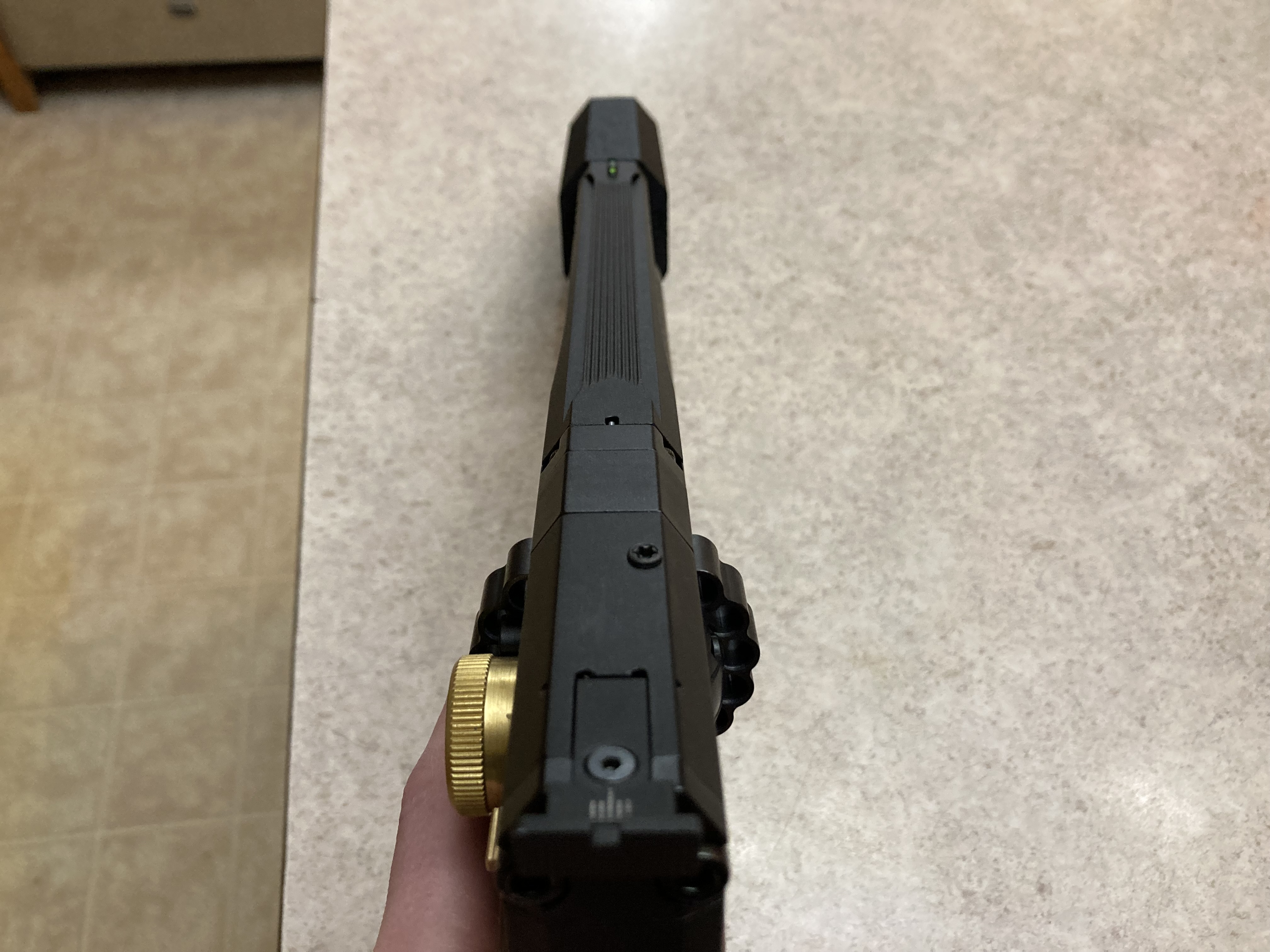

Thanks again for the brief test. Just wondering with all the mods you tested are there poi changes using the iron sights?
I haven't tested for that specifically yet. But from what I can tell so far with how the barrel is attached and how the barrel cover kept in place, the heavier the mod, the more poi shift you'll have.

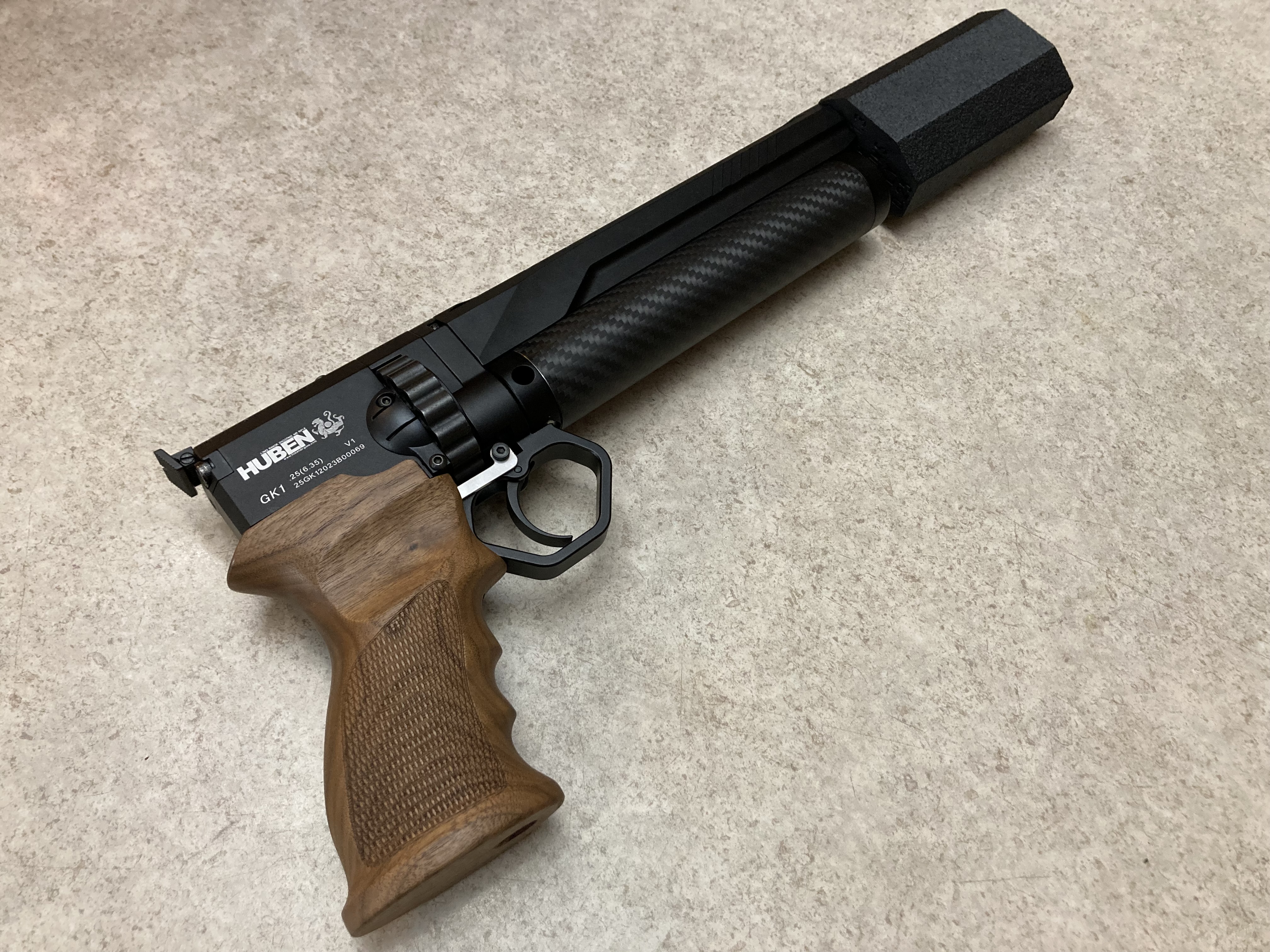

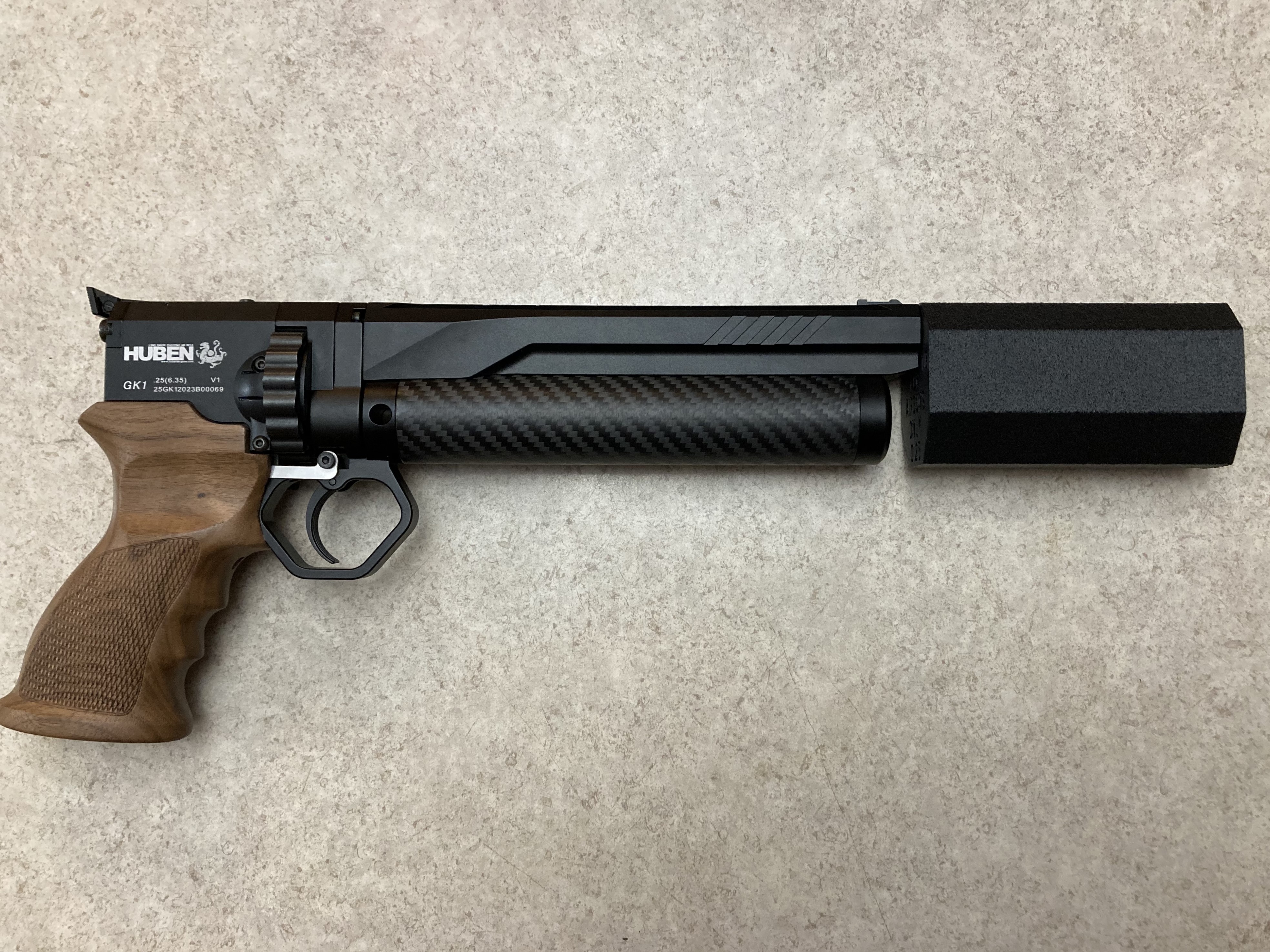

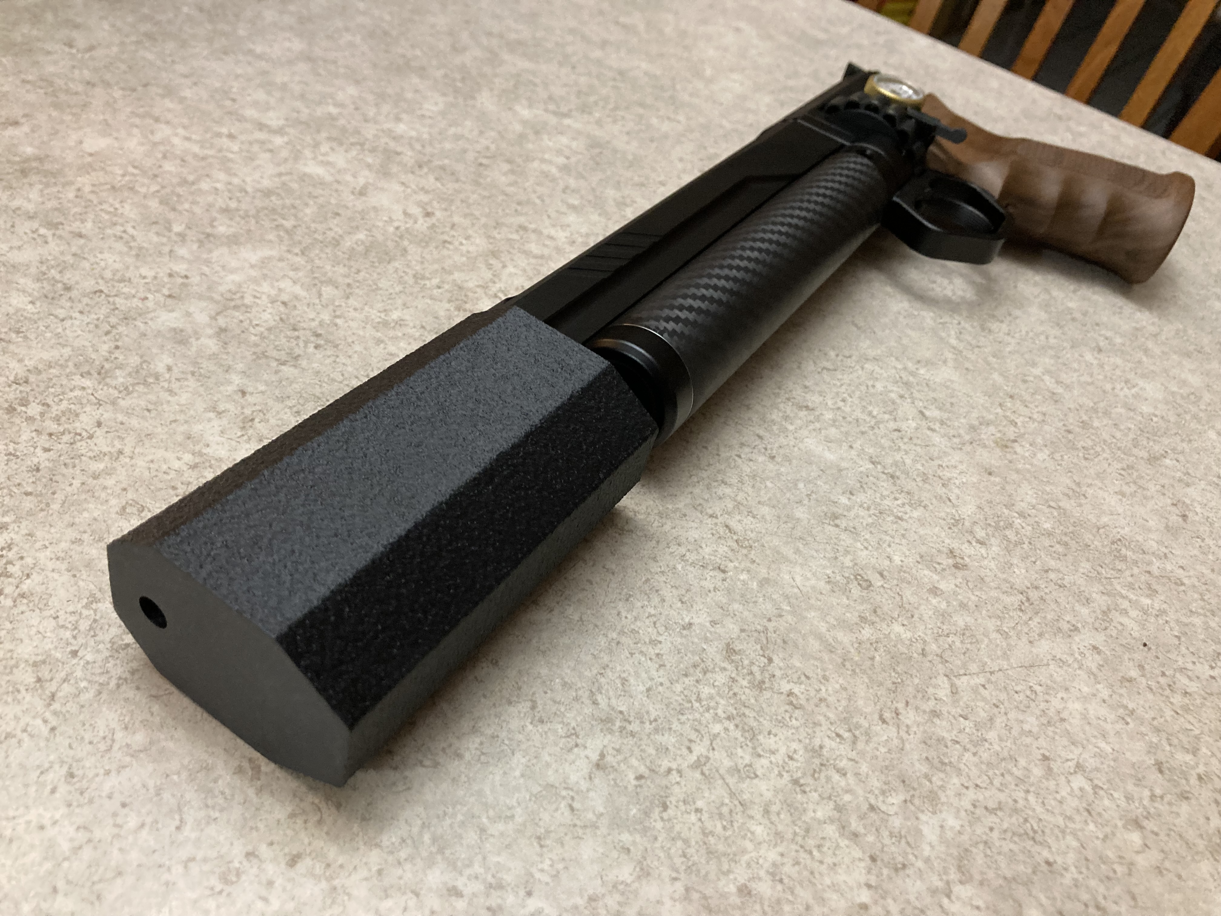

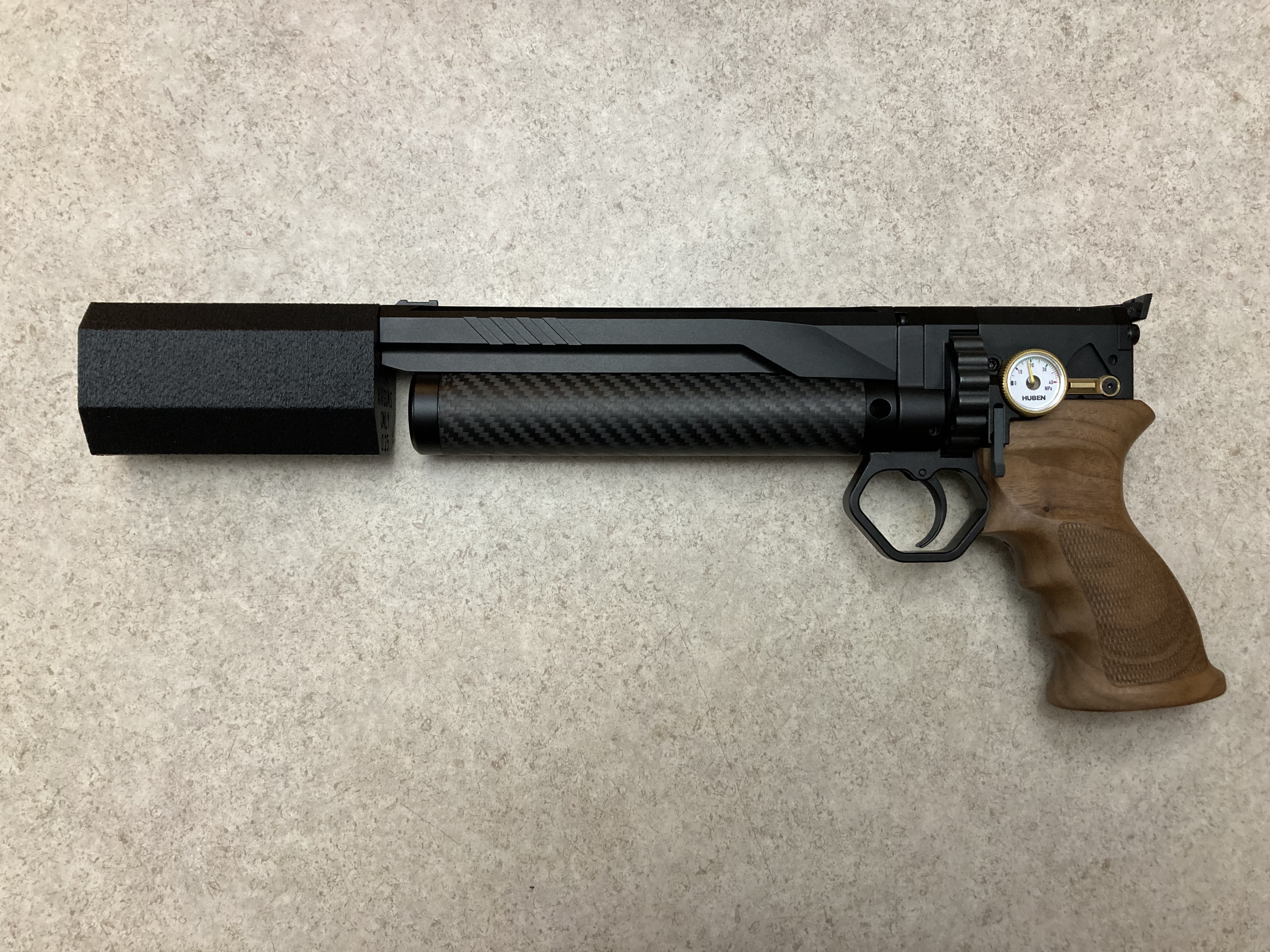

Is it possible to add to the back side of the bottom chamber to get it closer to the front of the air cylinder when screwed on, or would that interfere with the ability to screw it one? I'm also looking for something that would be easy to holler, so the more rounded leading edge would be preferred. I also like the models that more closelyy follow the lines of the shroud and air cylinder. Great design!
It may be possible, if the gap is predictable and the same from one pistol to the next. Probably depends on how close a gap you want nominally?
I modelled the pistol from dimensions provided to me by IMADMAN. Dimension I did not have, I assumed for the sake of appearance. So, if I am provided the distance from the base of the air tank to the shroud front face, I can model what you seek, with perhaps a 1 or 2 mm gap. The gap in my model is 6.35 mm or .25". Everything looks larger, when you zoom in on it.

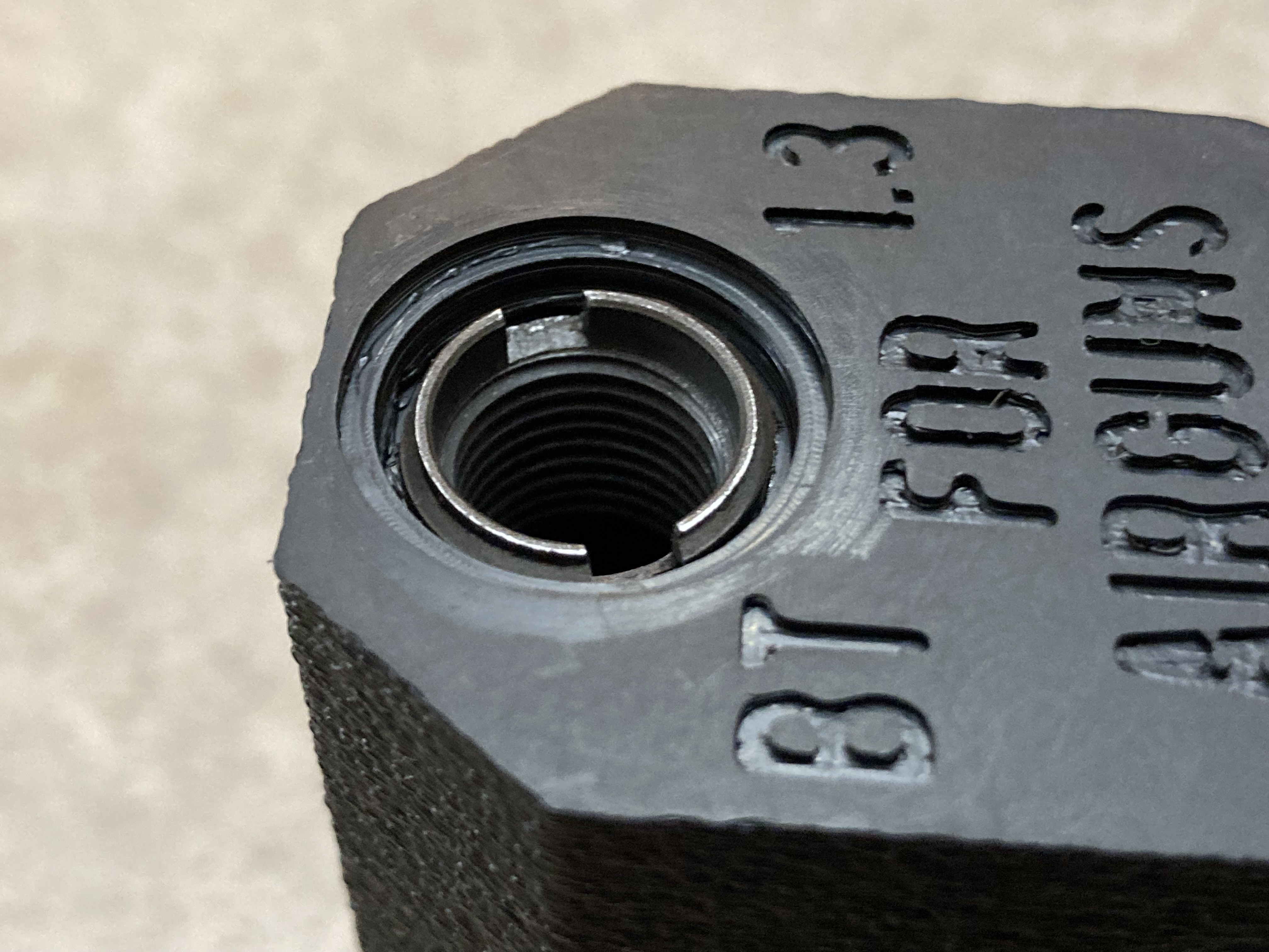

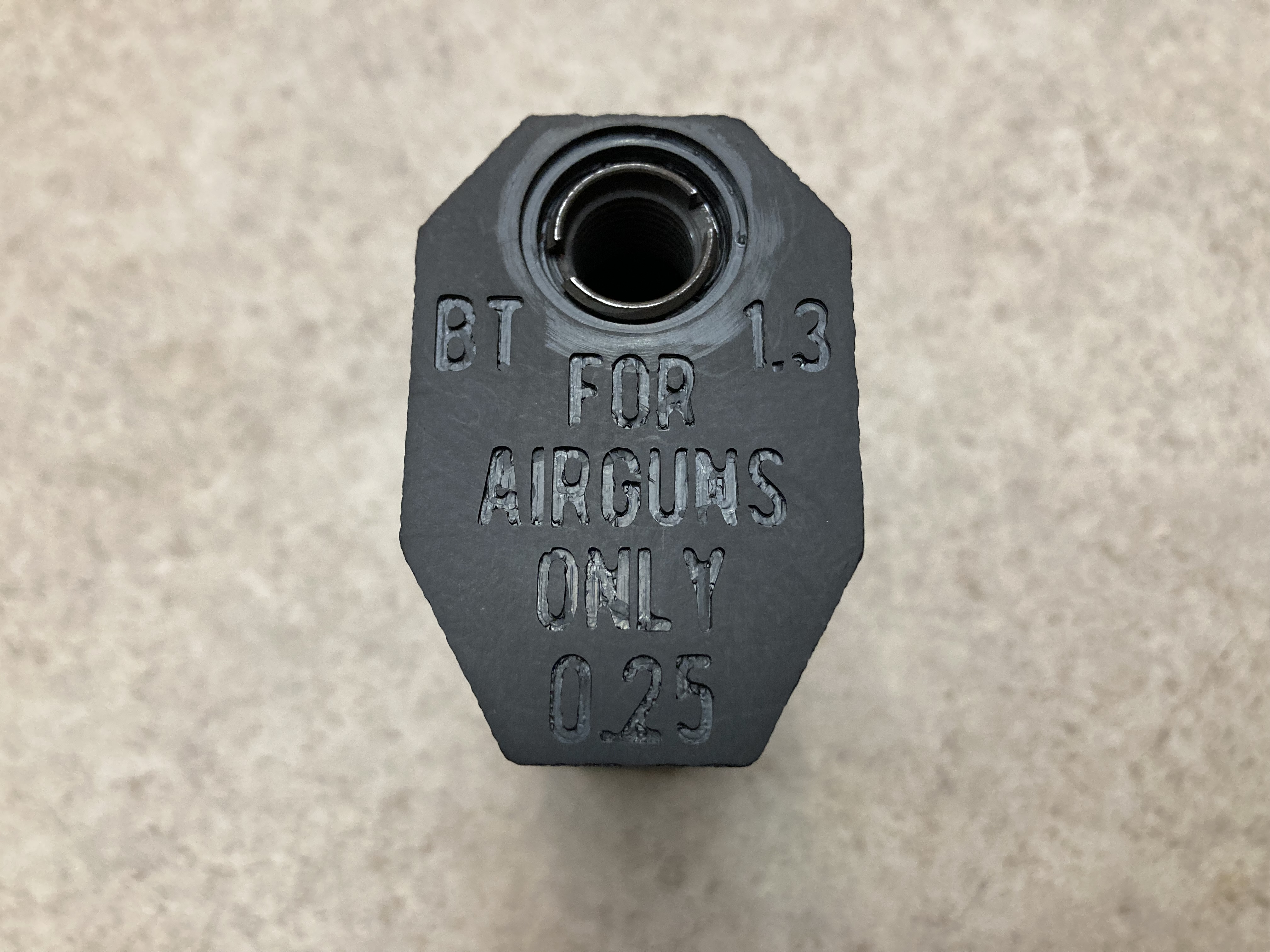

Alright, I think these are ready to go now! 🙂 I still need to do a large test of all of the suppressors I have on hand right now and add that data to the webpage tomorrow, but other than that I think I'm ready to start cranking these out. 😃
Pricing for now will be between $45.49 and $67.99 plus shipping depending on the options chosen. For the first 25 sold I will replace the suppressors for free at least once in the event of pellet/slug clippings of the baffles or structural failures of the suppressor should there be any. If the pricing seems a little high to anyone, please consider that Buck Rail suppressors are 3D printed and cost about $30-$40 but are only about one third to one half as effective as these are by spatial volume (I'll verify this tomorrow with the final round of decibel tests).
The current iteration (1.3) of the 4.25" variant is giving a reduction of right around 10dB (94.4dB) vs the bare muzzle (104.5dB) when using pellets, I'll have more accurate numbers tomorrow. I haven't printed any 5.125" or 6" ones yet, but they will likely result in reductions of around 11-12dB and 13-14dB respectively.

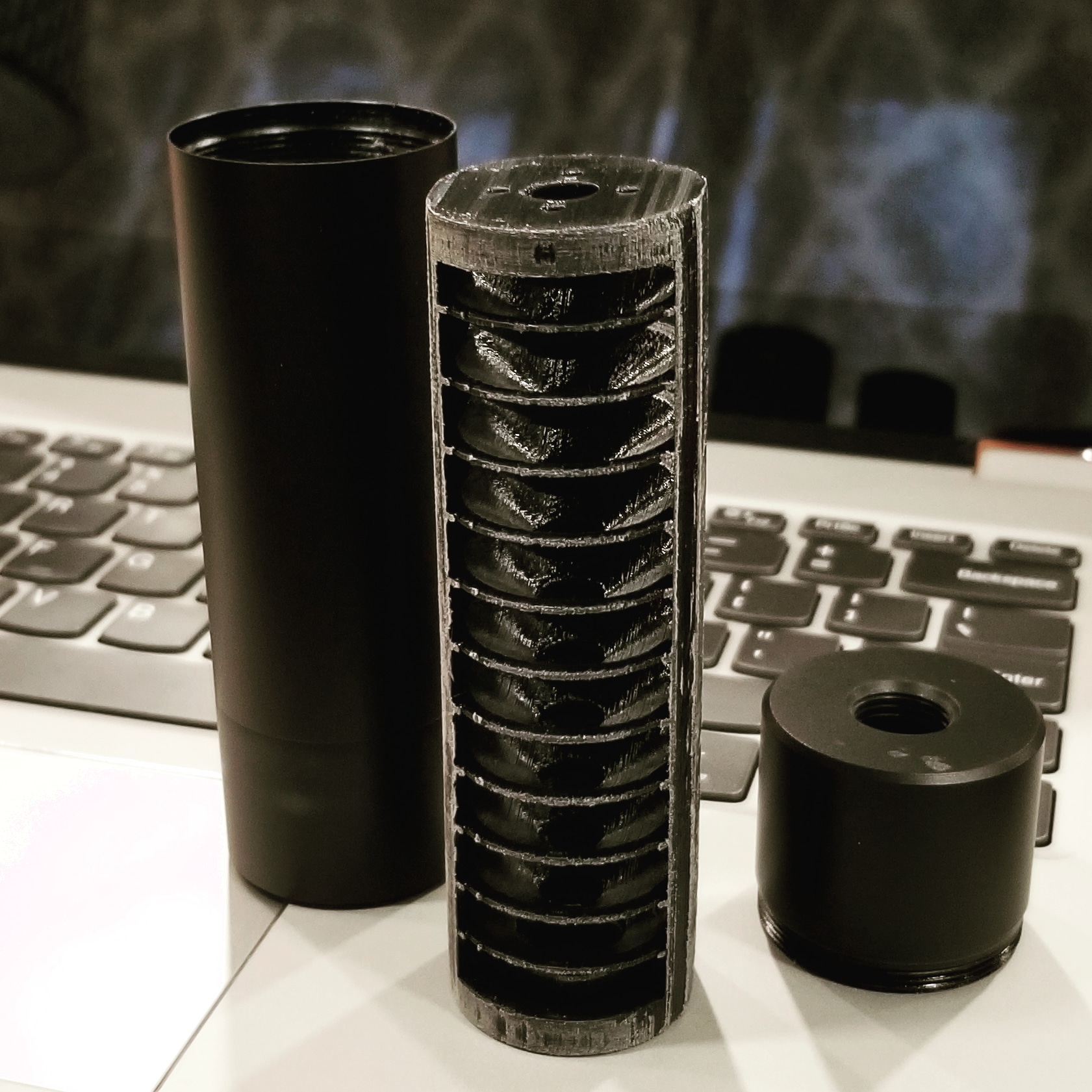

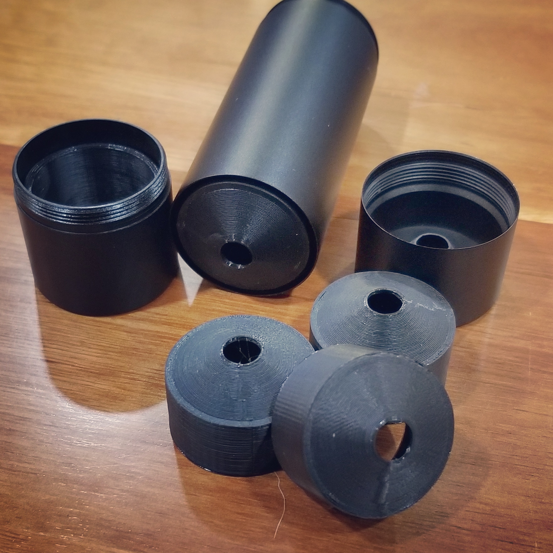

M0ist0ne,
Was this insert printed on its side? I ask, based on how to deal with overhangs.
Yes, it was. 😁 the two bars on the sides are filleted with flats. Also helps make sure the insert didn't get stuck in the can. Was the only way I could try to print the crazy stack.
I made it more as a joke, but it surprisingly worked fairly well.
