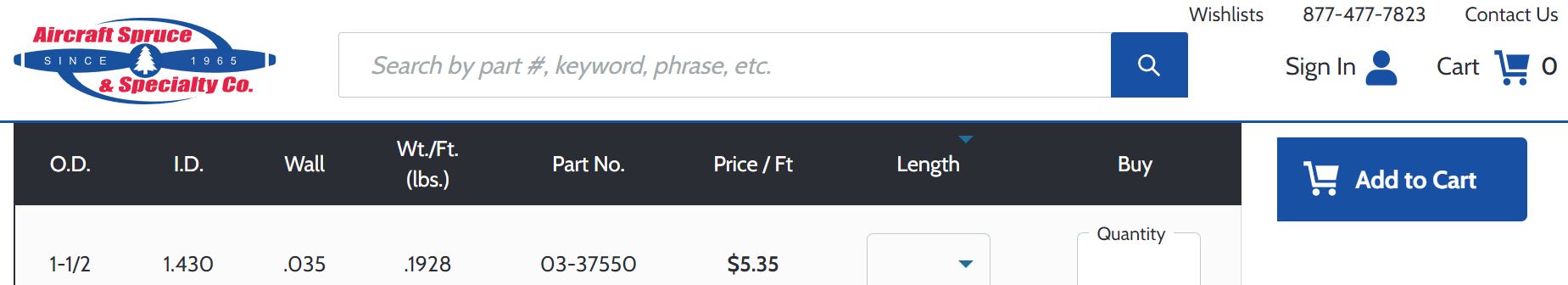

If I was to suggest tubing, it would be 6061-T6 tubing from the cheapest reliable source; Aircraft Spruce - see link and image below:
It is 4x more expensive from McMaster, but they provide working pressure values, if you don't want to calculate it: https://www.mcmaster.com/89965K731/

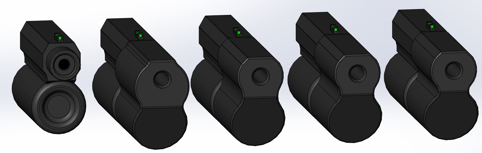

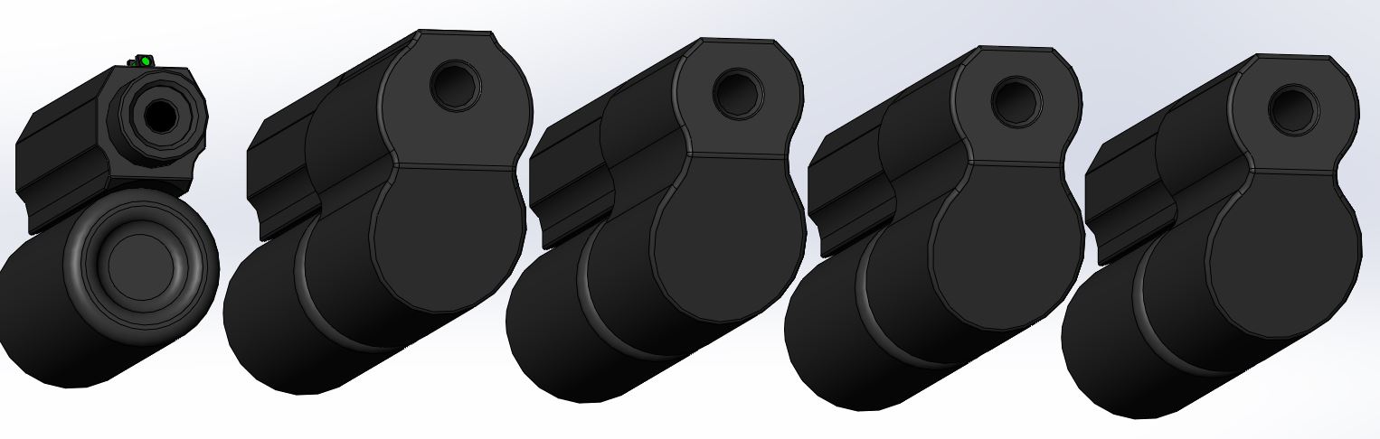

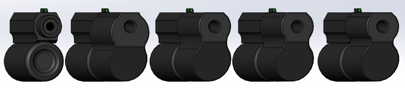

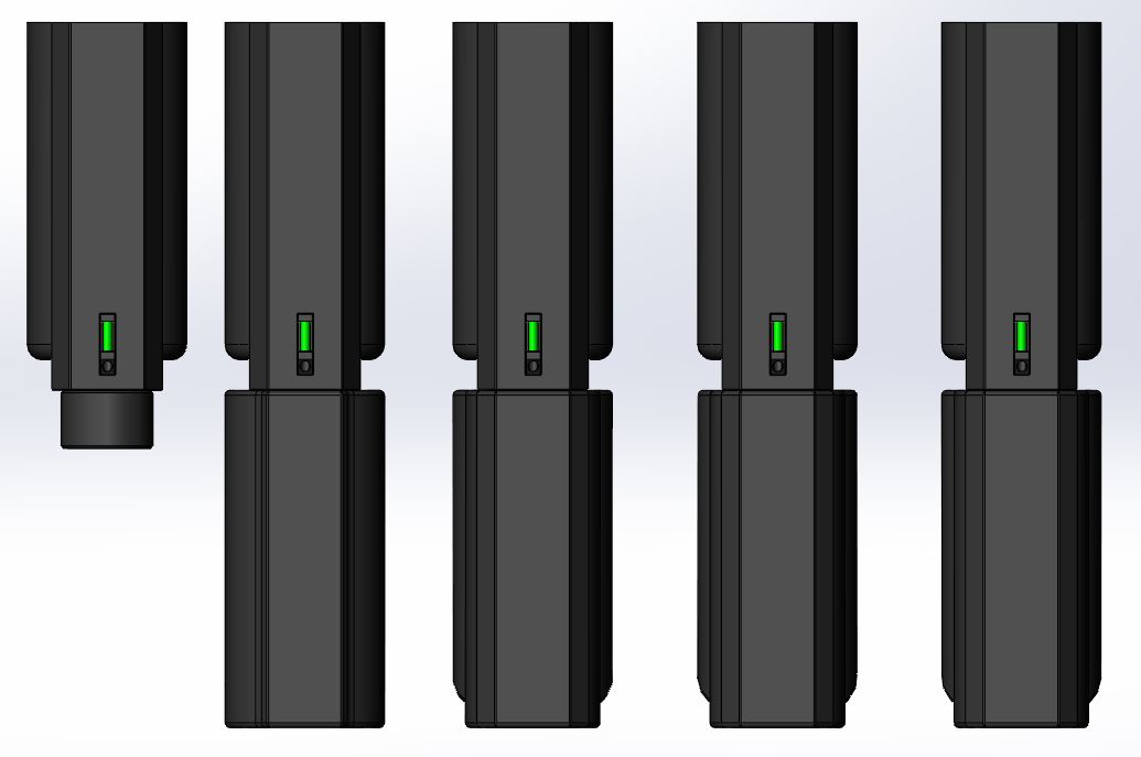

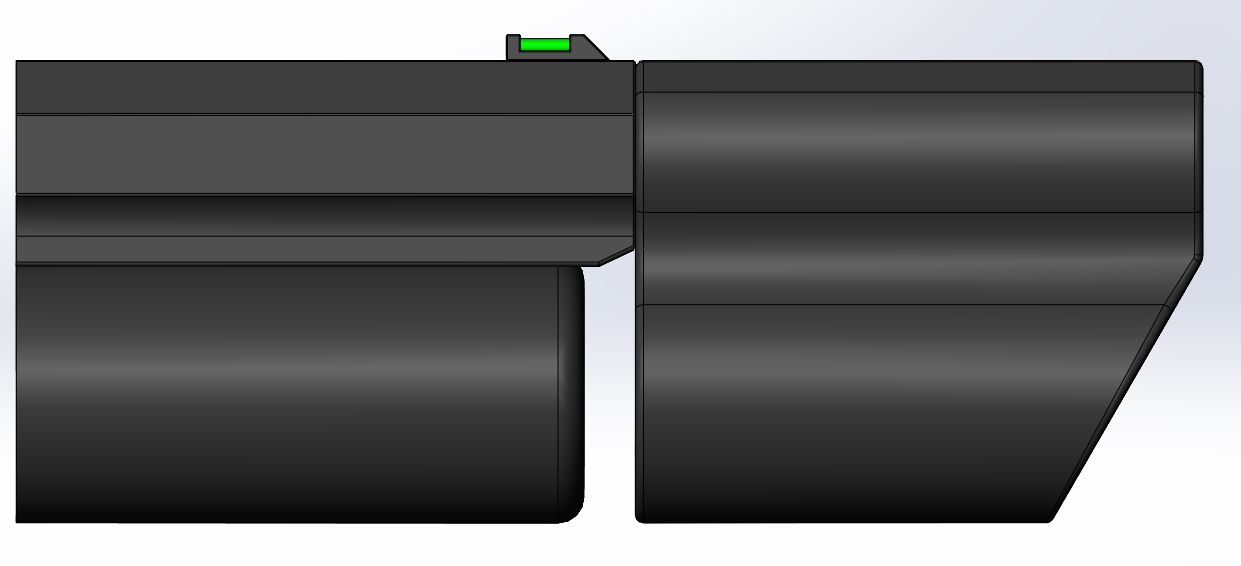

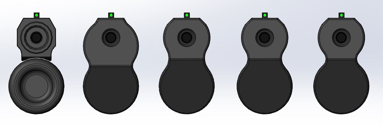

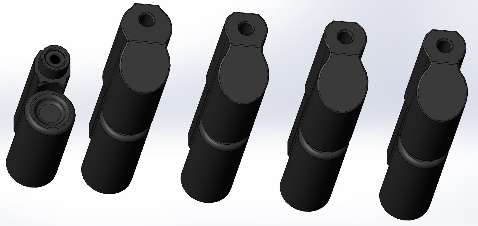

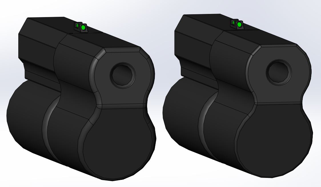

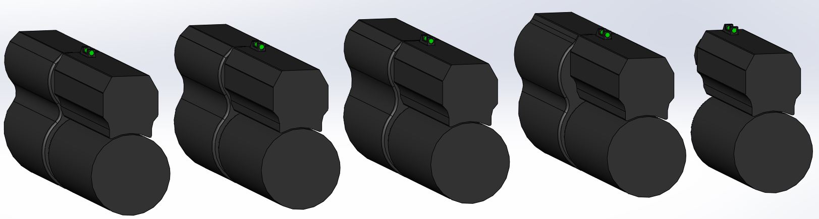

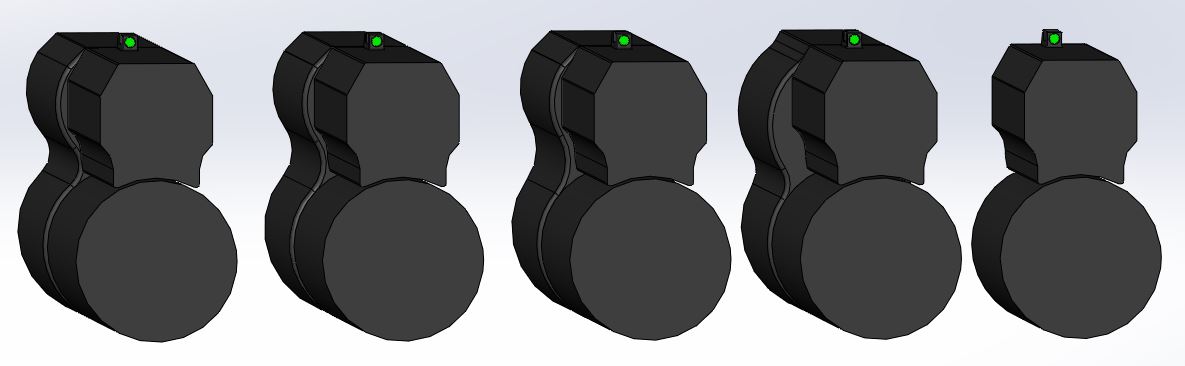

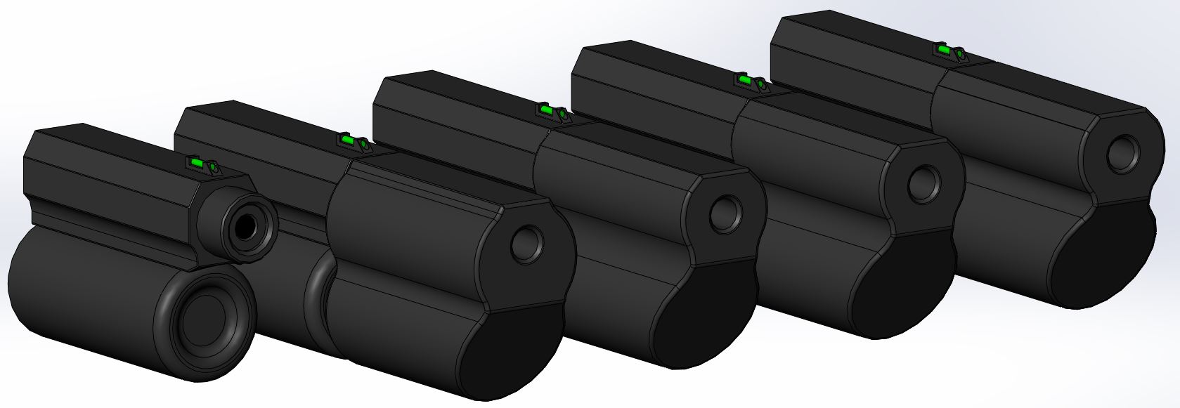

Please take a look at the shorty Huben pistol muffler shapes below. The basic shapes were suggested and negotiated by the three individuals that are driving this muffler project: The customer; the printer, and the designer (me). Matthias' quest for a muffler with looks may or may not be addressed by these, but the general size and shape was proposed by the customer.
The request was for a muffler that would be short enough to fit into a holster. It would still make the Huben pistol hearing safe, for hunting at full power. 2.75 to 3" long was suggested. All of my related models shown blow are 3" long. Other length would be possible, but I wanted to start with what was requested first.
A short muffler has the laws of physics against it, so it will need all the help it can get. To that end, expansion volume is added ahead of the pistol's air reservoir. The rebated shape below the pistol muzzle is echoed to facilitate insertion into a holster. And as a nod to styling.
Rather than a single oval shape, there are two conjoined ovals. Both for styling, and because the outer wall will have greater stiffness against internal air pressure.
So, the question is, which shape looks the best, and which the worst? Left to right; 1, 2, 3, 4 (don't count the bare muzzle).
The last two images are captured from behind, so the numbering is reversed (or refer the image number). On the rear images, note how closely the muffler profile matches the pistol. Also use that to form an opinion about which looks best.
The last three mufflers (based on the frontal image) have the same basic design, except that the fillet radius in the middle differs: The radii are 10; 7.5 and 5 mm, respectively. The larger fillet radius contains more space inside the muffler. The smaller fillet radius creates a stiffer structure.
The first muffler next to the bare muzzle model has a larger upper radius than the other three. I am keeping my opinions to myself, until I hear yours :)
The question is, which shape looks the best, and which the worst? Left to right; 1, 2, 3, 4 (don't count the bare muzzle).

Aestheticly speaking, I prefer 3 and 4.
If you ever need a design tester...you let me know 😁
I was so excited about this project, I forgot to state my preference about model 1 thorugh 4. 😆
➠ To me(!), model 2, 3, and 4 are so similar — let interior design requirements dictated what's best.
Model 1 looks nice enough that I would buy it.
However, I'm not sure how much more performance could be attained by adding a small fraction of an inch to it — it certainly isn't as pretty as the other models.
I rather add 1/2" of length to Model 1—3, and avoid the bulge of Model 1.
Only my opinion. 😉
Matthias

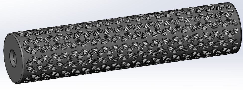

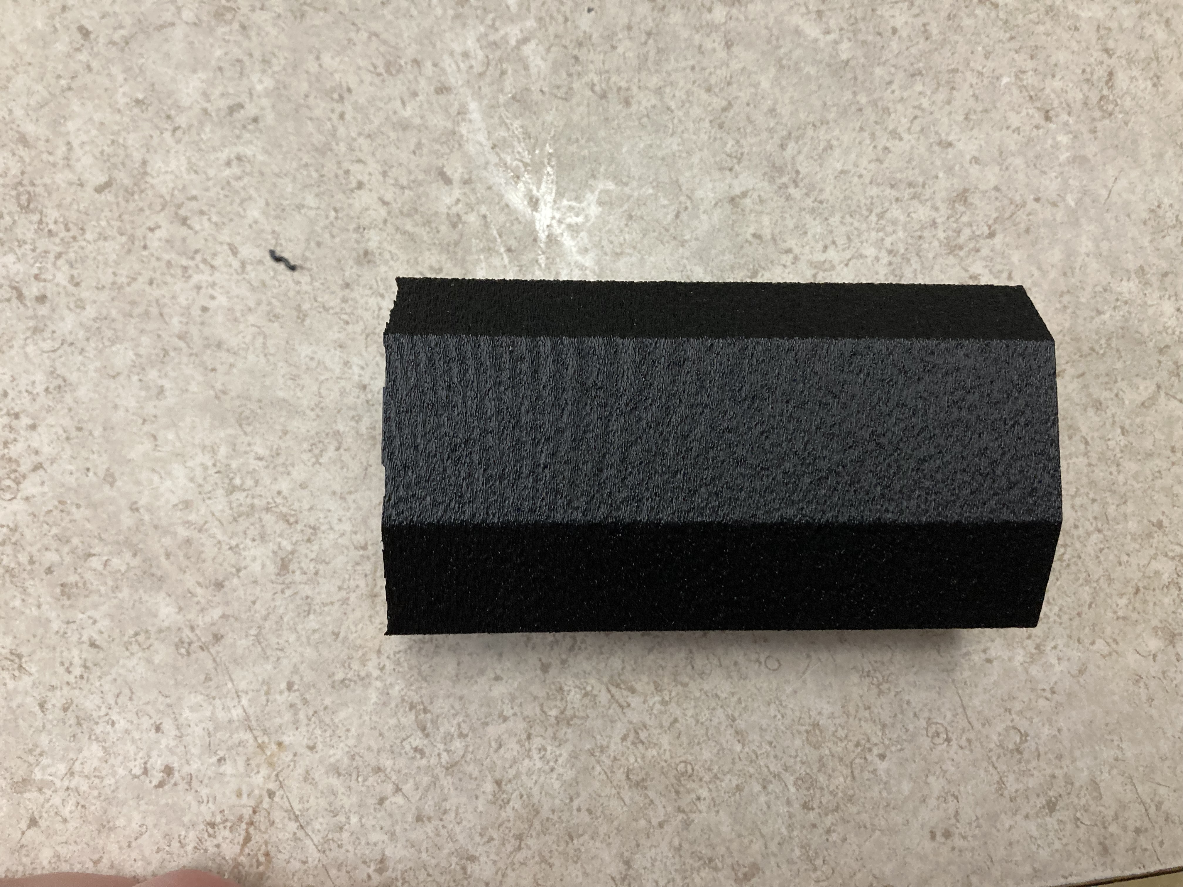

Texture helps to hide the cheap 3D printed look. BuckRail use shallow honeycomb for this.
Adding texture is relatively easy, depending on how badly you want it :) I think that the 8-section shapes shown above will take some doing, if one want to be really fancy with the texture. Then again, I am brute forcing my own texture designs, rather than figuring out how to use Solidworks texture wrap function.
I prefer texture that is pretty and functional, such as the embossed triangles I used for another guy's muffler. Can't show you the internal structure, as he was adamant about that.
As for taking your money; do I have a bridge to sell you :)

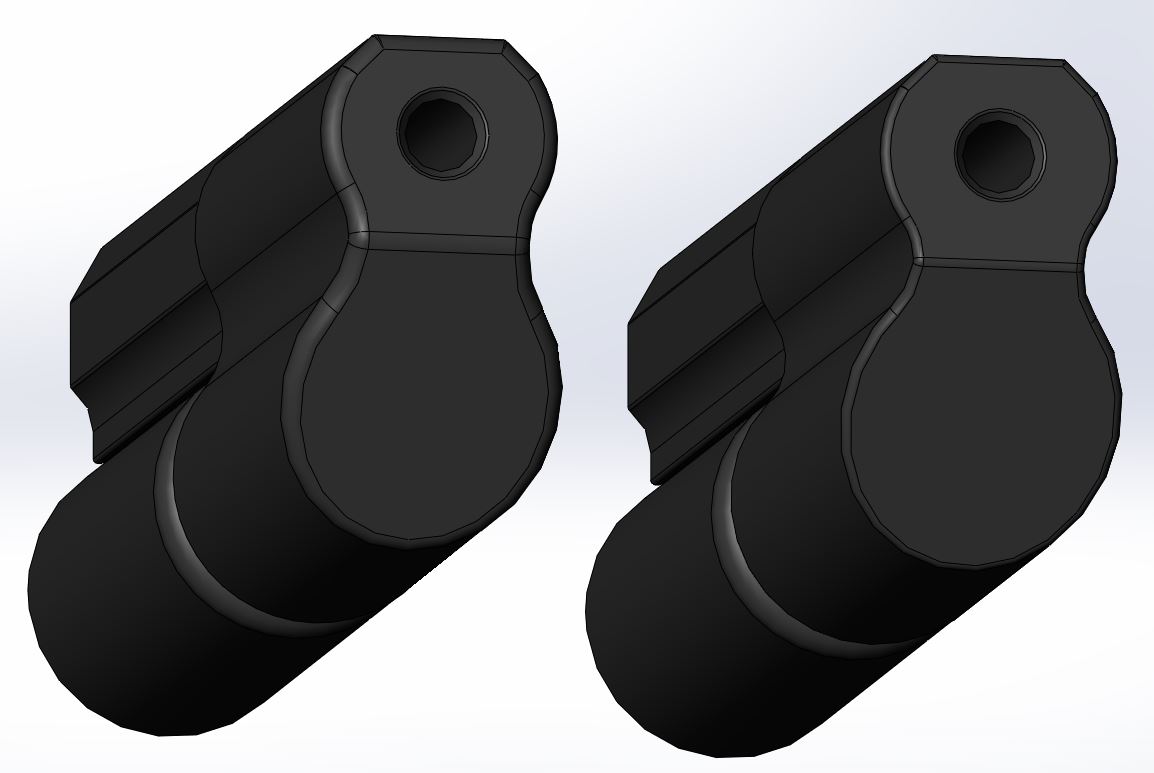

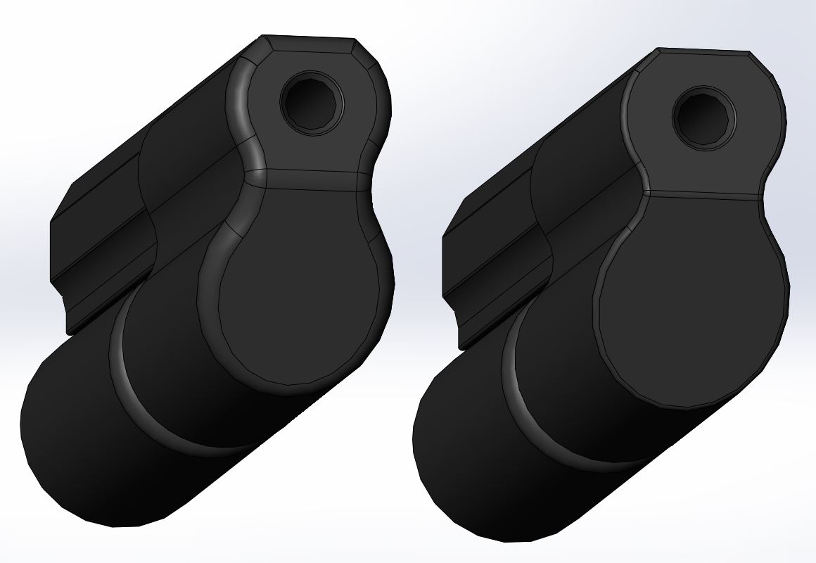

What about larger front face corner radii? Easier to get into a holster, and echoes the look of the air tank. Makes the Muffler look a little less bulky too.
The images below have the second and third muffler compared. The third one has the corner radii kept at 1 mm. The second muffler has the frontal corner radius increased to 2 mm; then to 3 mm.
Which looks better?
For reference, the 1.5 OD by 5" long offset muffler M0ist0ne printed (above) has a 2 mm front corner radius.

Yeah, a honey-comb pattern has a special place in my heart (and I don't even eat honey).
But that triangle-shaped design looks already very good.
✅ One more box checked off on the way to buying your bridge, my friend.

I prefer 2,3&4 over 1. #2 seems to conform most closely to the shape of the muzzle. It is unfortunate that the gap between the expansion chamber and tube cannot be covered by a flange due to the method of attachment. In the absence of that, I would suggest looking at a design that has a recessed expansion chamber with the size of the recess matching that of the differential between muzzle attachment point and tube. Forgive the crude schematic!:
I’m not a fan of the angled expansion chamber end and don’t see that fitting the aesthetic in the bigger picture. In my mind, a flat expansion chamber end would (1) conform better by drawing less attention to the gap and (2) improve volume. However, perhaps it is a key element of fitment into generic holsters.
