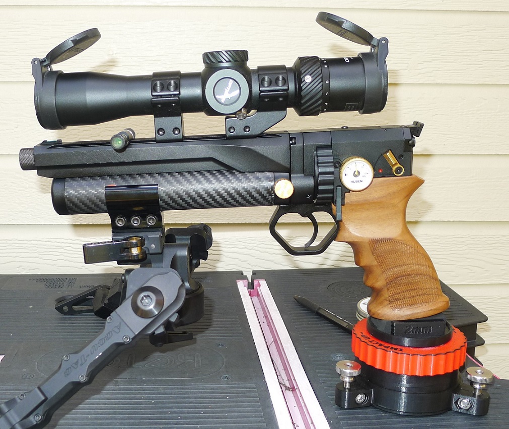

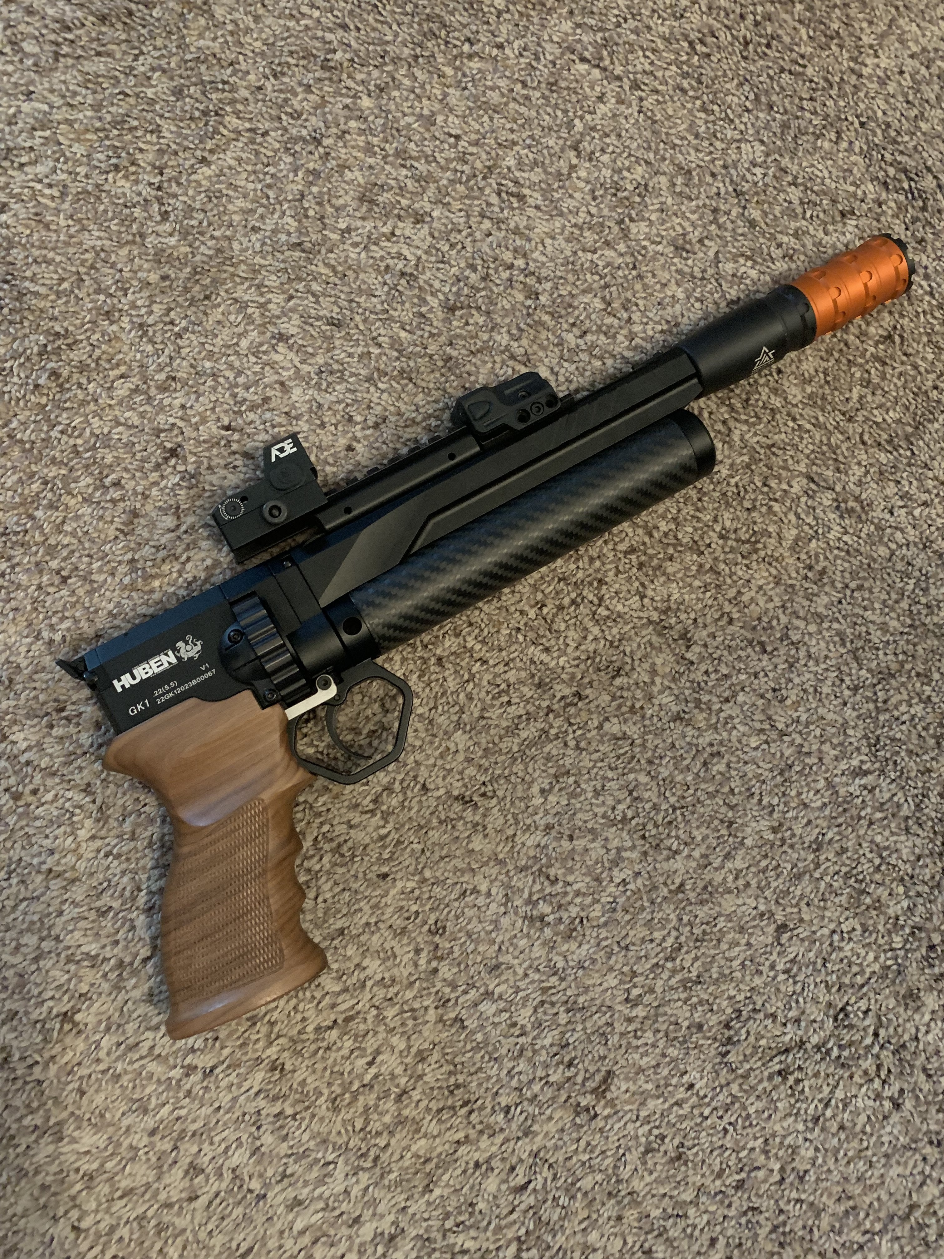

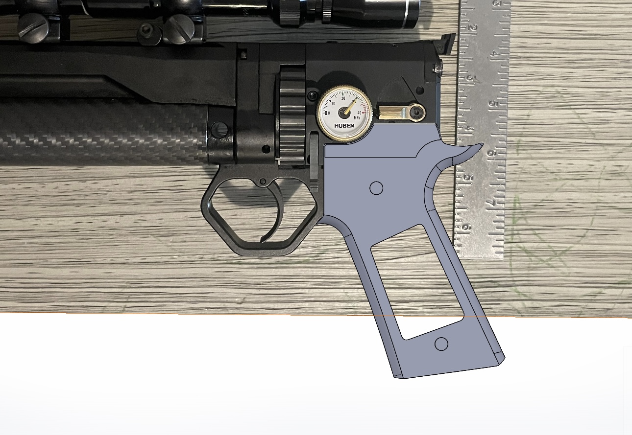

My buddy designed a 1911 grip for the gk1

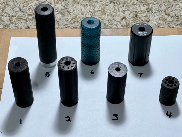

I'm going to be testing some mini moderators on my GK-1 after the storm moves through, but here's a preview of what will be tested:
These range from between 4" and 1 ½" in length and 25mm to 31mm in diameter.
1. Standard 4 baffle: 3" Long 25mm diameter
2. Standard 4 baffle with holes drilled in the end: Same dimensions as #1
3. Standard 3 baffle 2 ½" long, 25mm diameter
4. A compensator I found on Thingiverse. No baffles but it is ported on the top to reduce muzzle jump: 1 ½" long 25mm diameter
5. My friends design, 4” long, but only 2 baffles: 4" long 1 inch diameter
6. The STO experimental one I bought a couple years ago: 2 ½" long 321mm diameter
7. One section of the Huma MOD30: 2 ¼" long 30mm diameter
I have a cheap Amazon db meter I'll be using to record the peak sound level from each. #6 and #7 render the iron sights useless due to the diameter blocking the front sight. All the rest retain the use of the iron sights.
and the results are in...
Bare Barrel: 117.7db
1. 110.2db
2. 110.8db
3. 111.1db (Matched #6, the STO Brevitas)
4. 115.2db
5. 111.5db
6. 111.1db
7. 114.0db
8. 108.2db - this is the MOD30 with 3 sections!
The small 3D printed LDC is only 2db louder the the 3 section MOD30, and only a ¼ the size! Who says big things can’t come in small packages?
Here they are in rank order, quietest to loudest!:
1. 3D Print 4 baffle design
2. 3D Print 4 baffle design with 8 holes drilled in the end
3. 3D Print 3 baffle design
3. STO Brevitas (tied for 3rd place)
4. My buddy’s 4” long 2 baffle design
5. Huma MOD30 - 1 section
6. The 3d print compensator
I’m no sound engineer and can’t say I really understand the mechanics of sound, but I will tell you the difference between a bare barrel blast of 117.7db and 110.2db from the 3D Printer 4 baffle LDC is huge! Hard to imagine 7db makes that big of a difference! Or, maybe it’s just the cheap Amazon db meter I’m using!

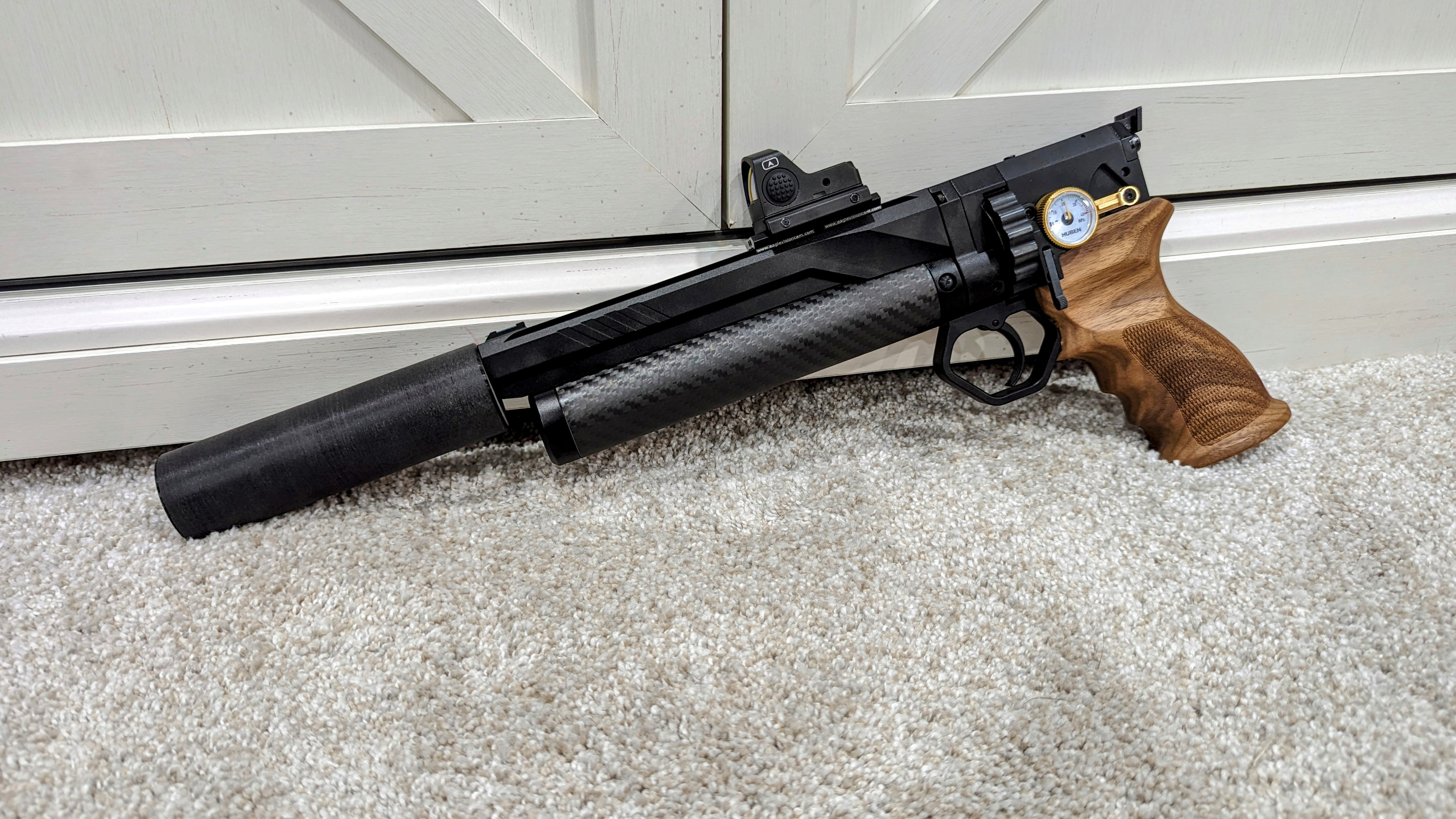

Thanks for the image, and for making and testing the muffler, M0ist0ne.
It seems I managed to match Gregor's 26 mm OD coaxial muffler in terms of sight clearance. Usable, but perhaps not ideal. Your feedback about that would be appreciated.
My intent with this design was to make it "strong enough", as there is no aluminum or CF outer tube. Also; to make the Huben pistol hearing safe, rather than backyard friendly. there may be room for thinning out walls and adding baffles, to reduce dB, but that would need to be approached cautiously. The 8.5" long version of this 1.5" OD offset muffler would no doubt be noticeably quieter. And where does the 6.5" long oval muffler fit in...
