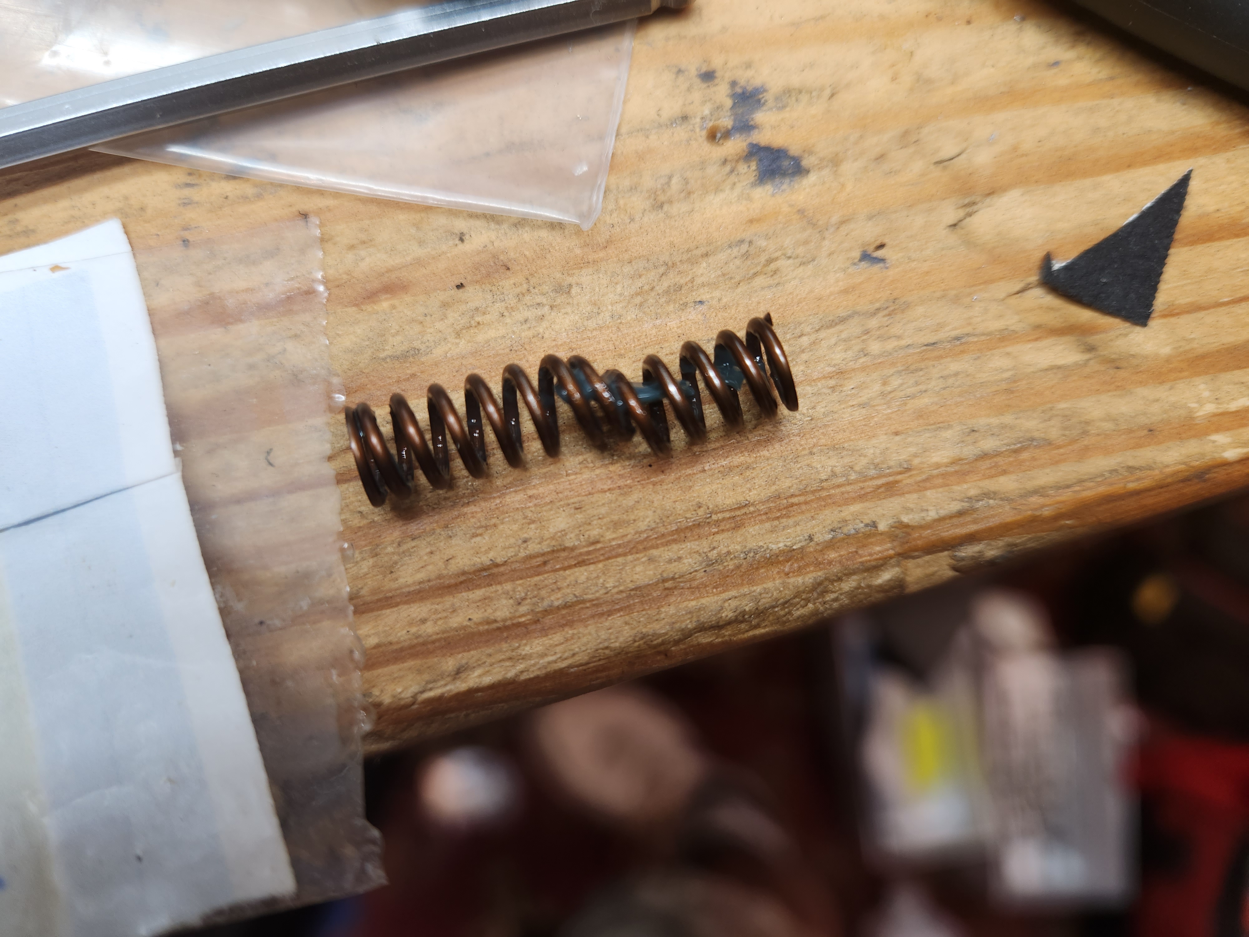

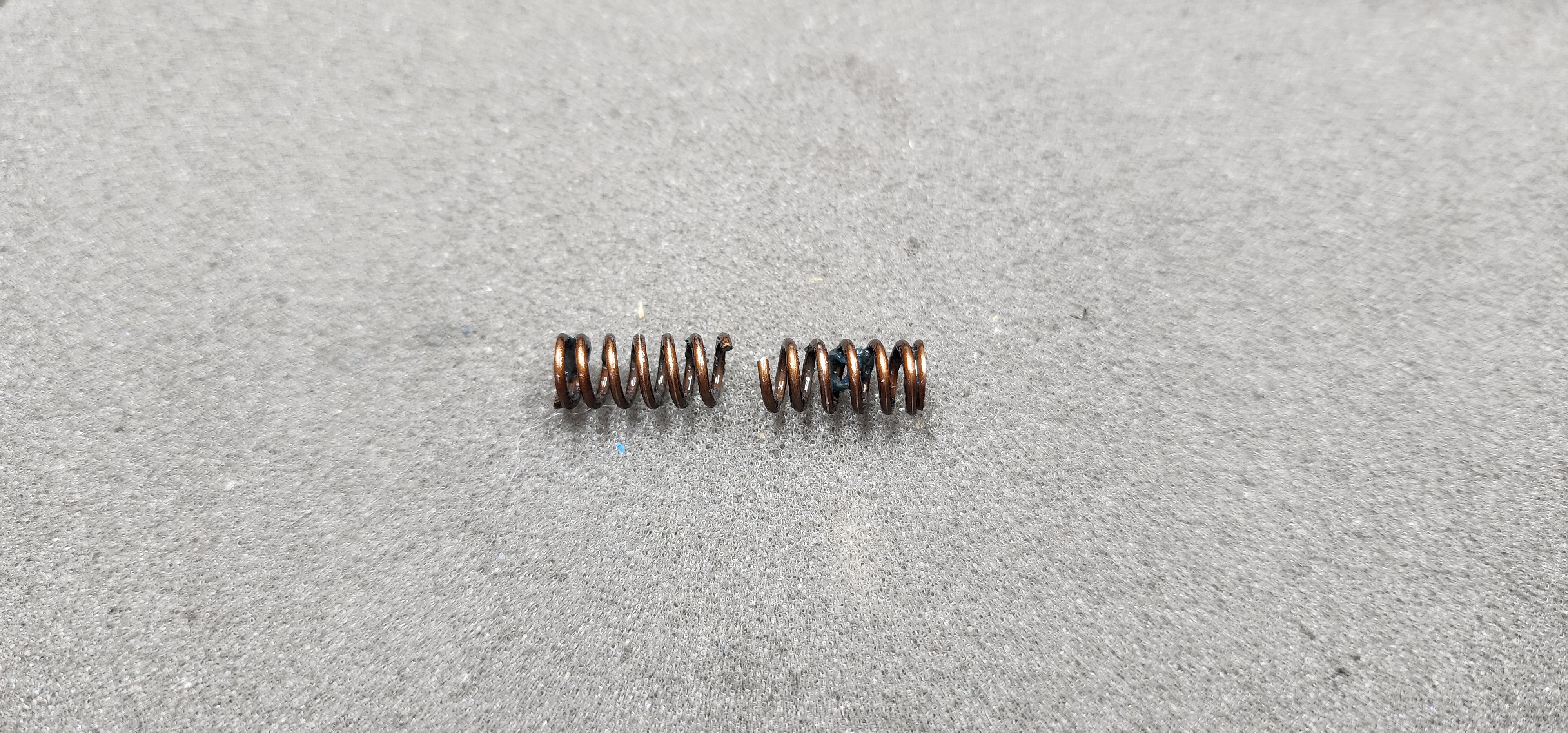

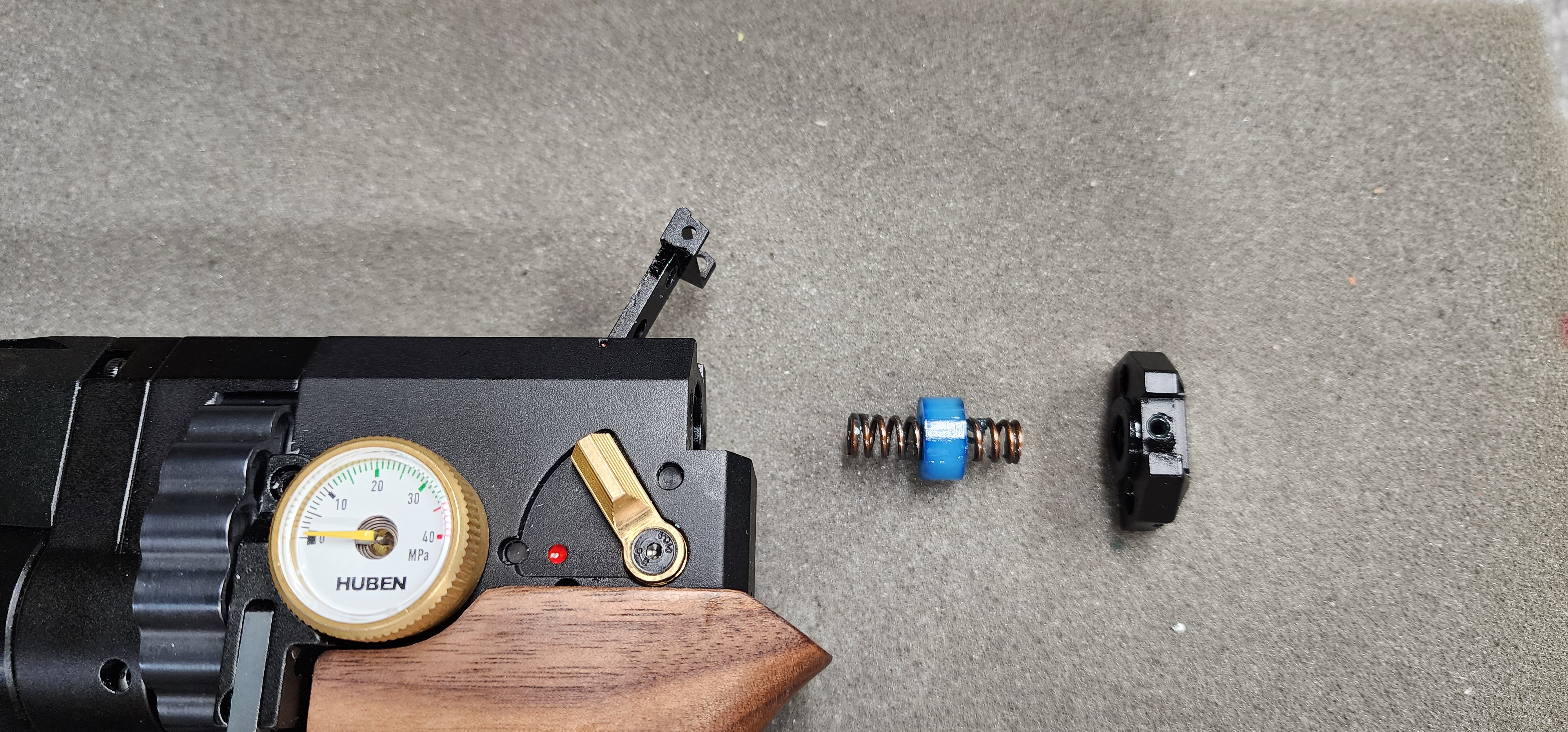

I had my first malfunction yesterday after about 5000 rounds. the gun just dumped air from a almost full fill in the middle of a shot string and would not hold air when i tried to refill it was just venting out the barrel. It ended up being a broken stiker spring , many thanks to New England Airguns for there troubleshooting with me. also upon there recommendation i swapped out the blue striker buffer for the white one that comes in the parts kit, as the blue one was a very snug fit on the spring and there should be a little movement there.
I had a similar thing. But mine was functioning fine. The blue thingy is too tight. My spring was mangled. I only discoverd it when i degassed to replace cylinder lever. I put the spare spring on and the white thingy. No other issues.

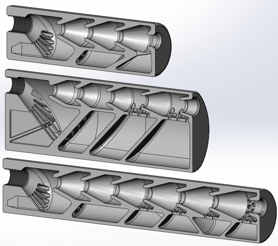

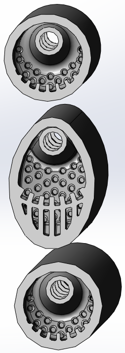

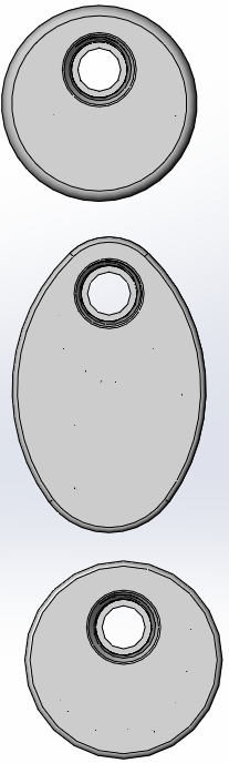

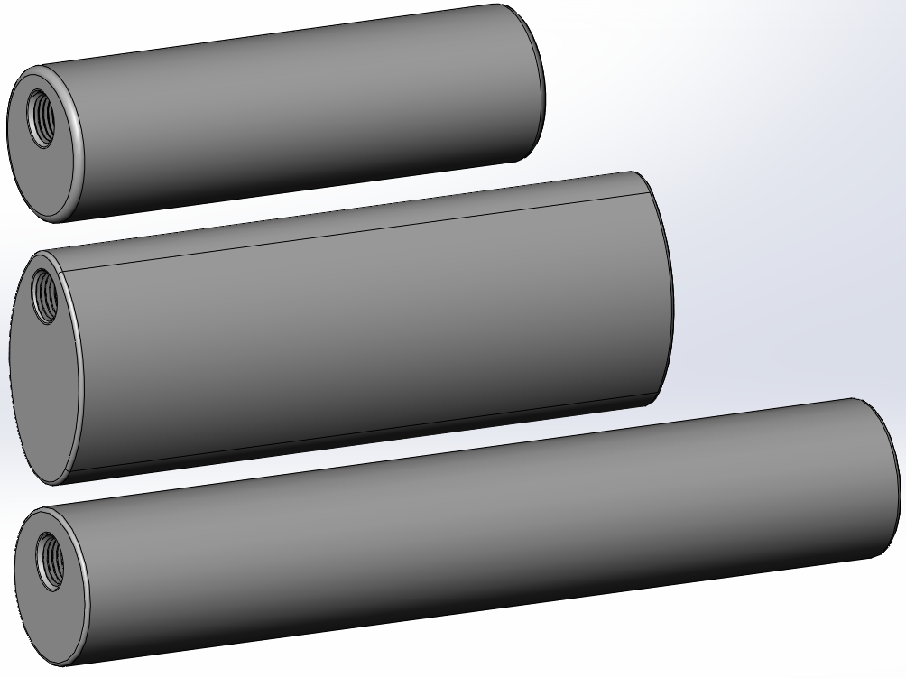

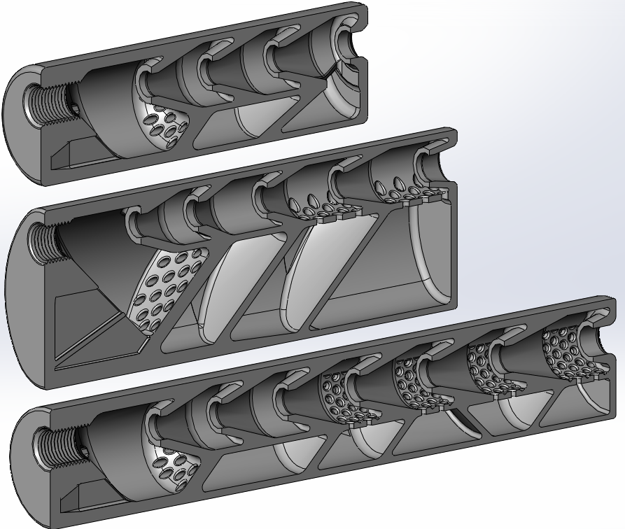

I had a request from the same guy for an oval offset muffler for the Huben pistol, with more sightline clearance. This one was to be 6.5" long and 1.5" at the widest point. Images of the latest oval muffler, next to the original 1.5 OD x 5" and 1.5 x 8.5" offset cylindrical versions appear below.

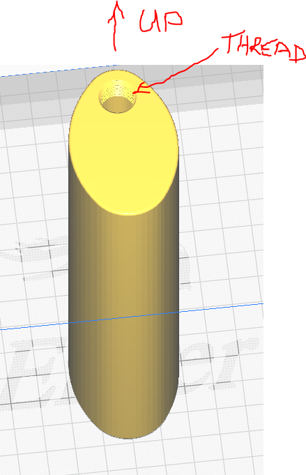

The STL file for the oval offset muffler is attached to this reply in a zip file. STLs for the other two were posted a few pages back. Remember to rotate the part in your slicer so that the front face is on the platen, and the threads are pointing up. Only that orientation will print correctly.
Remember that these are experimental designs, that you may print and test at your own risk.

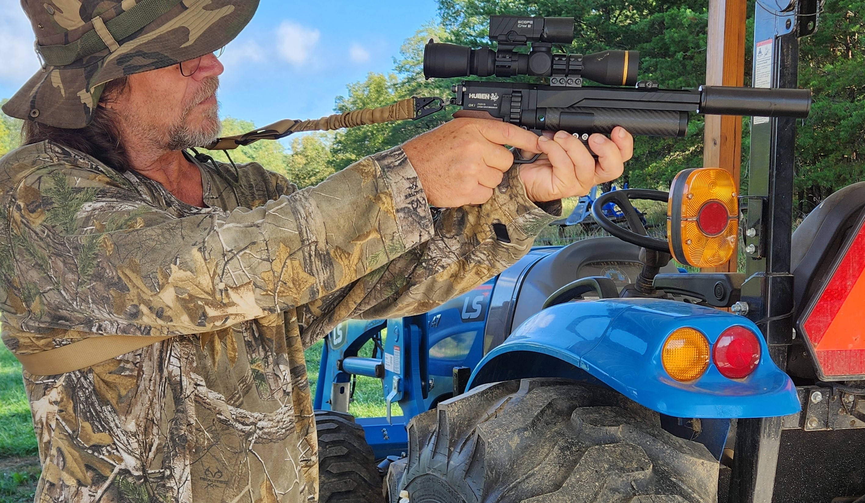

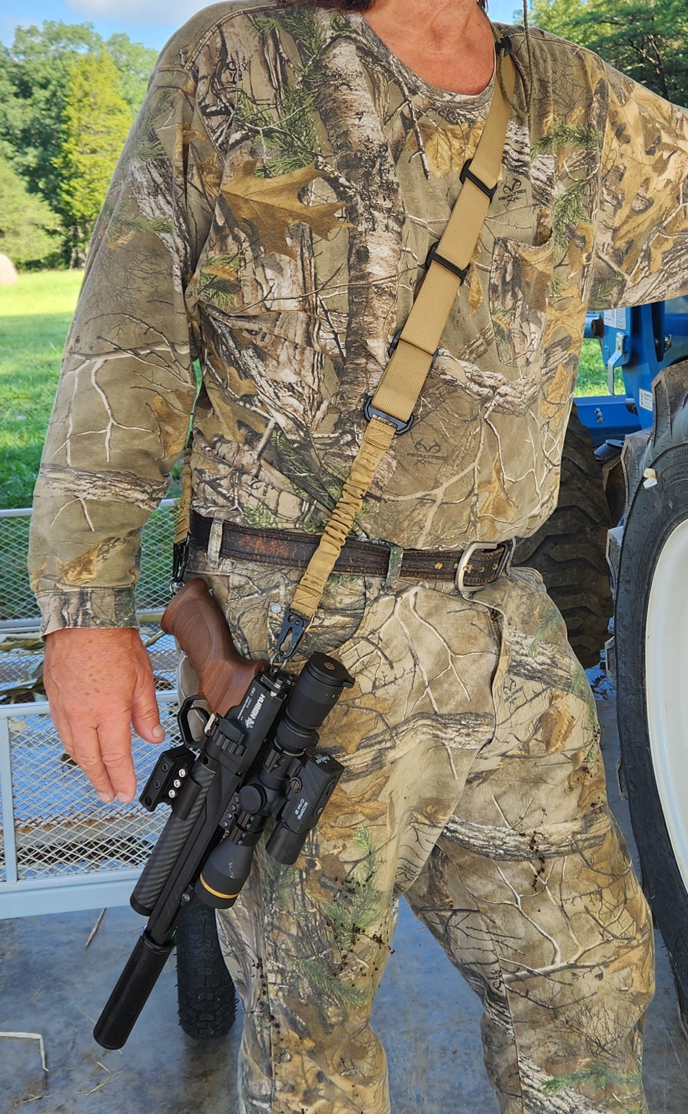

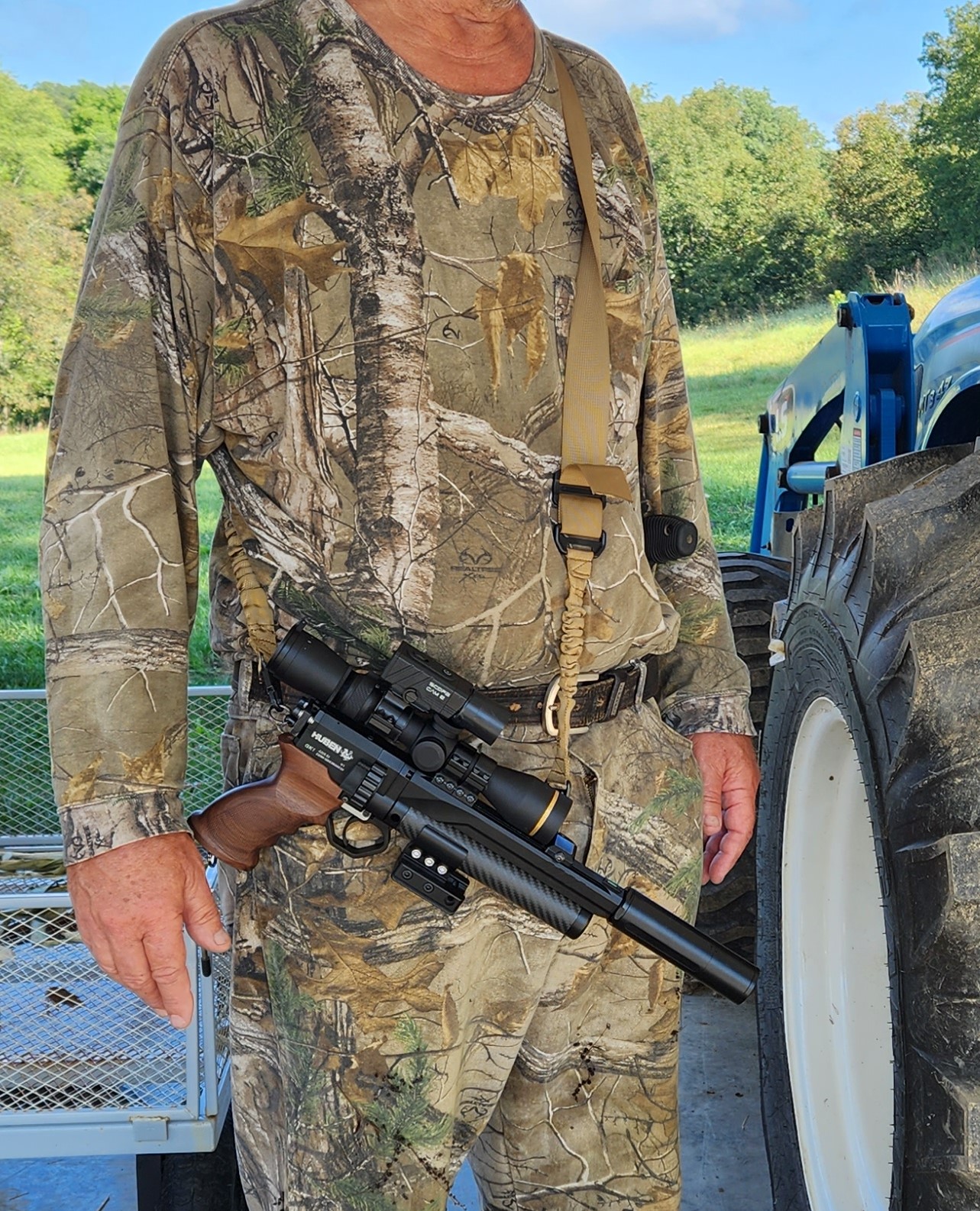

Set up as is now.( way too much stuff attached,LOL). For carrying most comfortable for me is. Sling attached to the front of the shroud and to the back of the receiver below the rear sight. Photo below. But I am not sure sling attached to the shroud is a good idea. But probably will carry it this way when hiking in the squirrel woods. Trial & error. Carrying any gun, has to be comfortable and readily accessible of course. :)
For use as a shooting brace best for me is attached to back of receiver below rear sight and bottom of grip. Sitting,arms over knees killed one groundhog at 45 yards using the sling as a brace. Below using sling as a shooting brace, helps a lot.
Carrying it w/sling attached to the rear receiver and bottom of the grip is ok,(photo on bottom) but the pistol flops around too much. But both ways are super quick to have pistol from carry to shooting position. However, I generally keep my right hand on the grips anyway, when hunting. Once I shed the scope & camera, probably will go with some kind of holster. Got 4 groundhogs so far with it.
View attachment 388007 For use as a shooting brace best for me is attached to back of receiver below rear sight and bottom of grip. Sitting,arms over knees killed one groundhog at 45 yards using the sling as a brace. Below using sling as a shooting brace, helps a lot.

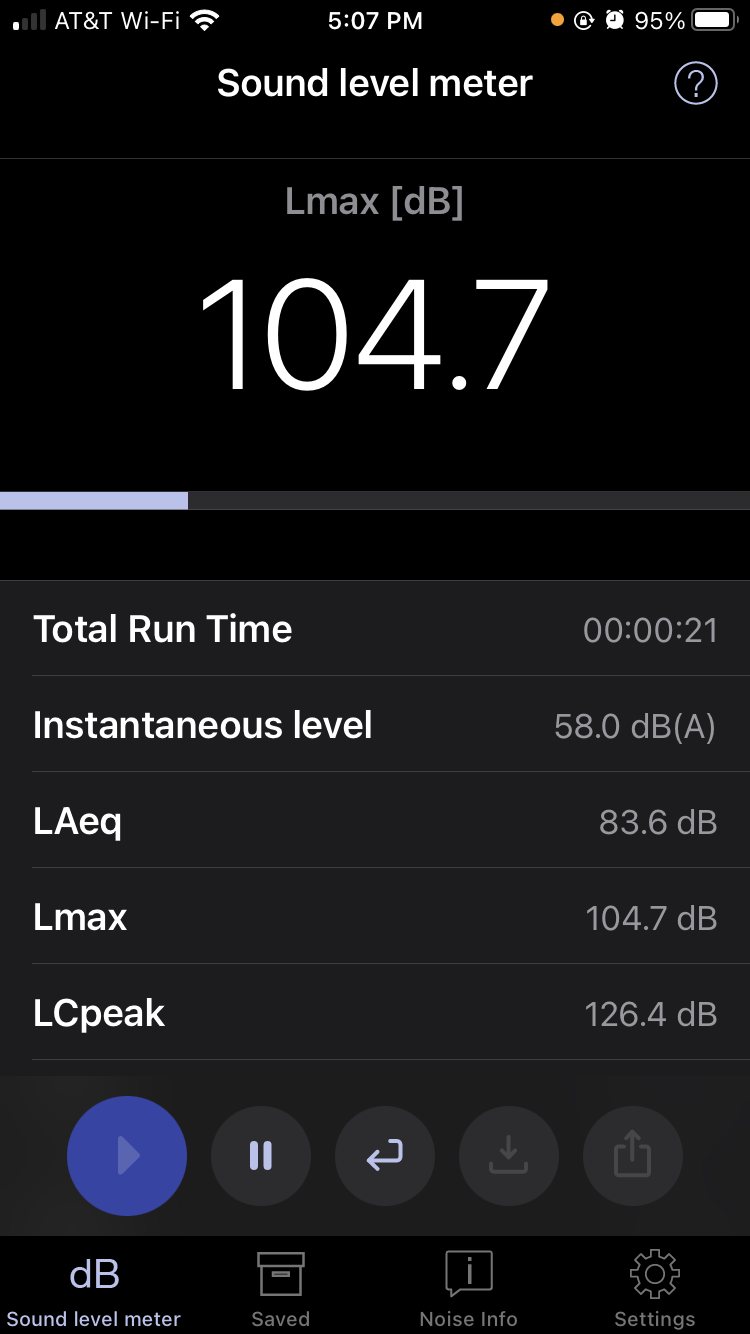

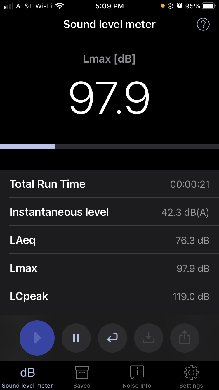

@subscriber I got a 6.6dB (average) reduction with the original 5” version of your moderator shooting at somewhere between probably 50-55 ft-ibs.
104.5dB > 97.9dB with 33.95 gr pellets.
I’m guessing those who are getting much better results are running at lower power levels.
