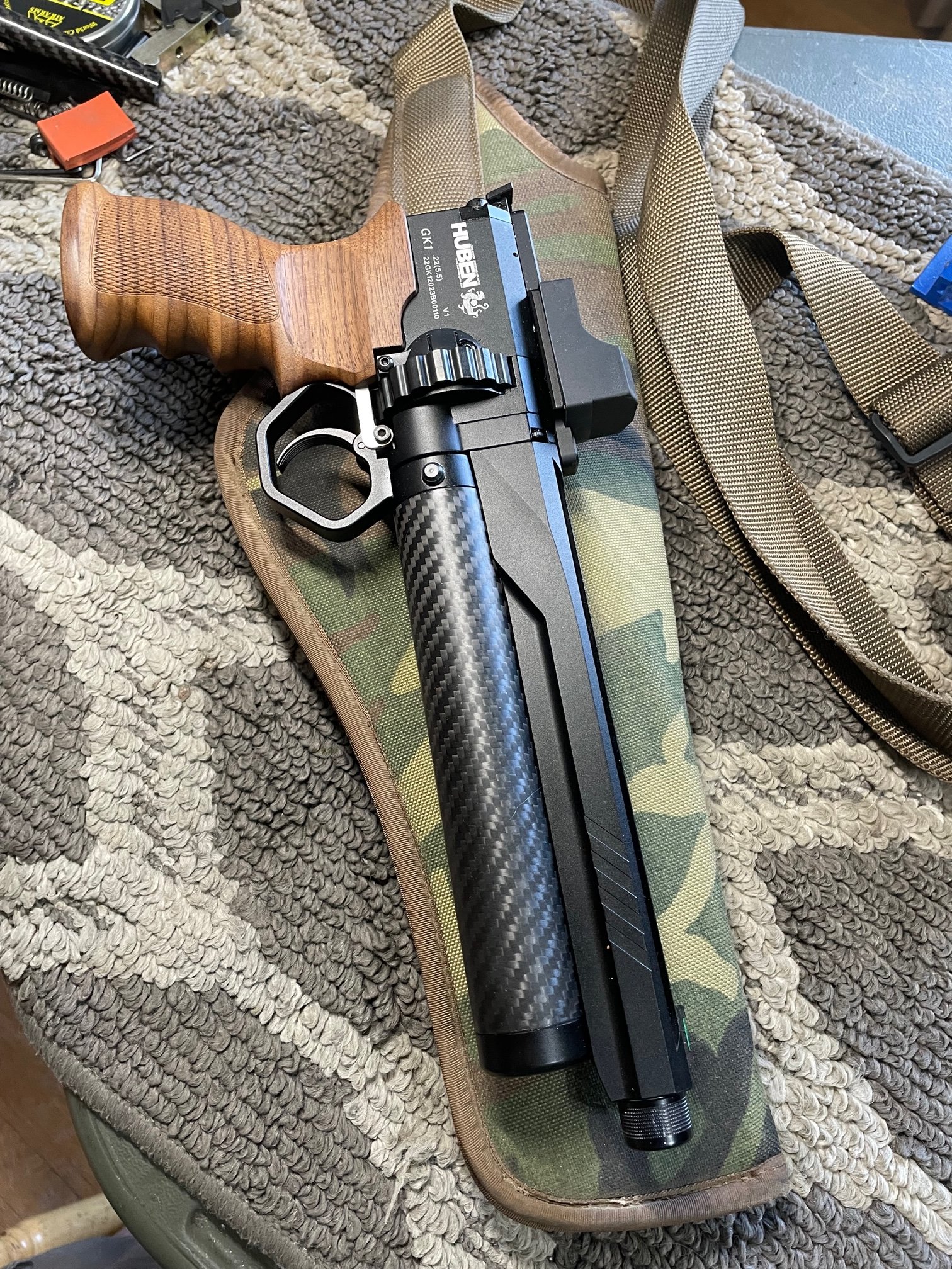

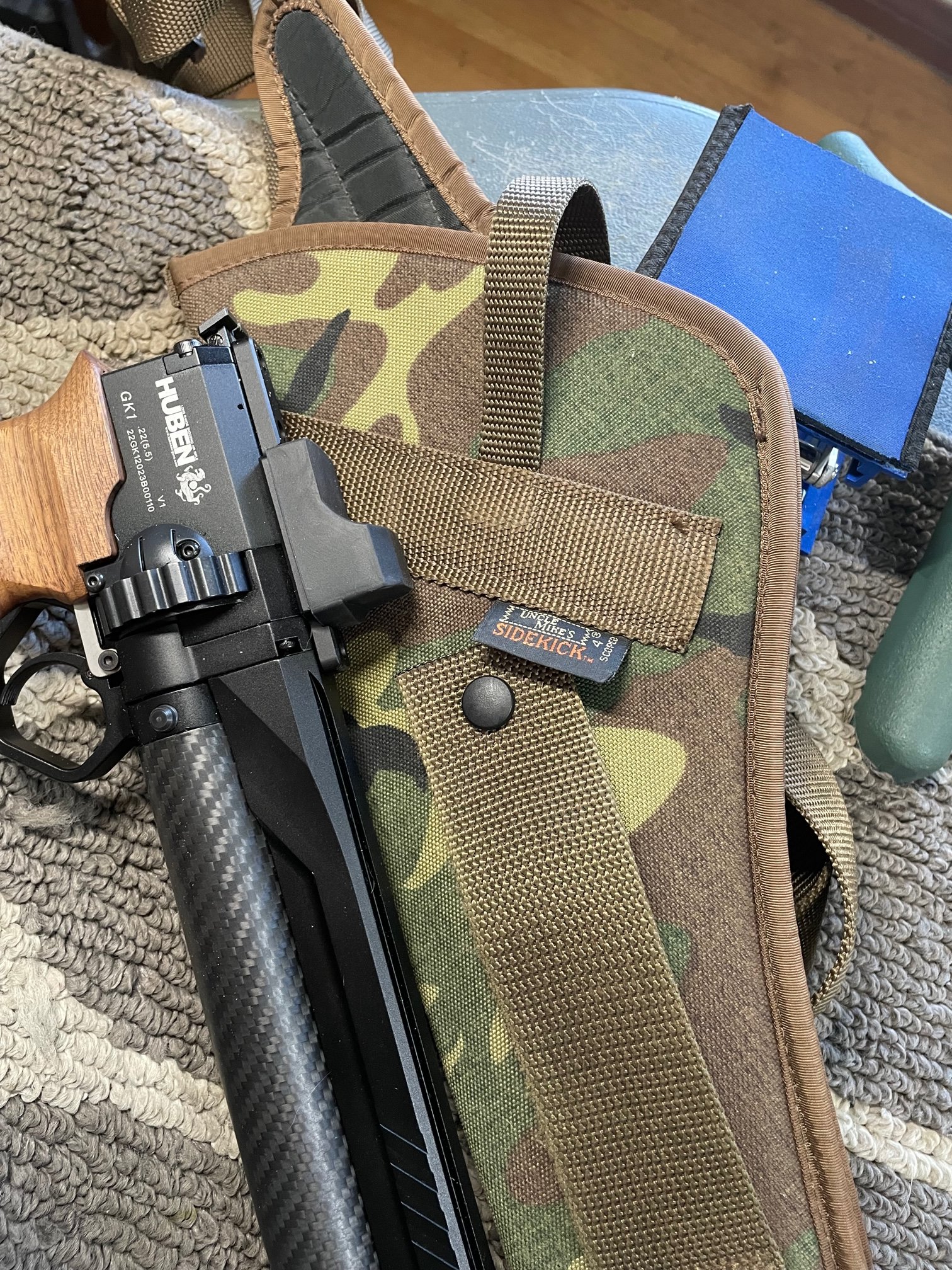

Just for kicks, I tried my scoped S&W model 29 holster for 8 3/8" barrel. I think this shoulder rig will work for me.
That is so far the best option for field carry I've seen. I've never been focused on any pcp ever like this, referring to a way to carry it. Never had to figure out a holster. Thank you for the info

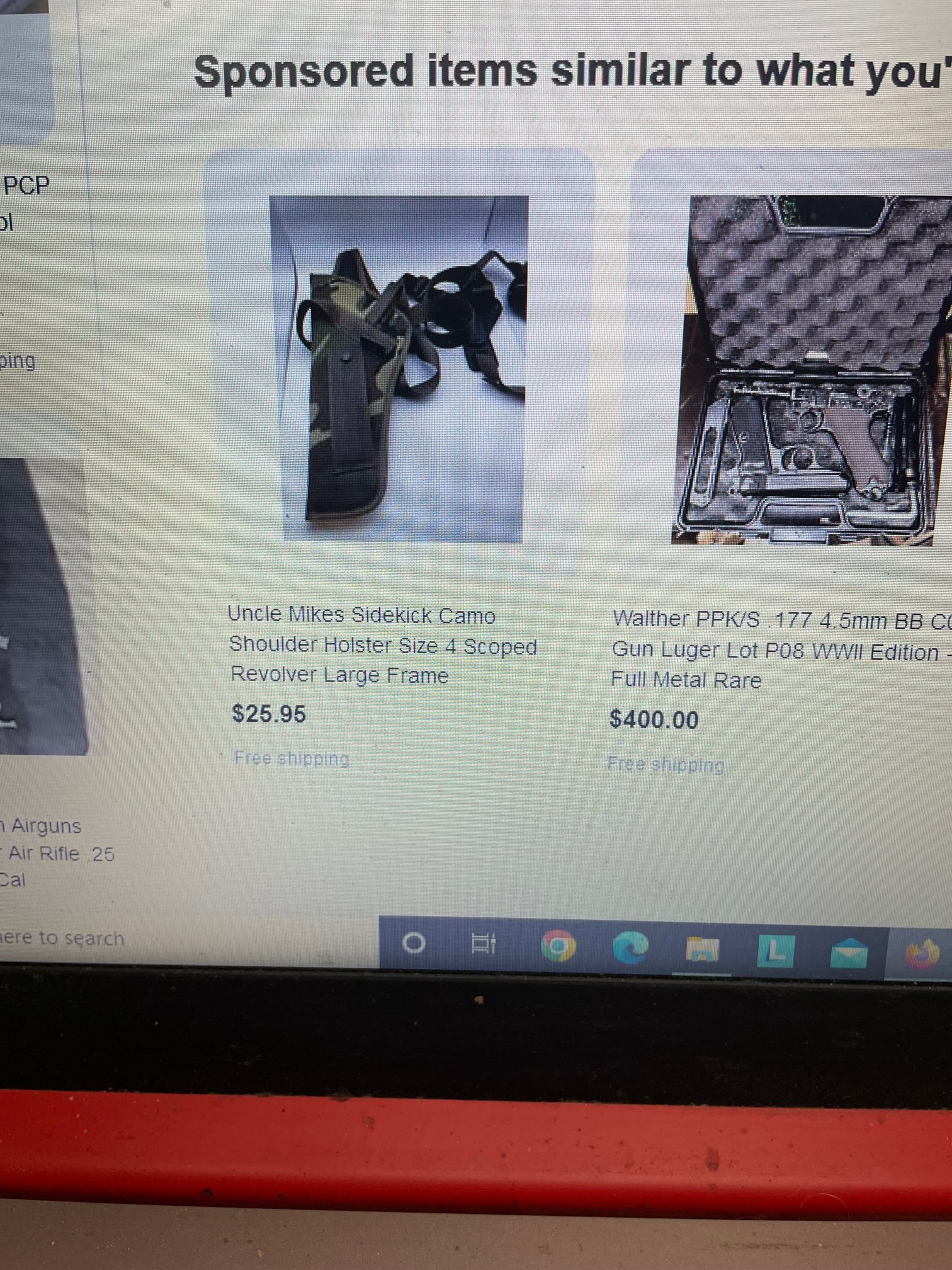

For the shoulder holster, is this the same one in black for $26.90 on eBay? Or is there a better place to buy?
Shoulder Holster for S&W 29 & 629 8 3/8" BARREL
I don't even have the pistol yet (can't decide 22 or 25??). But you can never be too soon to start buying the accessories..lol.

True it's best to start right away lol, I understand completely I'm the same. I have no idea yet about the holster I was commenting on the one in pics and it may the one I go with. But I went to Uncle Mike's site to look

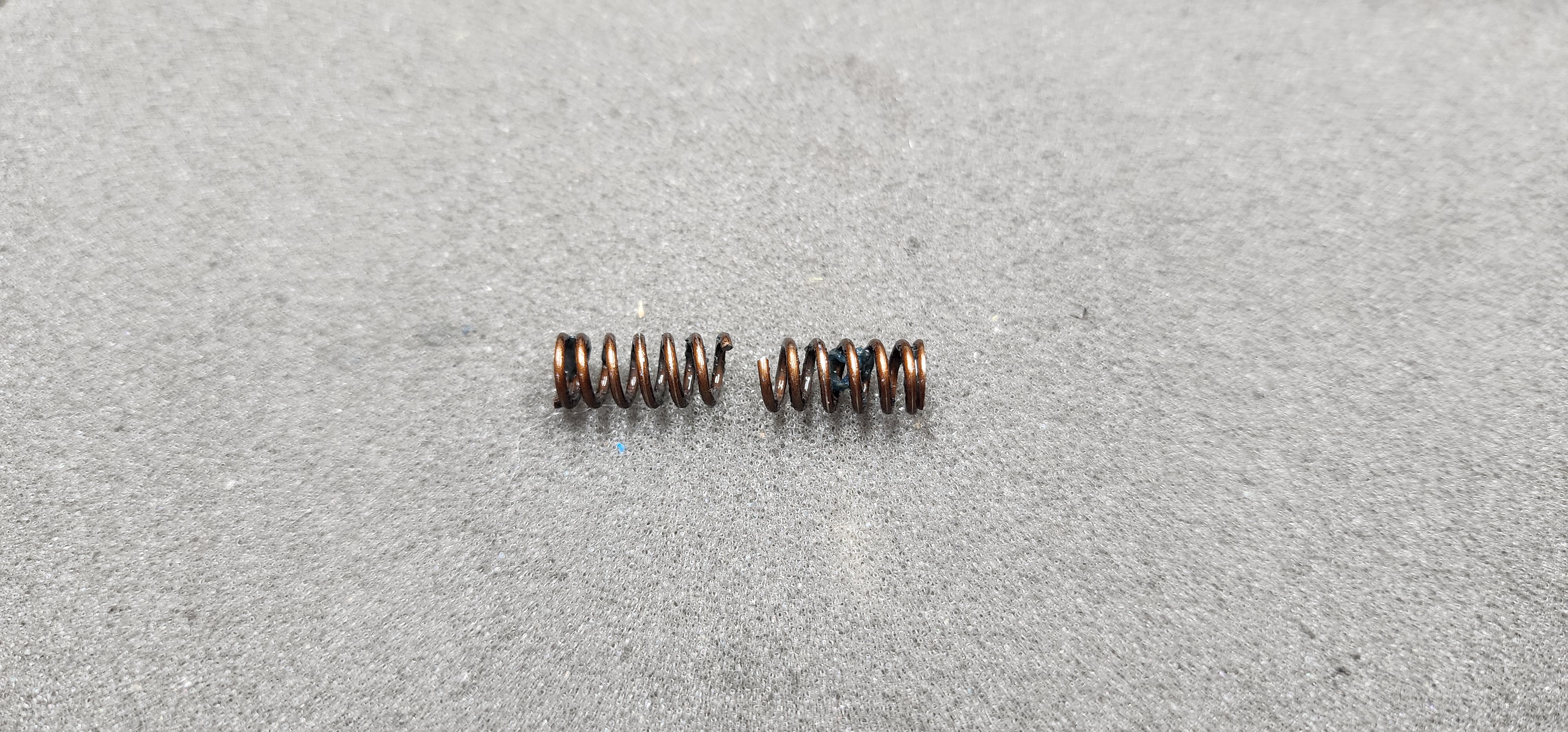

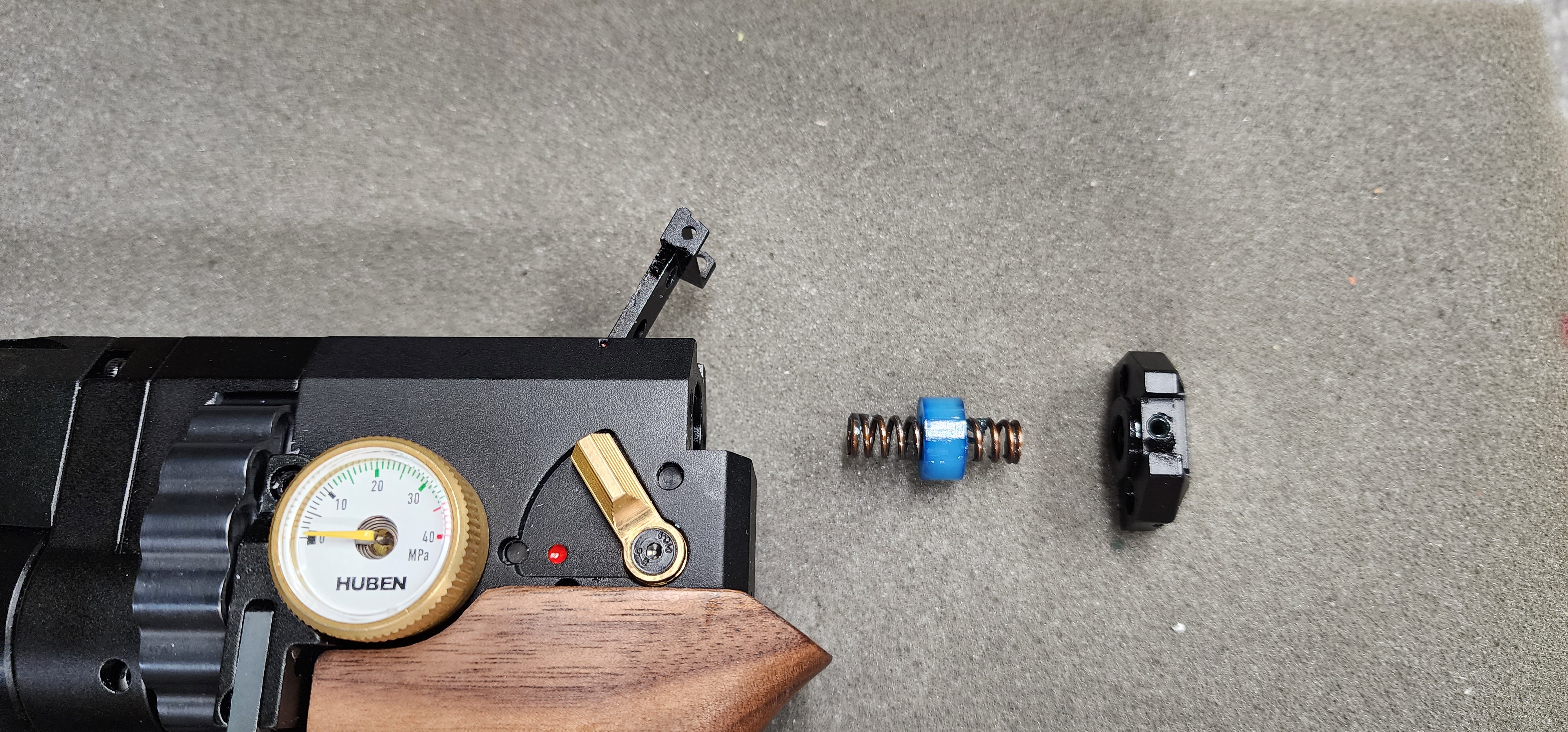

I had my first malfunction yesterday after about 5000 rounds. the gun just dumped air from a almost full fill in the middle of a shot string and would not hold air when i tried to refill it was just venting out the barrel. It ended up being a broken stiker spring , many thanks to New England Airguns for there troubleshooting with me. also upon there recommendation i swapped out the blue striker buffer for the white one that comes in the parts kit, as the blue one was a very snug fit on the spring and there should be a little movement there.
Thank you for the post this is good to know
