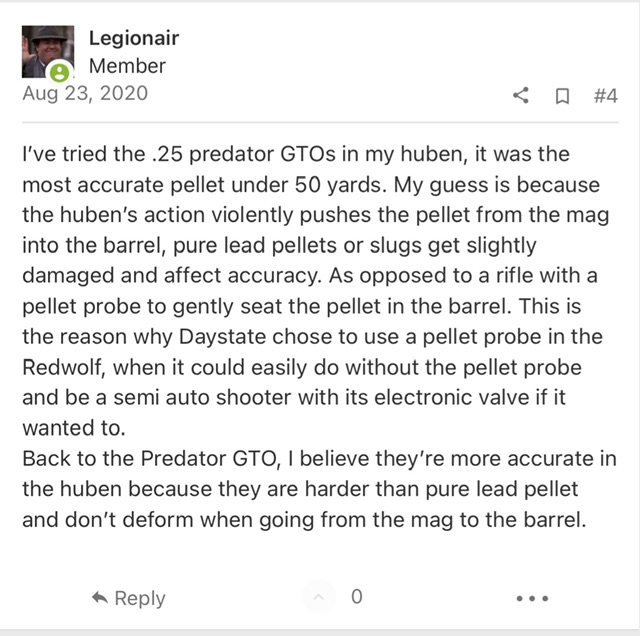

I found out about the superb accuracy with GTO’s, in my K1, three years ago. Good to know someone else found that out too. And I’m confident it’s for the same reason you mention.
Reactions: Ezana4CE
Wonderful, legionair - thanks for letting me know! Hopefully, a few people here will try them in the pistol. I do a lot of shooting into duct seal, which gets very soft in the sun and will soak up even lead pellets without them getting deformed. Shooting from the K1, I can often see head or skirt damage with lead pellets, which must come from the gun. The GTOs just have perfect rifling marks.
