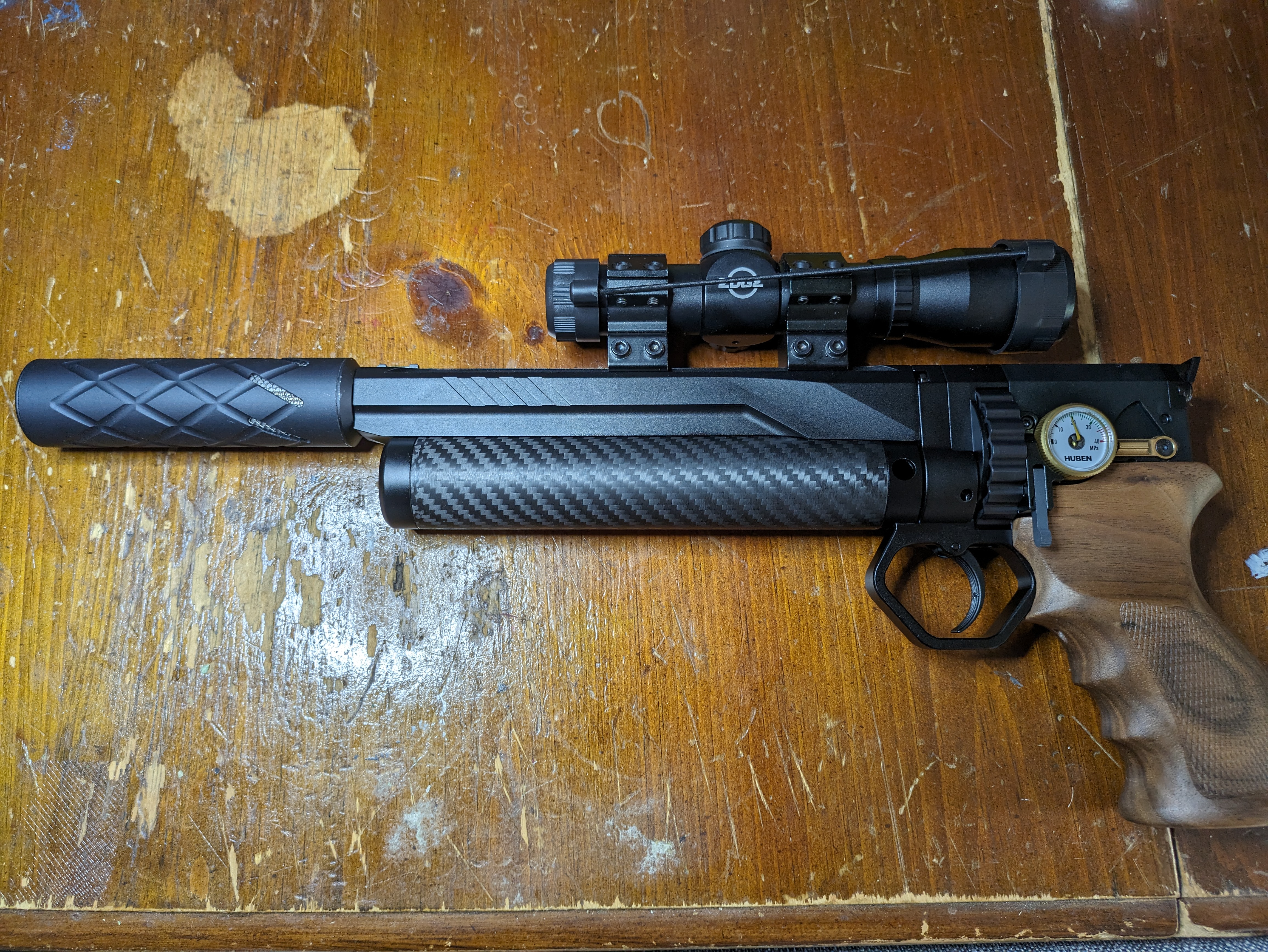

With this one I need to thin the herd , I don't see me shooting the others much anymore. It needs a LDC for sure in the back yard ,,

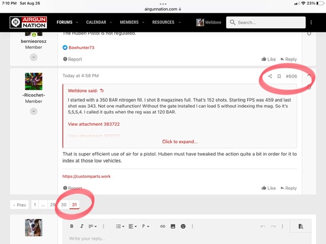

I started with a 350 BAR nitrogen fill. I shot 8 magazines full. That’s 152 shots. Starting FPS was 459 and last shot was 343. Not one malfunction! Without the gate installed I can load 5 without indexing the mag. So it’s 5,5,5,4. I called it quits when the reg was at 120 BAR.
That is super efficient use of air for a pistol. Huben must have tweaked the action quite a bit in order for it to index at those low vehicles.

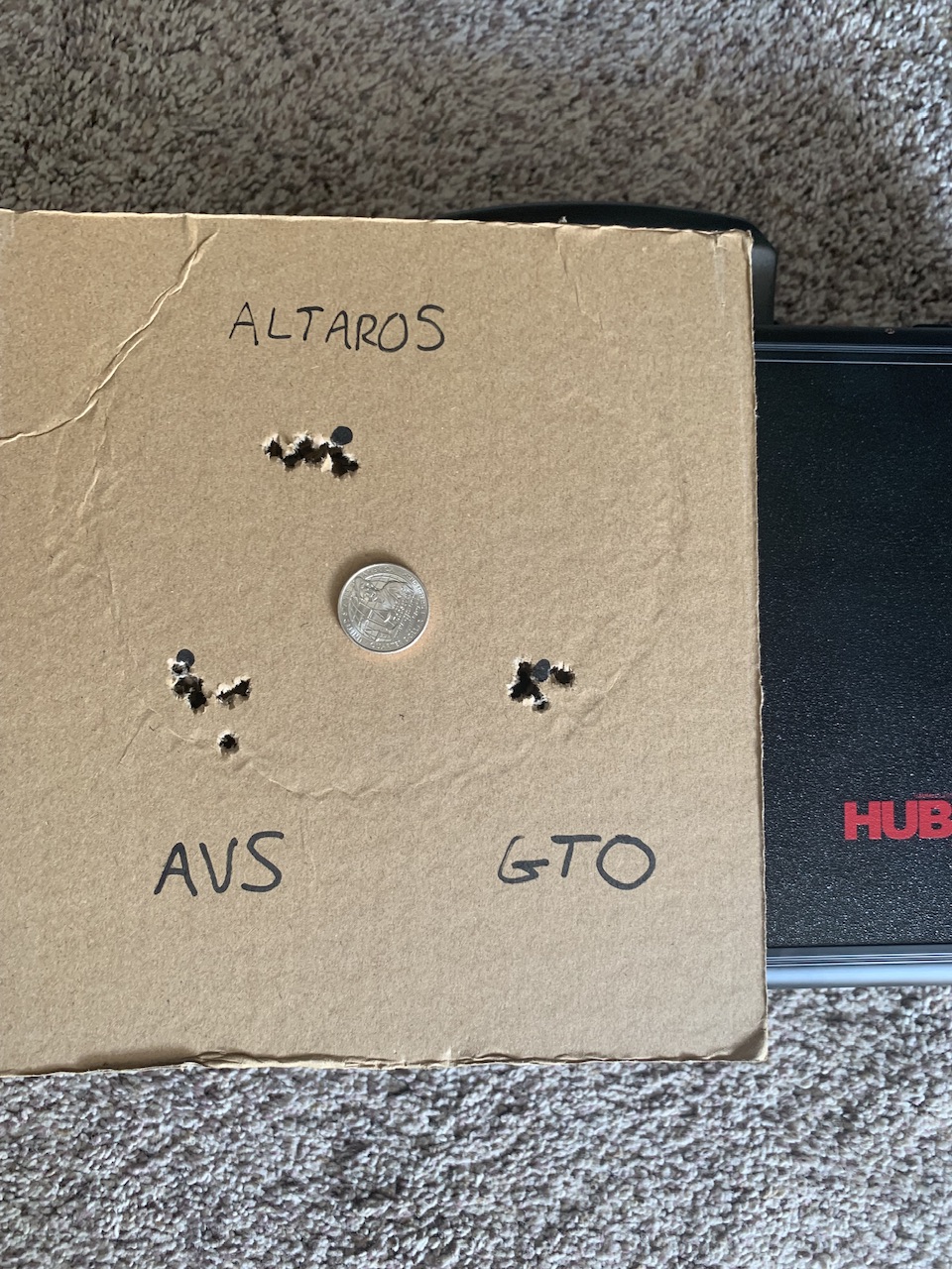

I had the first chance to test mine out properly in the desert where neighborly relations wouldn’t be strained! I wanted a solid sense of its accuracy before I decide on an optic, so it was temporarily fitted with a pic rail adapter and a 5X Vortex prism optic. It was supported solidly on rice bags for the testing and I used a bubble level stuck on top of the action to prevent error from cant. Short of clamping it in a vice, I consider this to be a very solid “benchrest quality” test. I tried three types of ammo that I find to be the best in my 22 K1 rifle: Predator GTOs, AVS 22 grain .223 dished slugs and Altaros ATP 36 grain Huben slugs (also .223). For the record, I find the GTOs to outperform any lead pellet in the rifle. I attribute this to their hardness, which I think prevents deformation during the transition from mag to barrel. Lastly, I cleaned the barrel between each ammo type with my quick and easy method:
With each ammo, I first found the pressure bounds that gave tight SDs at my target speeds. 890 for the GTOs and AVS slugs. Tapped out, the heavy Altaros were shooting at 800 and I tested those for accuracy tethered at 260bar because I didn’t have the means to go higher and speed was descending from that pressure. That’s 50fpe and with no mod, it’s a thunderclap. Maybe a bit more juice can be squeezed out with a compressor fill but I only had a tank available.

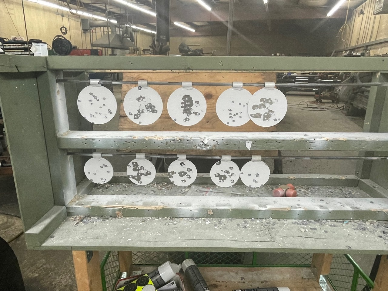

Ok, enough nerdy details. The accuracy testing was at 55 yards with 8 shot groups. No wind, no fliers to blame on the gun, doin my absolute best. Even with the Altaros, it’s a peach to shoot and I had no issues with jams. The lack of recoil/flip is remarkable and a major compliment to the semi auto functionality. As others have said, the trigger sets a new standard for semis and I have no desire to futz with it.

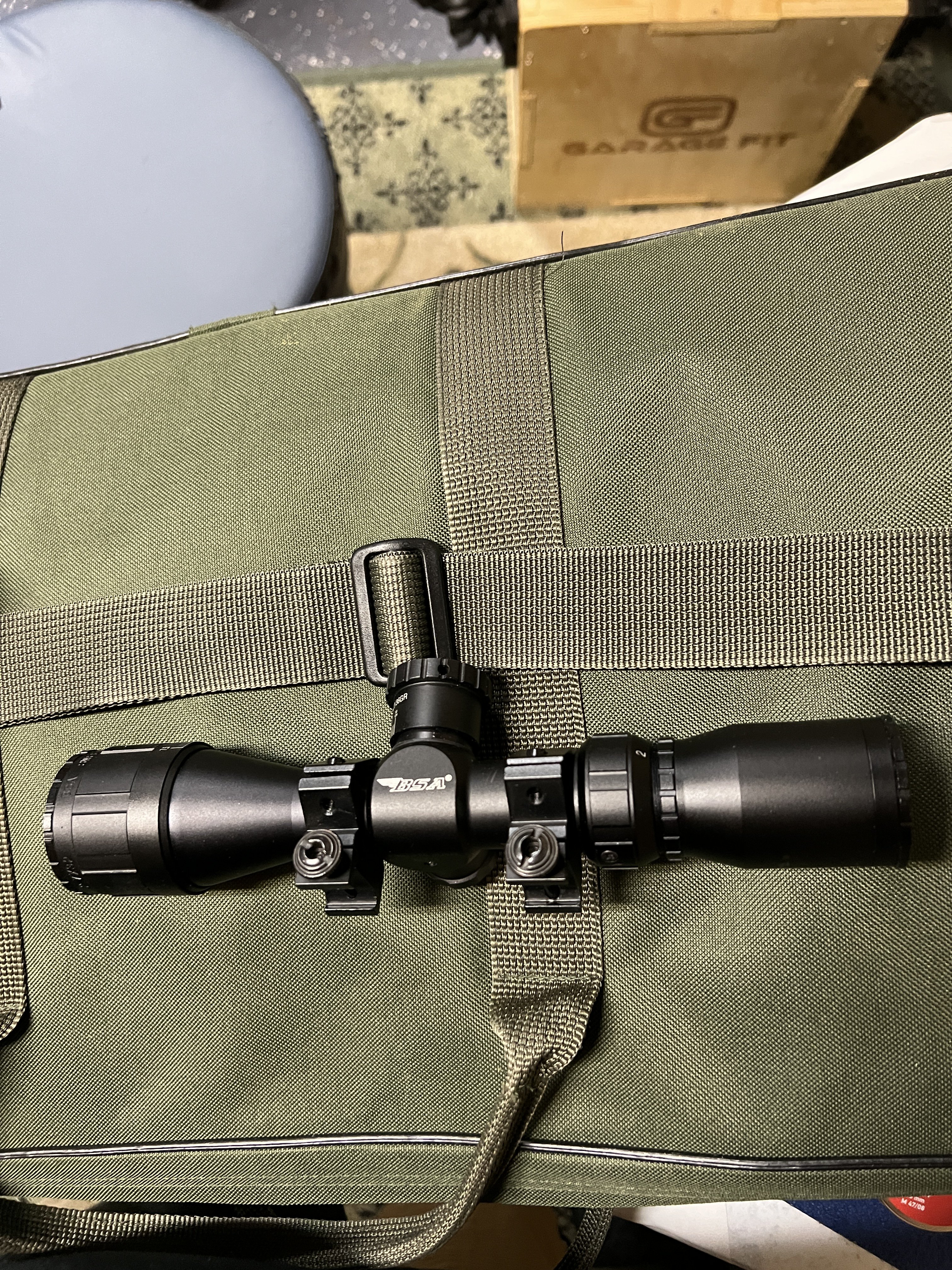

I was also torn on getting a scope. I'm gonna try a cheap bsa 2x20, and if i like it maybe get that really nice leupold fx-II 4x28. However, with just the built in sites, I was able to get 5 shots in 1" at 25 yards from my shooting bench. I'm not very good with open sights, so that was pretty impressive! I do think with a scope it should have accuracy and power for squirrels out to 50 yards, and tons of fun plinking. I guess I need to set up a line of 19 cans...

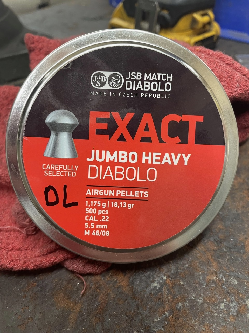

Another 500 pellets through the GK1. At this point I can’t recommend the CPHP’s. Once the magazine got enough pellets through it, it loosened up and the pellets would shift around in it and jam up. Same with the JSB exact jumbos.
I am currently 200 pellets into JTS dead center wadcutters. I like ‘em, no shifting, no jams. Better accuracy.
what grain wadcutters?
