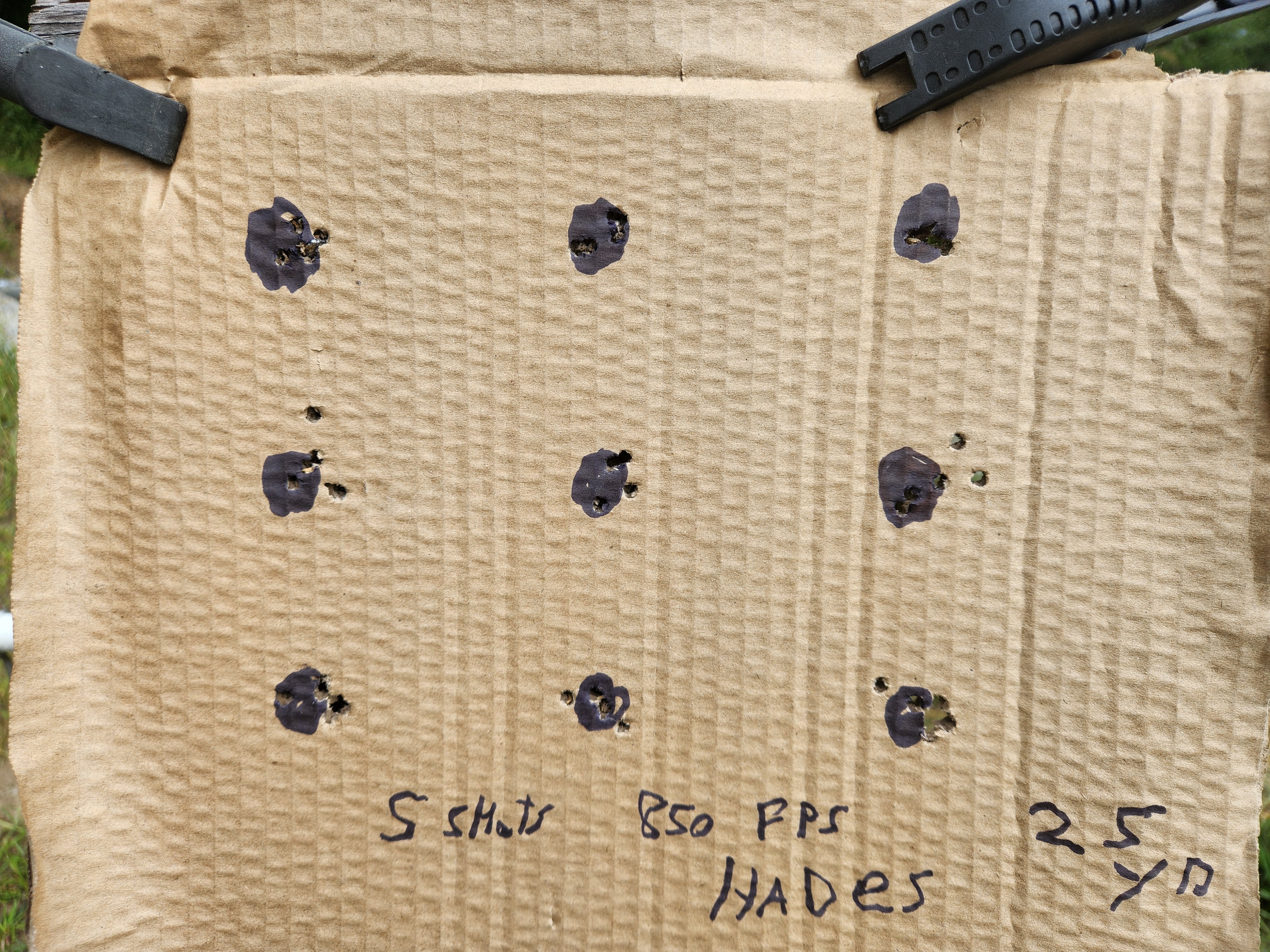

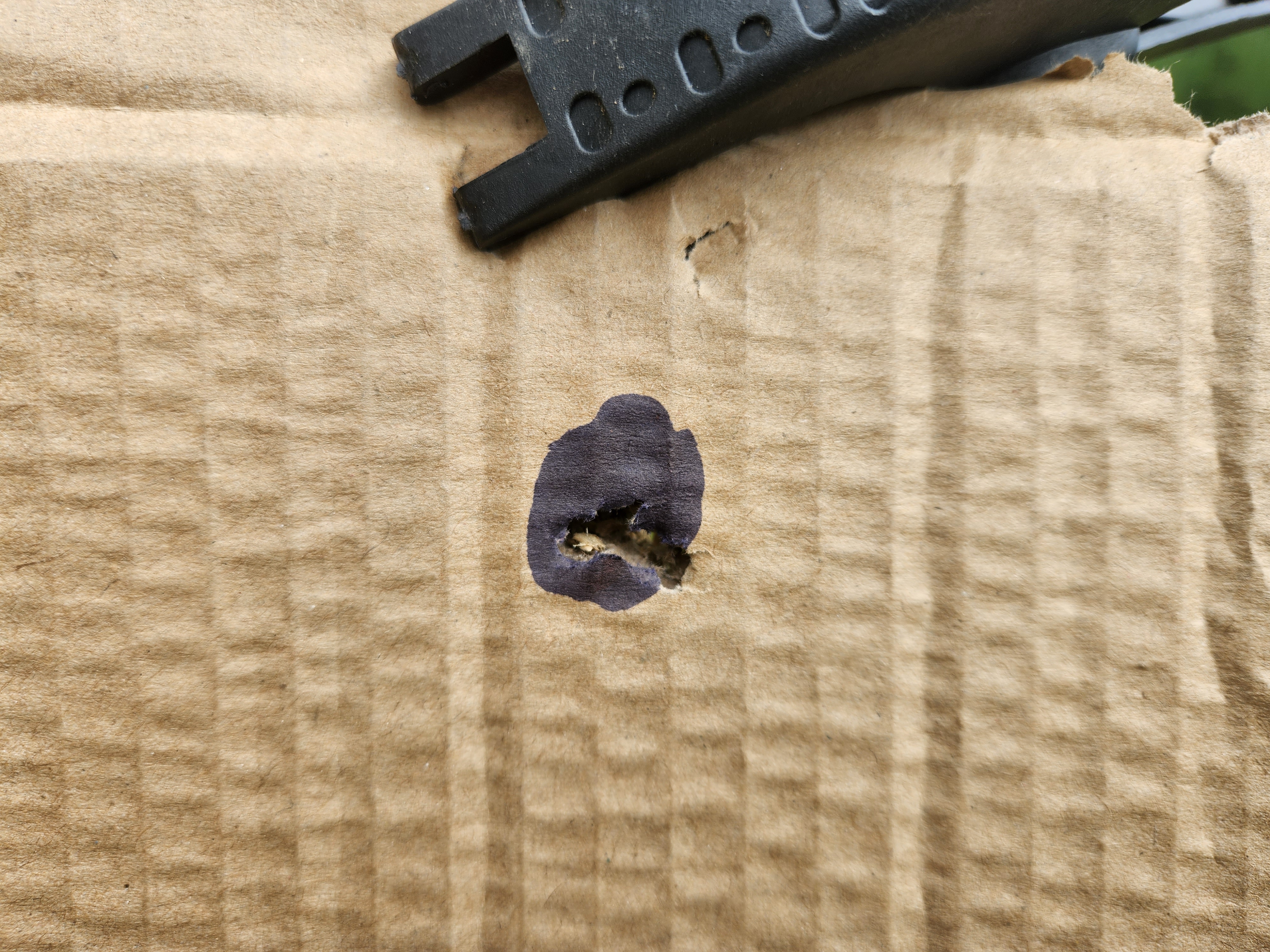

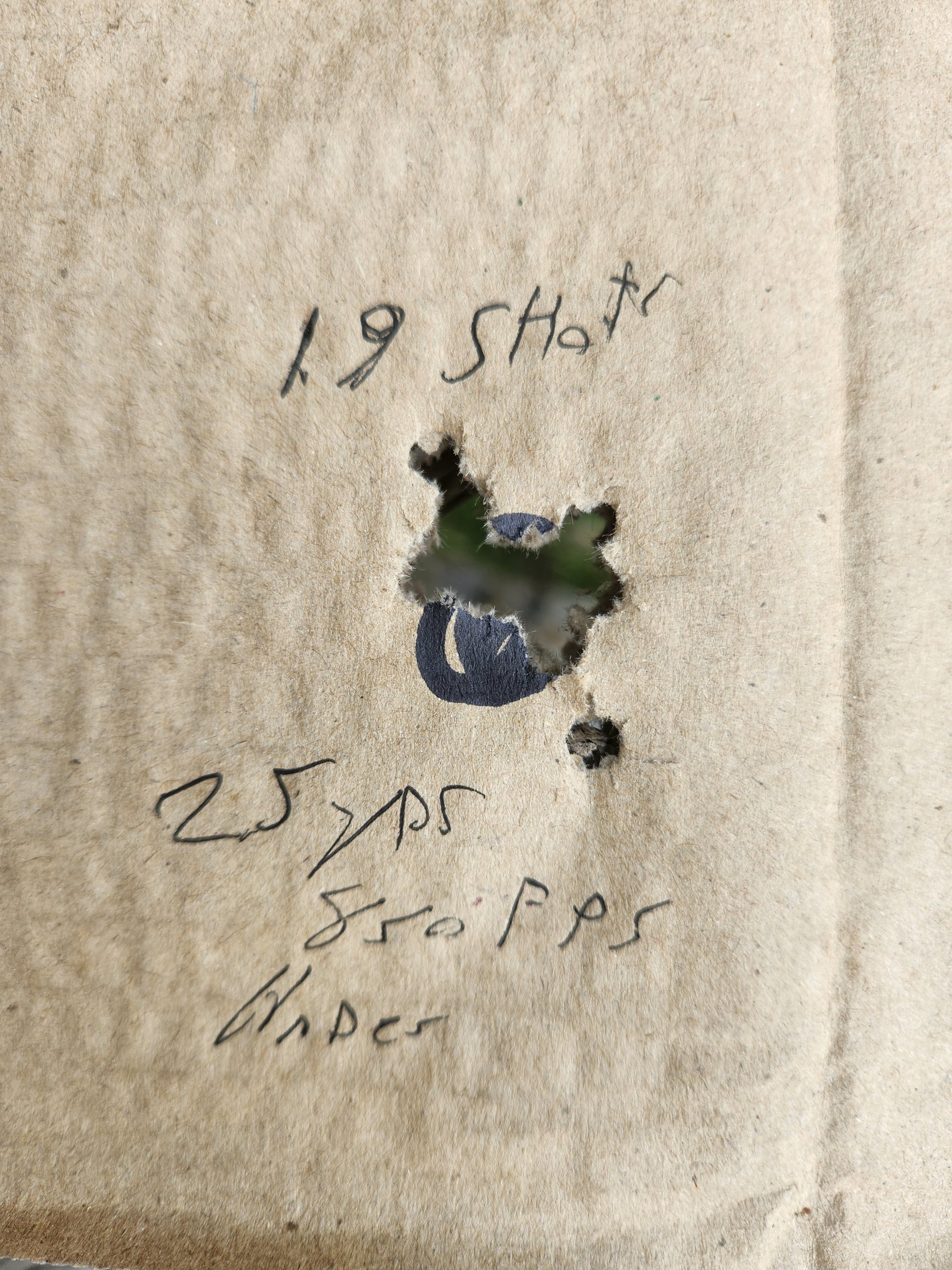

25 yards 5 shot groups & 19 shots. My top row was best. All the flyers were me. This gun is capable of some very good accuracy. I got it set for 850 with .22 Hades. My biggest complaint/only is how hard it is to open & close the cylinder lever. You need to be careful not to let the lever slip from your fat fingers.
My bad.
