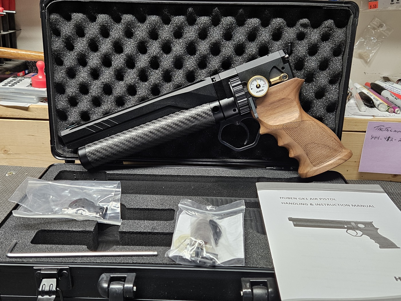

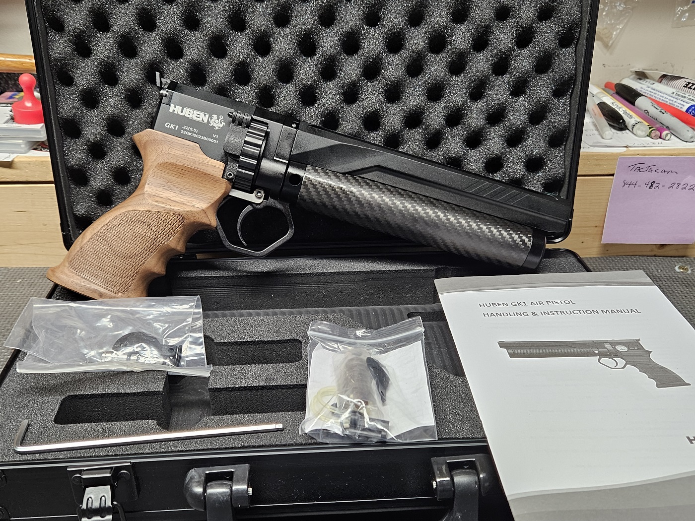

I got mine from Kelly today shot a few rounds through it in the basement trying to get a fps reading but the FX pocket chrony wasn't reading so I'll have to setup my labradar or pro chrono when I get back home Tuesday from visiting family in Branson, mine is number 51, I love how lite it is and it does have a great trigger.

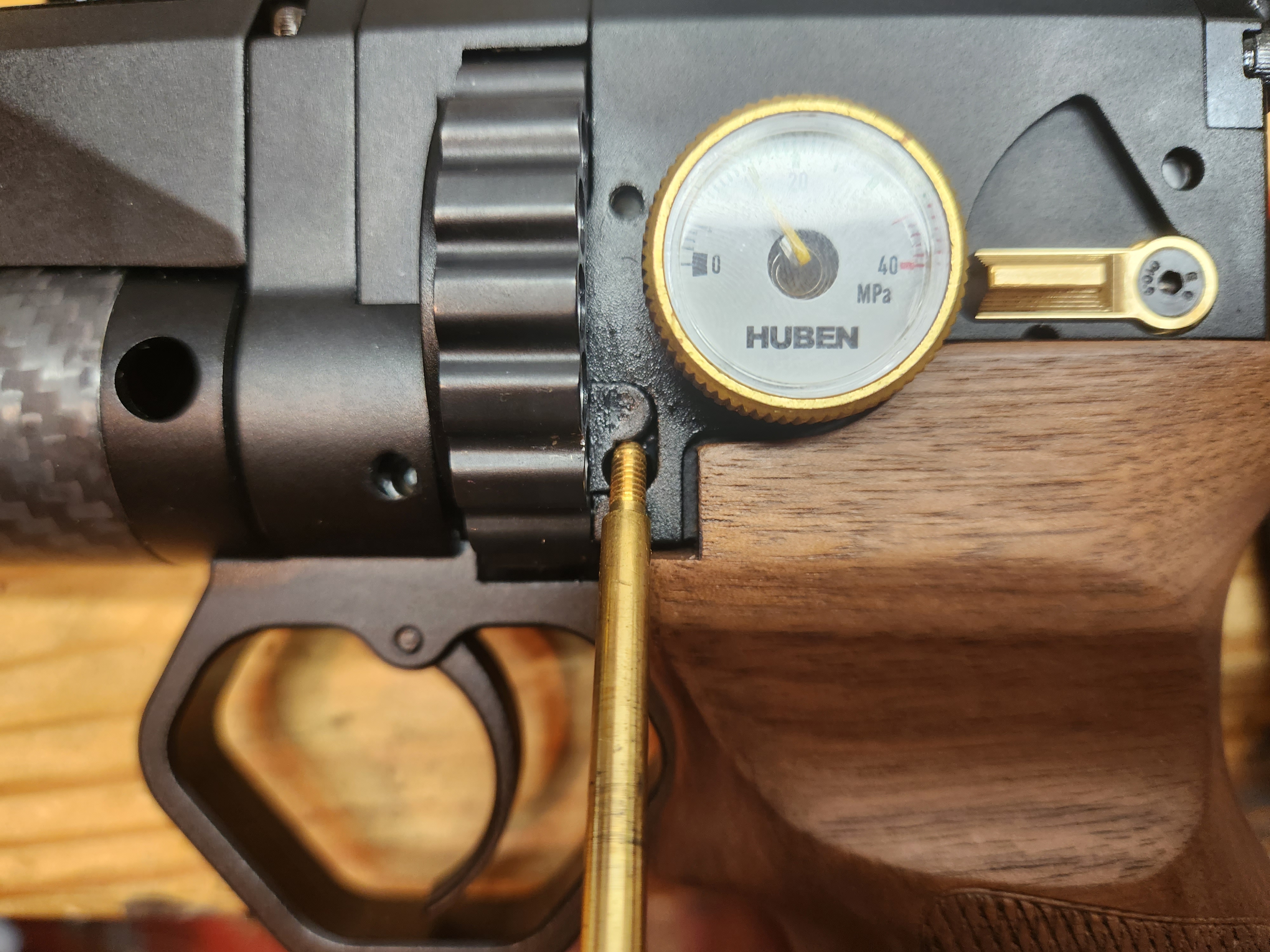

I had an issue today with the locking lever - it snapped just like on my rifle.
It is, however, the same part as the rifle! and Kelly had one for me, already reinstalled and working again. We did discover it has to be de-gassed to replace the locking lever though, because otherwise in cannot screw down due to the action sticking out.
Do you degass the pistol the same way you do the rifle? Like the video on Krazy Kool site? Removing the spring replacing the cap then firing?
Is this thingy what you are calling the action? Cause it is proud and the latch housing won't go on tight. So when I degas, will it go flush?
all correct
once it was degassed, that part went way down in its channel instead of sticking out. mine was at 250 bar too. it seems it is much harder to press down at tank pressure, since it is not regulated.

when kelly did mine, he took off the back sight screw and spring, then removed the back cap, took out the spring and collar, then put the collar back in, screwed the cap on, and then fired it. the lack of return spring let it stay open and emptied far enough...it still had a tiny pop of pressure...
