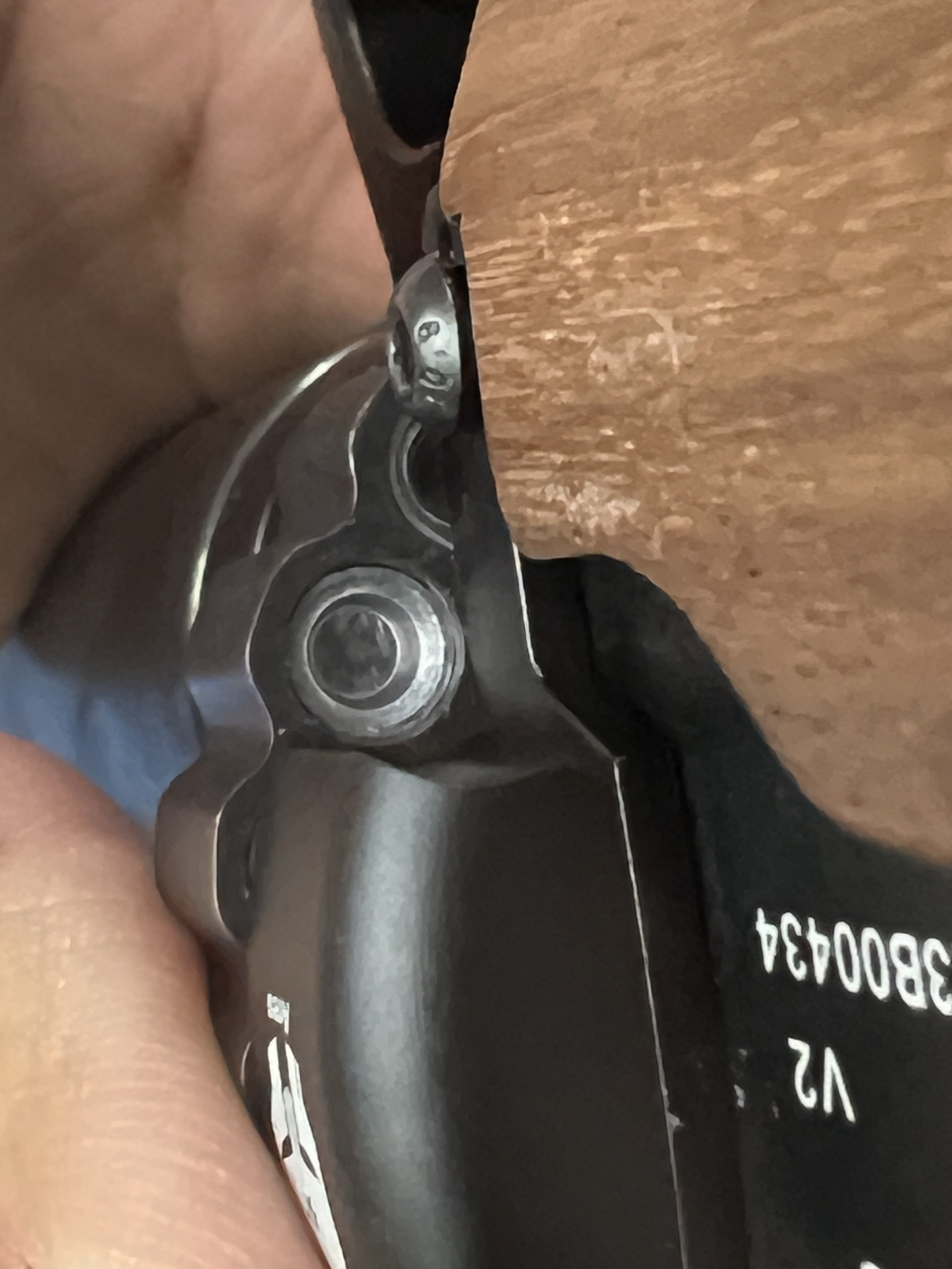

Well damn. I just used my GK1 with the Ares loading gate and a JSB pellet literally fell out while shooting upward. I agree that seating pellets should not be required nor should I be required to use “heavy” pellets.
The picture below shows the issue mid cycle.

Yeah, I tried gluing on a small extension to the end which helped to cover the lower chamber pretty good. But when I compared the OA length to my injection molded one from Airgun Tactical, the molded one was still longer than my extended one, and really covers all three holes nicely.
I put the molded one back on, and ordered a second one for my new K1.
You should not have to push the ammo any further in than flush with the rear edge of the magazine. If it isn't quite flush with the back then when you rotate it the skirt will bind a little and jam (so the magazine can't rotate to load any more), and all that is needed is to push it in a bit further. The only ammo I have had a problem with is either too long or the pellets with the pointed dome, because the skirt doesn't hold them back enough and the dome goes forward and hinders cycling.
I agree. I rarely seated pellets with my K1 and hope to never seat a pellet with my GK1. I'm a rapid fire blaster, the thought of having to spend time seating every pellet is not appealing. :)

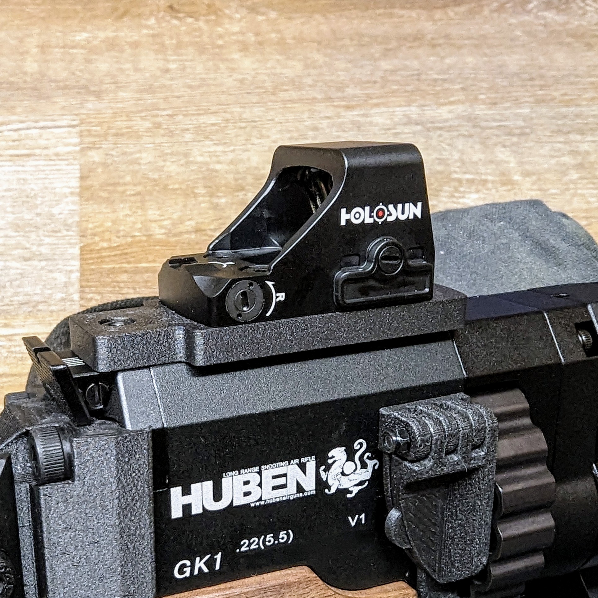

Got a chance to fit up a Holosun 507k, kind of like the super small footprint. I may have to snag one for the gk1 that doesn't have a buttstock.
That woldn't happen to you if you used my crappy 3D loading gate alternative instead:
No bolts needed, no small parts. I wonder why Huben and Ares have chosen those designs with small pins when the easyest and most elegant solution is just hold the thing against the the cilinder itself. ****... I even think 1.5 bucks is ripping people, that why I added the moderator, plus a free download to correct the factory masaligned treads. Seeing that the flawed Ares gate sells at 40 bucks, and the Huben one that is just a 3D print at 25 makes me scratch my head... why people pay that for a piece of plastic? you can even make something better out of junk, no 3d printer needed.
If you don't have acces to a 3D printer, you can just drill a piece of plastic, aluminium or junk molded to cover that incomprehensive gap, and use the same bolt to hold it in place so pellets won't fall of anymore.
