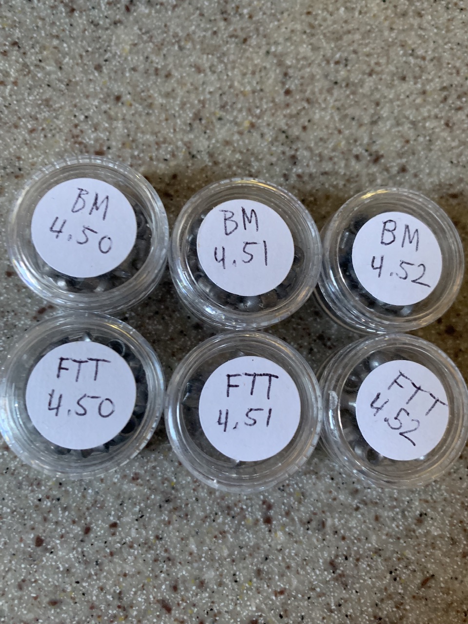

JD - point taken - I was exaggerating the crazy situation that were in. But let’s not get lost in the details. Another way to illustrate the craziness is to consider that many competitive shooters in the FT disciplines put in extensive effort, not only to find the best pellet, but to find the absolute best pellet head size.
Here is my set of 177 FTTs and Baracuda Match for such testing:
Note that they vary in head size by 1/100th of a millimeter increments. Now let’s consider the difference between a .218 and .223 bore: .005 inches is .127mm. Therefore, we are using pellets with heads and skirts that are undersized by more than 10 times the difference that field target shooters consider to be capable of affecting accuracy. Again, this is madness.
Perhaps it’s time that we (the K1 AND GK1 community) made an effort to address this problem. Perhaps the K1 community was never large enough to sway the pellet manufacturers, but the pistol is selling faster than Huben can make it (and everyone, from hacks to pros: like Derrick Wall) love it. I propose that we make a thread targeting various pellet manufacturers and make an appeal to get some properly sized pellets. Are you in, Huben community members?
