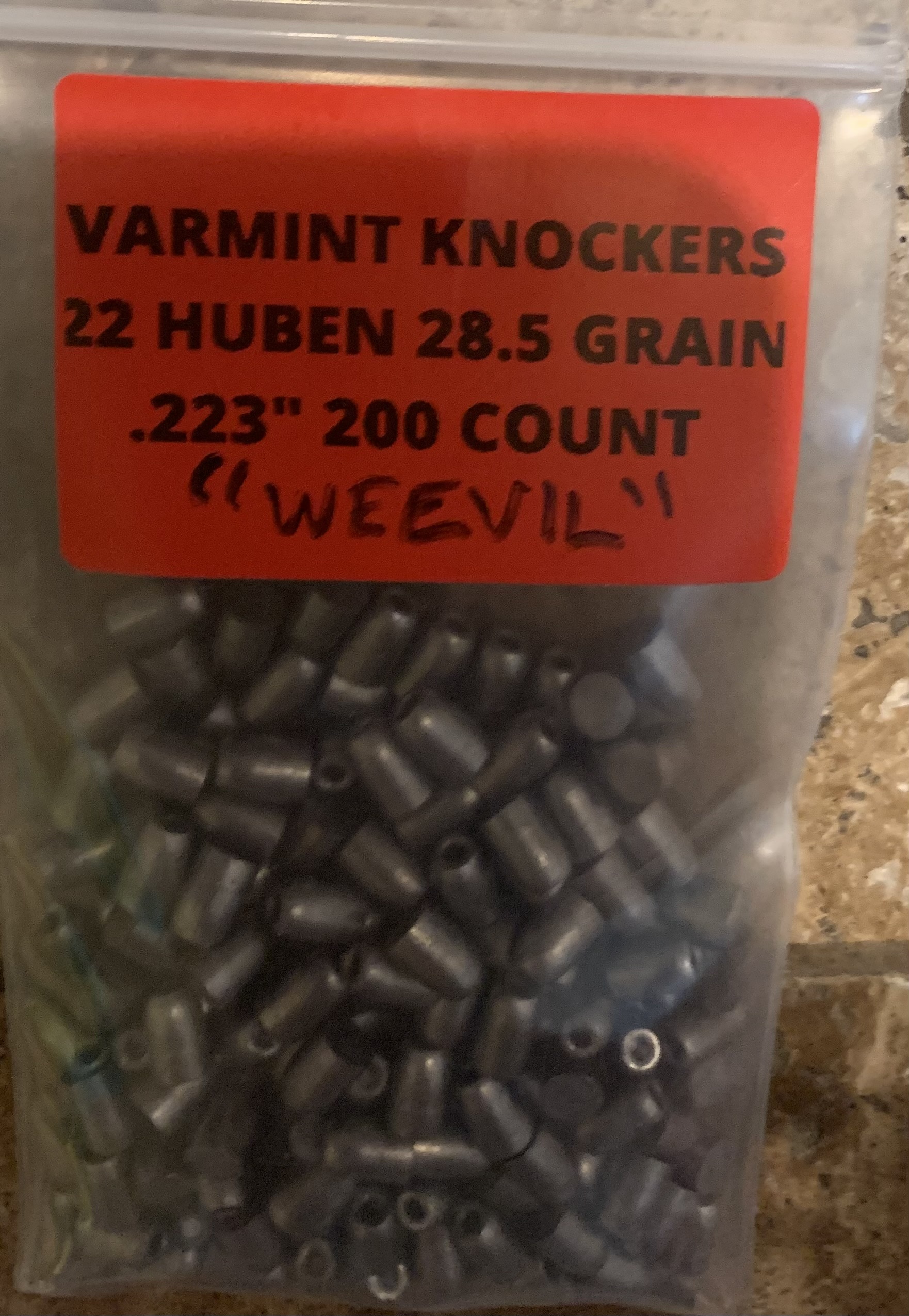

I just obtained those slugs and will try them in my .22. Here’s a pic, with my name written on it, to confirm that I do actually own some (which I purchased based on wimpanzee’s previous recommendation; thanks).
If these do shoot with somewhere near the accuracy of my GTOs then I would be willing to use them because there should be a useable string. On that note, I shot some 40grain AVS .223 slugs last night (from 300bar) and witnessed both a dreadful Korean cliff in power (much more dramatic than JDs numbers), accompanied by very poor accuracy (relative to pellets) at just 40yards. Note that the lighter (22grain .223) AVS shoot very accurately from both the pistol and rifle, although not as well as the better pellets. FYI, pics of my rifles are available on other threads if needed.

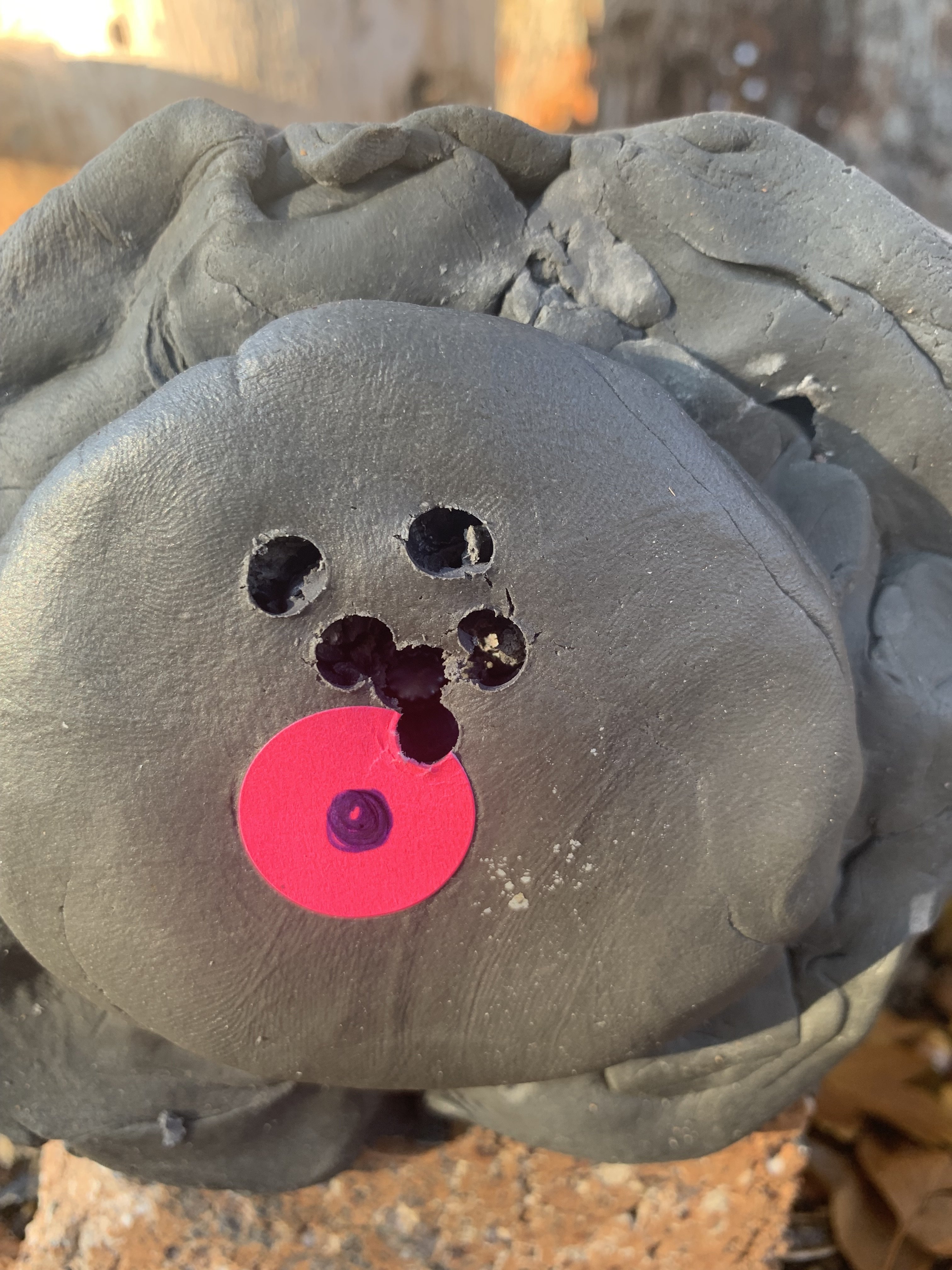

First test of the VKs. I don’t recall wimpanzee suggesting a speed, so I set it to shoot them at 850fps at 250bar, which is the middle of my typical 300-200 range of use. Then filled to 300 and shot this string:
Huben 22
VK 28.5gr
Shot count: 12
Low: 786 FPS
Hi: 865 FPS
Avg: 838 FPS
Spread: 79 FPS
STD Dev: 21.0 FPS
13-Dec-2023 08:30:22,854,FPS,46.1,FT Lbs,
13-Dec-2023 08:30:30,865,FPS,47.4,FT Lbs,
13-Dec-2023 08:30:56,849,FPS,45.6,FT Lbs,
13-Dec-2023 08:31:07,840,FPS,44.6,FT Lbs,
13-Dec-2023 08:31:17,856,FPS,46.4,FT Lbs,
13-Dec-2023 08:31:28,854,FPS,46.1,FT Lbs,
13-Dec-2023 08:31:40,847,FPS,45.4,FT Lbs,
13-Dec-2023 08:31:51,837,FPS,44.4,FT Lbs,
13-Dec-2023 08:32:03,821,FPS,42.7,FT Lbs,
13-Dec-2023 08:32:34,828,FPS,43.4,FT Lbs,
13-Dec-2023 08:32:43,817,FPS,42.2,FT Lbs,
13-Dec-2023 08:32:55,786,FPS,39.1,FT Lbs,
Stopped at 12 (190bar) because it was clearly on the downslope but encouragingly, the slugs formed one conglomerate at 30y, suggesting that they are shooting accurately. However, I’m not in need of 45fpe and I’d like to be able to use a full mag from 300bar, so I’ll retune for 820fps at 250bar and see how that improves the string.

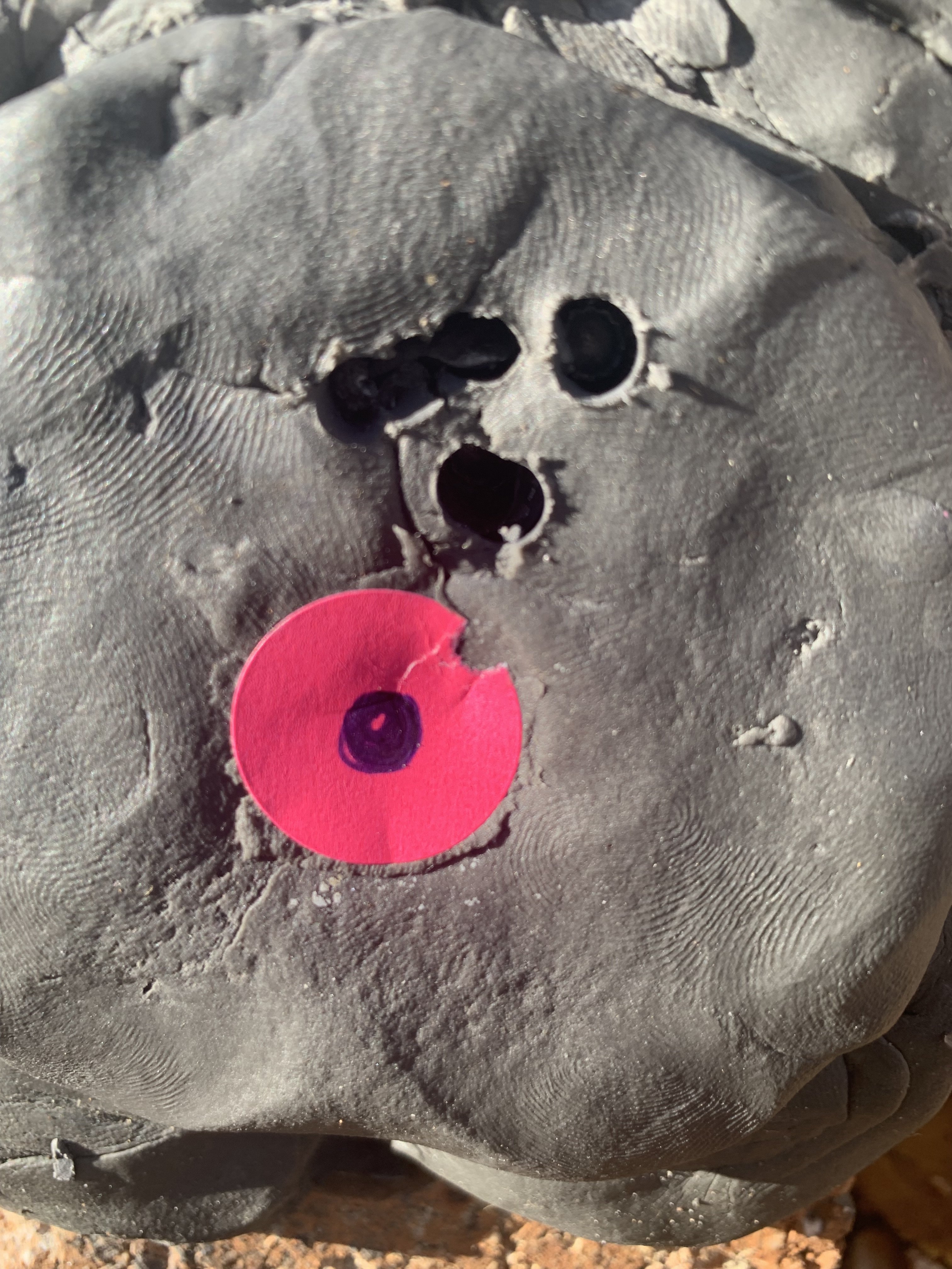

Really interesting data (comparatively) from the AVS dish .223 22 grain! Did not change the power adjuster from the test shooting VKs at 800. Here is the string from 300bar. The chrony missed #7 this time. It must have been upset that I went to photograph the 6 shot group!
Huben 22
AVS 22.0gr
Shot count: 22
Low: 835 FPS
Hi: 881 FPS
Avg: 864 FPS
Spread: 46 FPS
STD Dev: 14.7 FPS
13-Dec-2023 10:08:06,840,FPS,34.5,FT Lbs,
13-Dec-2023 10:08:25,849,FPS,35.2,FT Lbs,
13-Dec-2023 10:08:41,847,FPS,35.0,FT Lbs,
13-Dec-2023 10:08:51,851,FPS,35.4,FT Lbs,
13-Dec-2023 10:09:01,849,FPS,35.2,FT Lbs,
13-Dec-2023 10:09:10,868,FPS,36.8,FT Lbs,
13-Dec-2023 10:12:22,854,FPS,35.6,FT Lbs,
13-Dec-2023 10:12:33,872,FPS,37.2,FT Lbs,
13-Dec-2023 10:12:45,872,FPS,37.2,FT Lbs,
13-Dec-2023 10:13:00,877,FPS,37.6,FT Lbs,
13-Dec-2023 10:13:17,877,FPS,37.6,FT Lbs,
13-Dec-2023 10:13:33,881,FPS,38.0,FT Lbs,
13-Dec-2023 10:13:46,881,FPS,38.0,FT Lbs,
13-Dec-2023 10:14:05,881,(I rFPS,38.0,FT Lbs,
13-Dec-2023 10:14:47,881,FPS,38.0,FT Lbs,
13-Dec-2023 10:15:05,879,FPS,37.8,FT Lbs,
13-Dec-2023 10:15:21,875,FPS,37.4,FT Lbs,
13-Dec-2023 10:15:35,868,FPS,36.8,FT Lbs,
13-Dec-2023 10:18:08,865,FPS,36.6,FT Lbs,
13-Dec-2023 10:18:25,856,FPS,35.8,FT Lbs,
13-Dec-2023 10:18:43,847,FPS,35.0,FT Lbs,
13-Dec-2023 10:18:52,835,FPS,34.1,FT Lbs,
Note that I added more slugs to fully evaluate the curve, which was shifted down the pressure range, such that for the above data, final pressure is at 165bar. If I were to go for a mag full it would be shot numbers 3 to 22 encompassing 850, through 880 and back to 850fps. Guessing 280-180bar or thereabouts. My first 6 shots, which are shown below are therefore not the best to evaluate accuracy, but the results are here:
