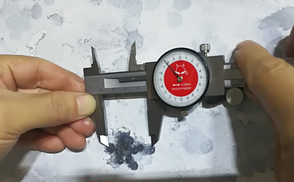

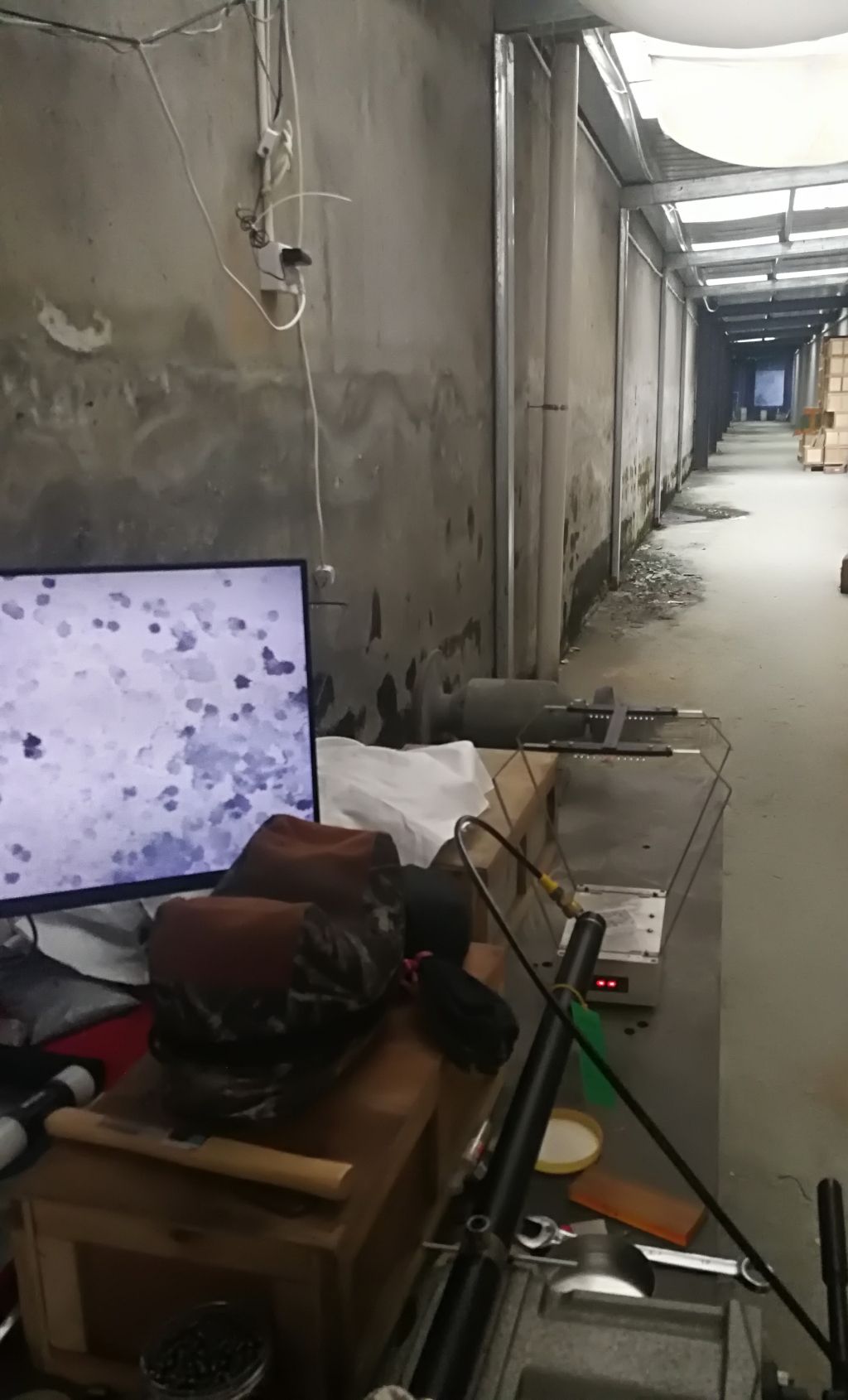

Because of moving to new factory to manufacture K1 by ourselves, everything started from the beginning again. Today, I have a chance to spend some time in accuracy testing workshop, below information share with all of you.

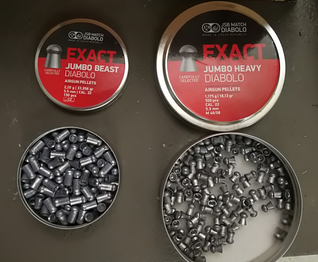

1. Test pellets
2. Test at 50mts

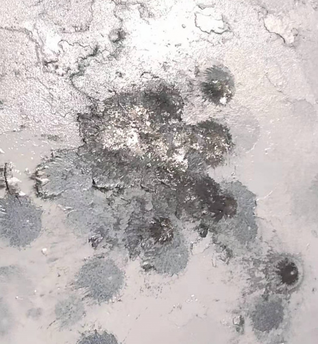

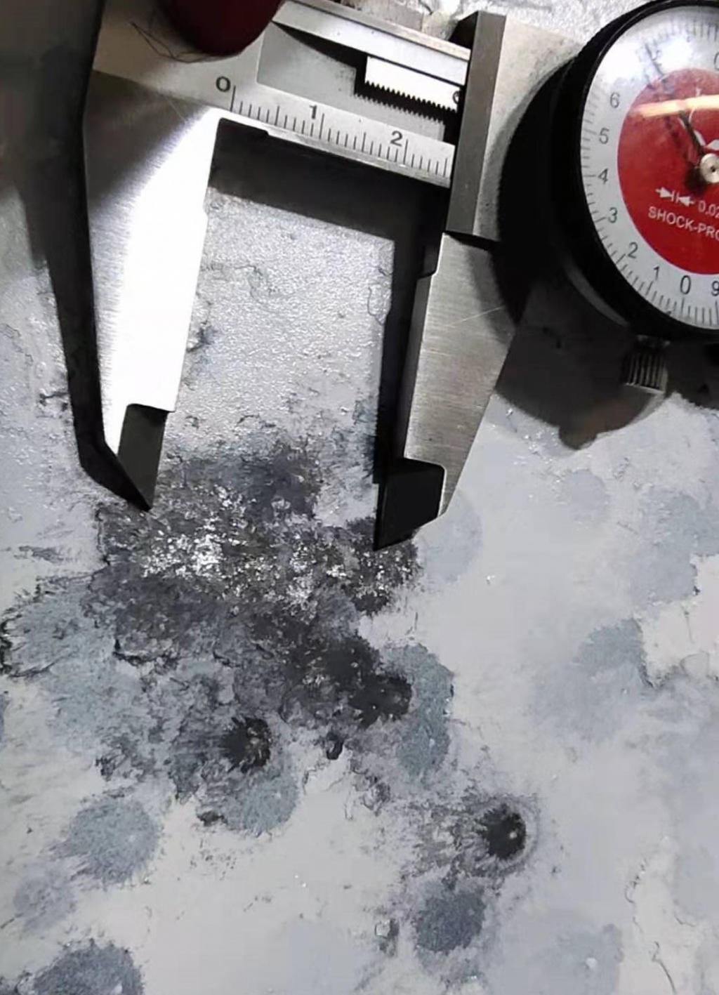

3. JSB EXACT JUMBO HEAVY (1.175g/18.13gr)

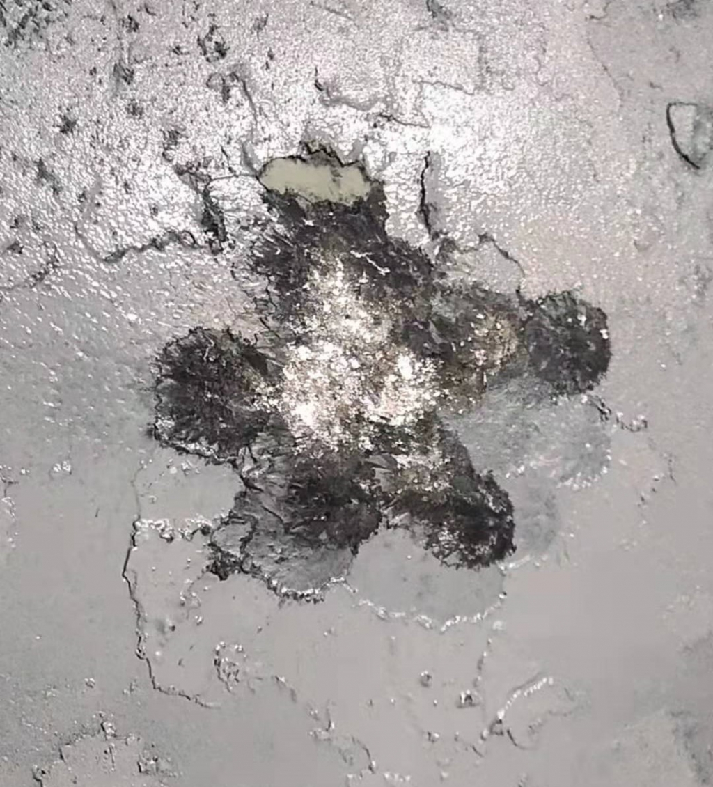

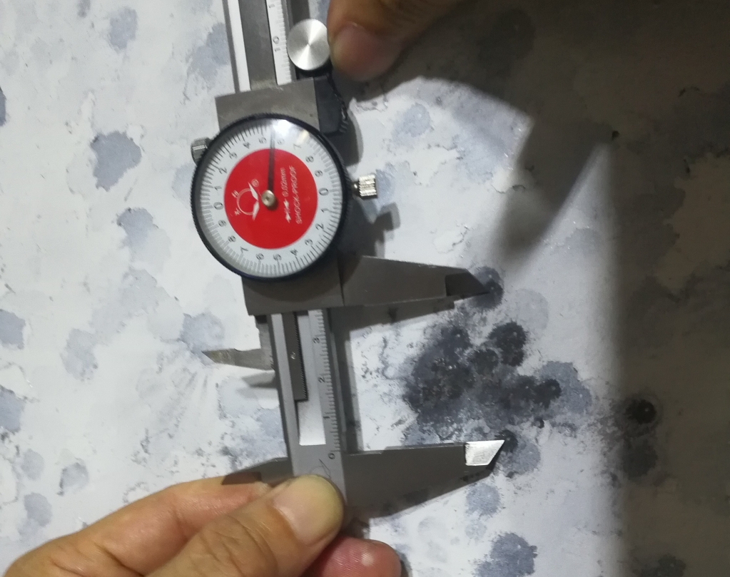

Group 1#: 5 shots
Shooting video: https://www.facebook.com/jacky.ling.52459/videos/pcb.136662647608726/136662500942074/?type=3&theater
Group 2#: 5 shots
Shooting video: https://www.facebook.com/jacky.ling.52459/videos/pcb.136663257608665/136663110942013/?type=3&theater
Group 3#: 19 shots
Shooting video: https://www.facebook.com/jacky.ling.52459/videos/pcb.136664224275235/136664024275255/?type=3&theater

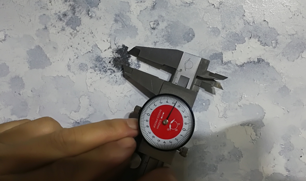

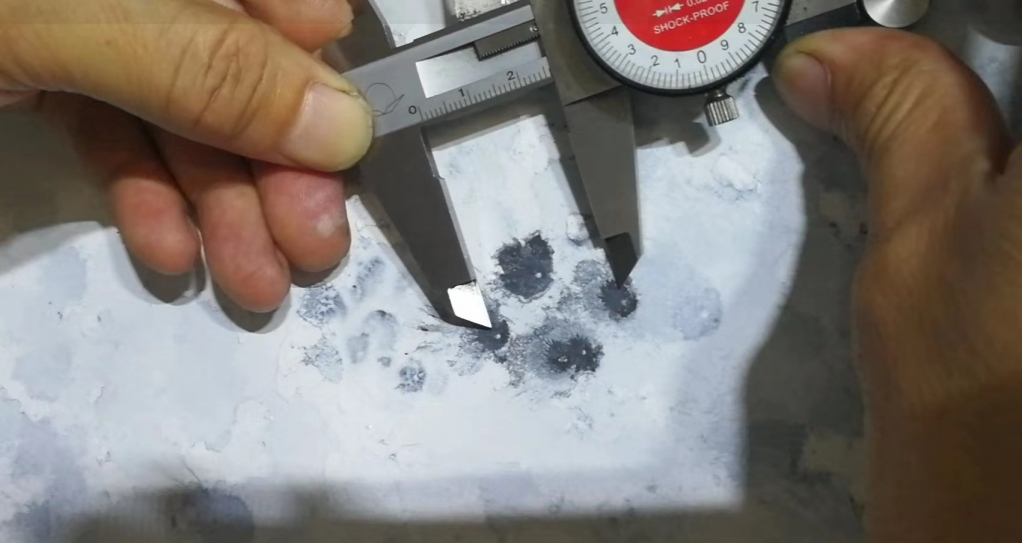

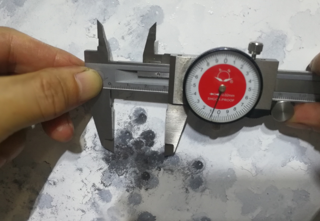

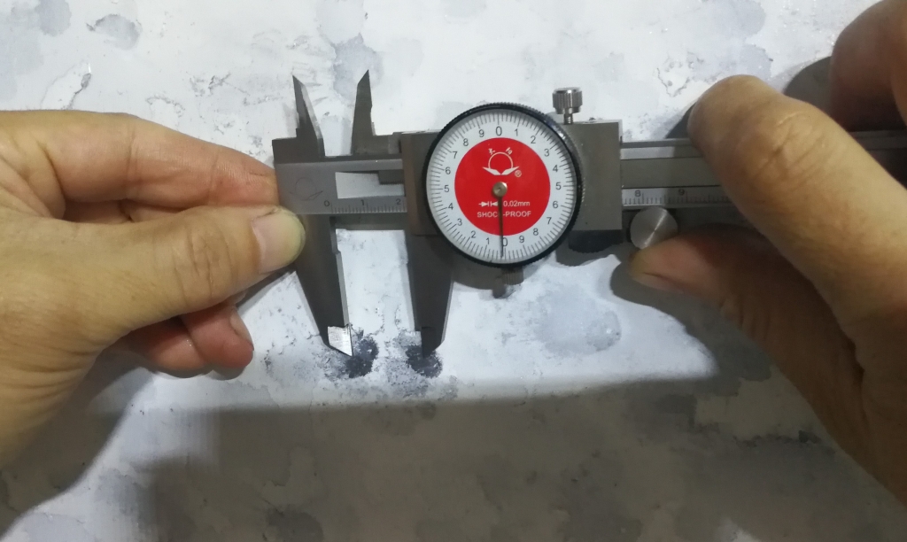

4. JSB EXACT JUMBO BEAST (2.2g/33.956gr)

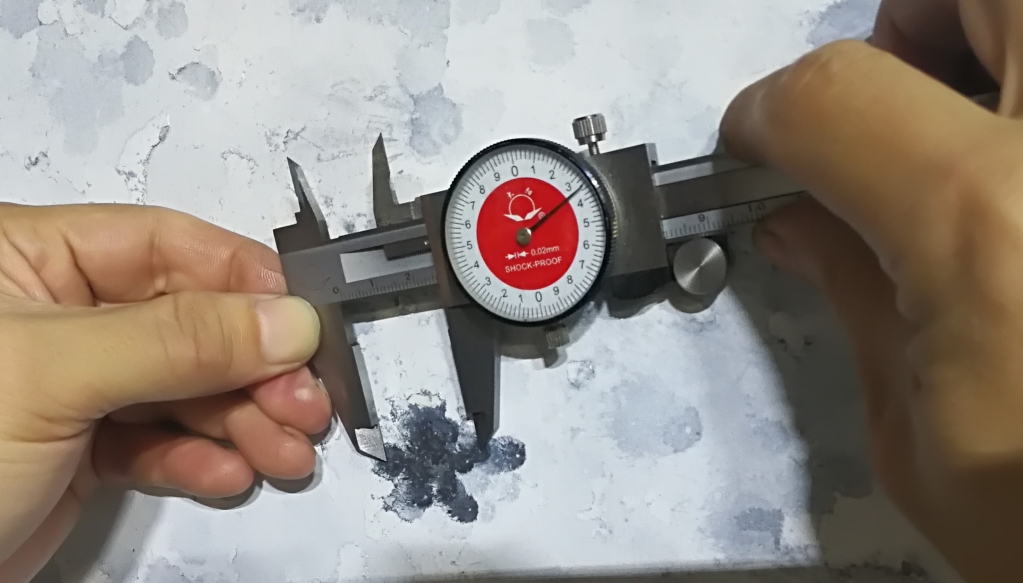

Group 1#: 5 shots
Shooting video: https://www.facebook.com/jacky.ling.52459/videos/pcb.136664997608491/136664897608501/?type=3&theater

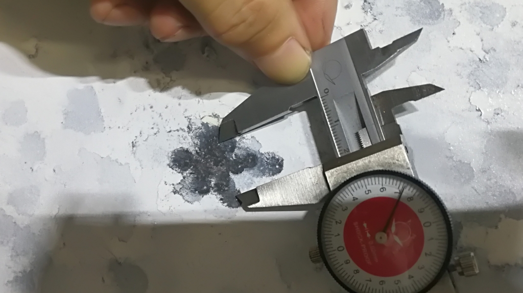

Group 2#: 19 shots
Shooting video: https://www.facebook.com/jacky.ling.52459/videos/pcb.136665980941726/136665470941777/?type=3&theater

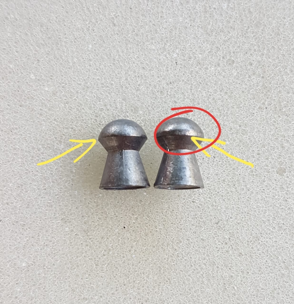

To obtain excellent results with JSB pellets It is necessary to use special batches that have the head measurement equal or greater than 5.52 mm and the shape of the head on its side is more round. With these correct characteristics is obtained in average groups from 15mm to 50 meters at a speed of 300 meters per second.
See the difference in the head finish of these 2 JSB heavy of 18.13 gr (different batches)
The right pellet is what gets excellent results already the left is not so good.
These data were obtained in tests with K1 of 3 and 4 generation in the caliber 22
