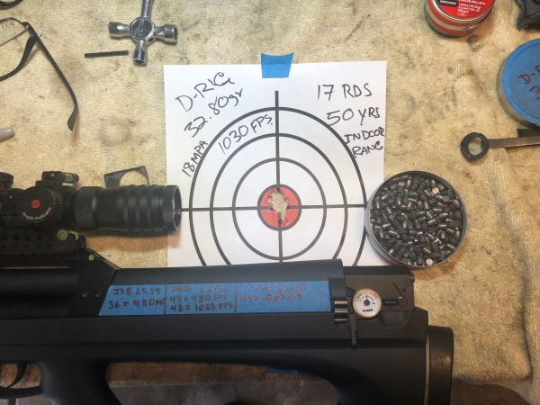

The 25 caliber Huben does have some potential 17 shots at 50 yards
at a indoor range with some swage ammo , 32,80 grain at 1030 fps . Dale
