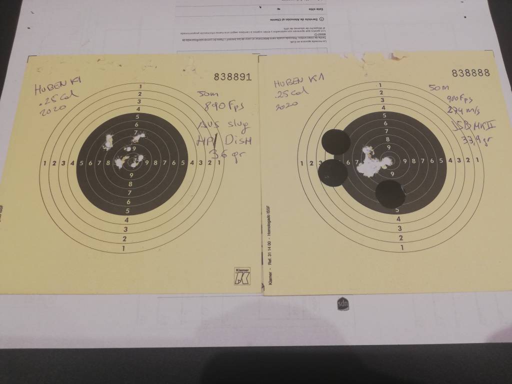

Excellent results have not yet been achieved with slugs, there are people working on it to improve it, the barrel is indeed Chinese with pellets they work well with MKII and with slugs there are people who have obtained good results with knock out. I had the best results with the AVS slugs 254 but I am still working to improve it

With 38 and 40gr the results are better this barrel likes heavy slugs

Nope AVS 254cal HP/DISH

Looks like a little stringing..Windy? Do you have the results of the 38 and 40's? You said they were better.
