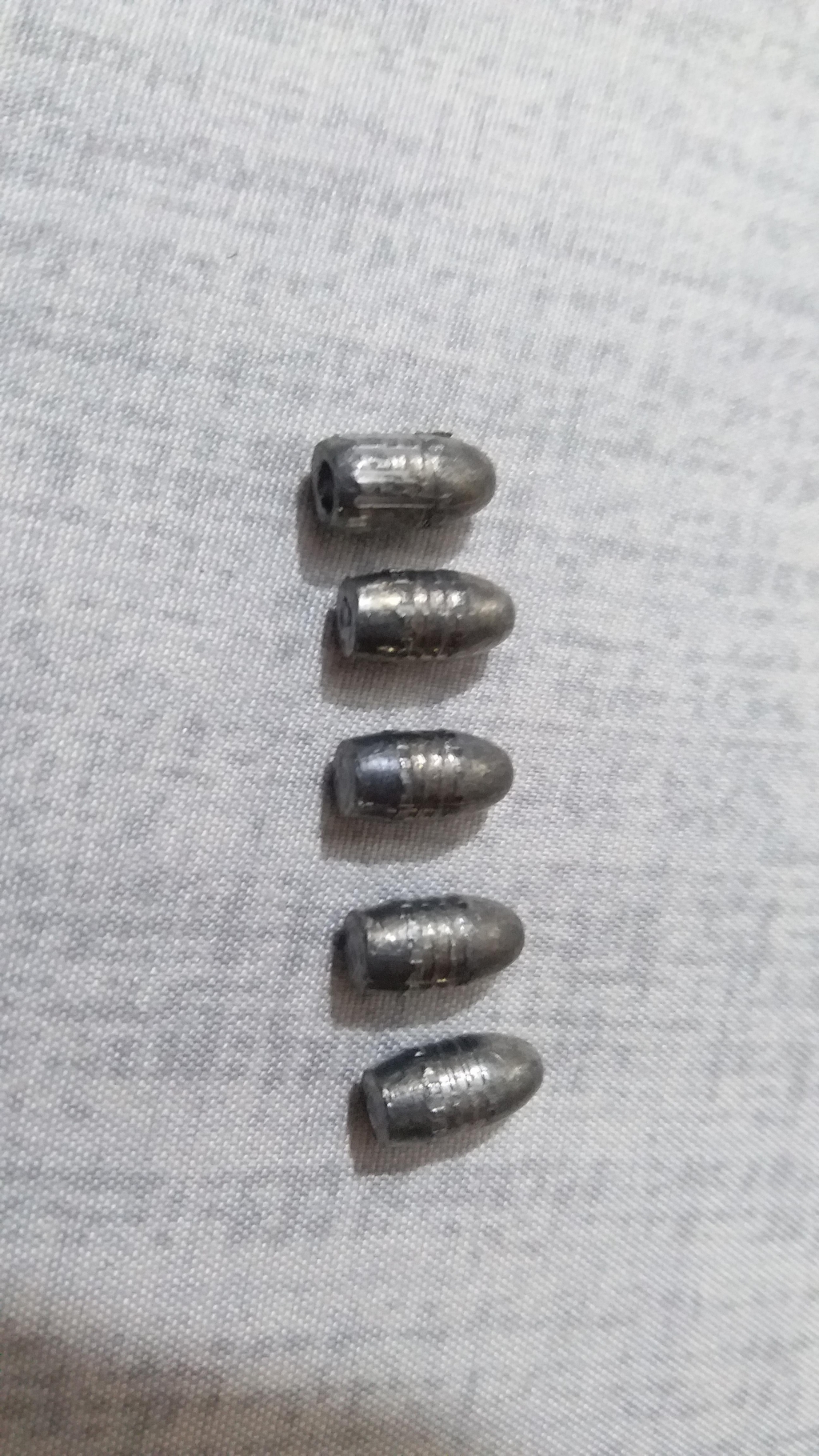

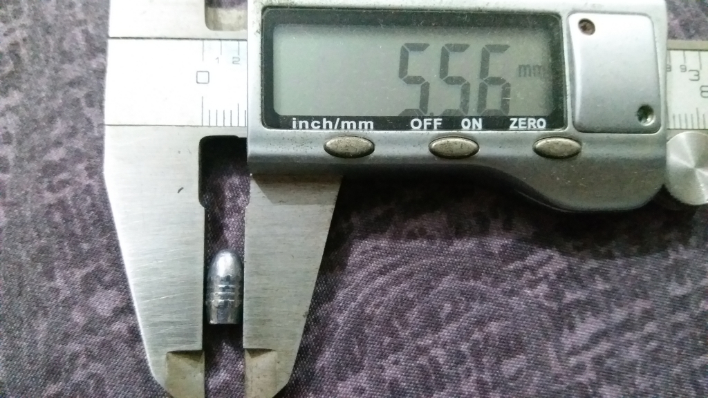

huben is not accurate at 15 yards with mp mold slugs 5.52 . The group size is 4 inches what should I do
I have tried both 5.52 and 5.55, the latter is much better accuracy wise
Make sure that you use lube of some kind. I use Krytox GPL 105 oil. I have tried un-lubed slugs right out of the mold and the result was terrible. I had to JB the barrel to remove the lead deposite inside.
As a refinement, I add 3% tin to the lead to make the slugs a bit harder. The accuracy is better than that achieved with pure-lead slugs. I believe the softness of pure lead results in more deformation when the slug transits from the magazine to the barrel.

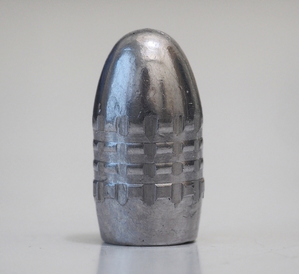

You may also want to check whether the two mold halves are aligned perfectly as I notice that the seam line on the slugs in your photo are very prominent. This is a 5.55 slug coming out from my MP-mold . The seam line should is quite faint
After being pushed through the barrel :
This is a 10-shot group at 11 yards. CTC is about 2.5 mm

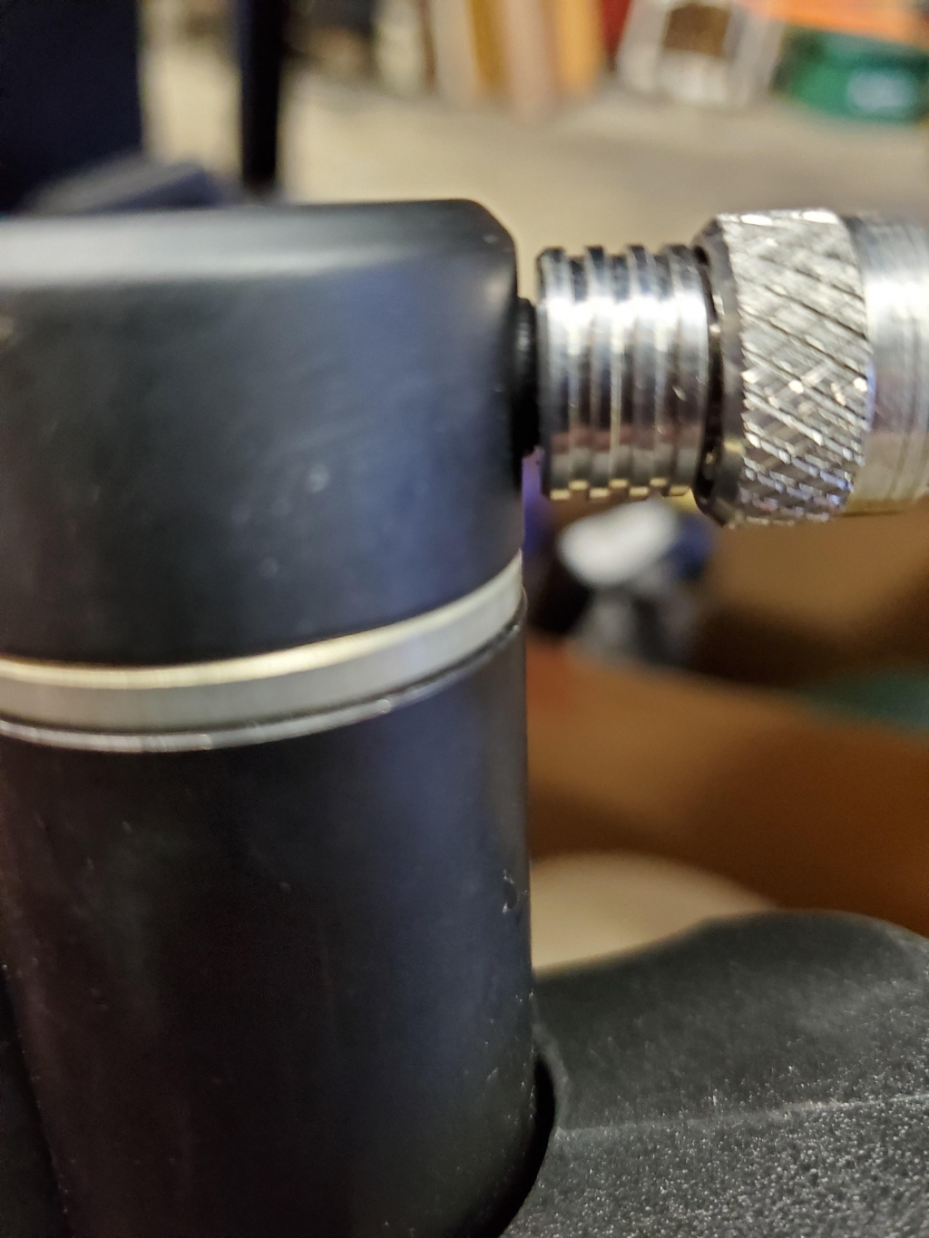

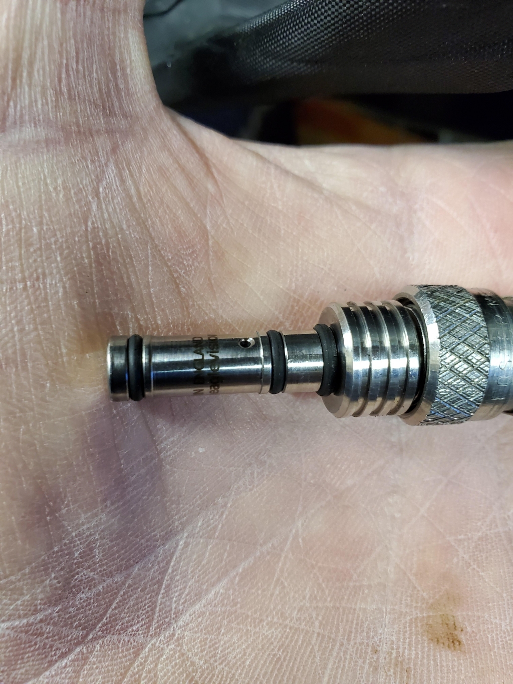

I just purchased a new Huben K1 (v2) and it came with a fill probe that does not fit into the filling port. It has three orings, two smaller ones and one bigger, the same like on your picture. But that bigger one can not go into the filling port. I tried everything, silicon grease, more force,... up to the point that I ruined the bigger oring. So I am stuck and can not fill my rifle :(
I believe that the 3rd o-ring does not go into the gun. I don't have my gun right now but what i remember I thought the same thing you did. Make sure the 2 o-rings are in the gun, start filling the gun slowly with air. It will leak just a little at first but then it will set the o-ring and it won't leak anymore. Then you can fill the gun like normal.
