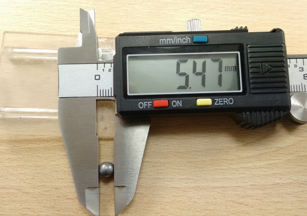

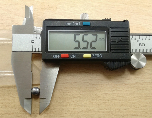

"Diaz"As you can see in the picture in the boxes of 250 pellest of jsb exact jumbo heavy most are of the diameter announced 5.52 to 5.54 (the greater diameter for the Huben works best) and in the boxes of 500 pellest almost all are less than 5.50 in diameter ?????
I noticed the same thing lately. I've tried a lot of different batches of the regular JSB Jumbo and the Jumbo Heavies but they all seem to be smaller than 5.50. Even when I bought a couple of oversized tins (5.53) the biggest I found was two pellets of head size 5.51, all of the rest were smaller..

I grabbed a few of the Barracuda Power's, 21.14 grain, and most measured 5.53mm, a few as low as 5.51mm.
