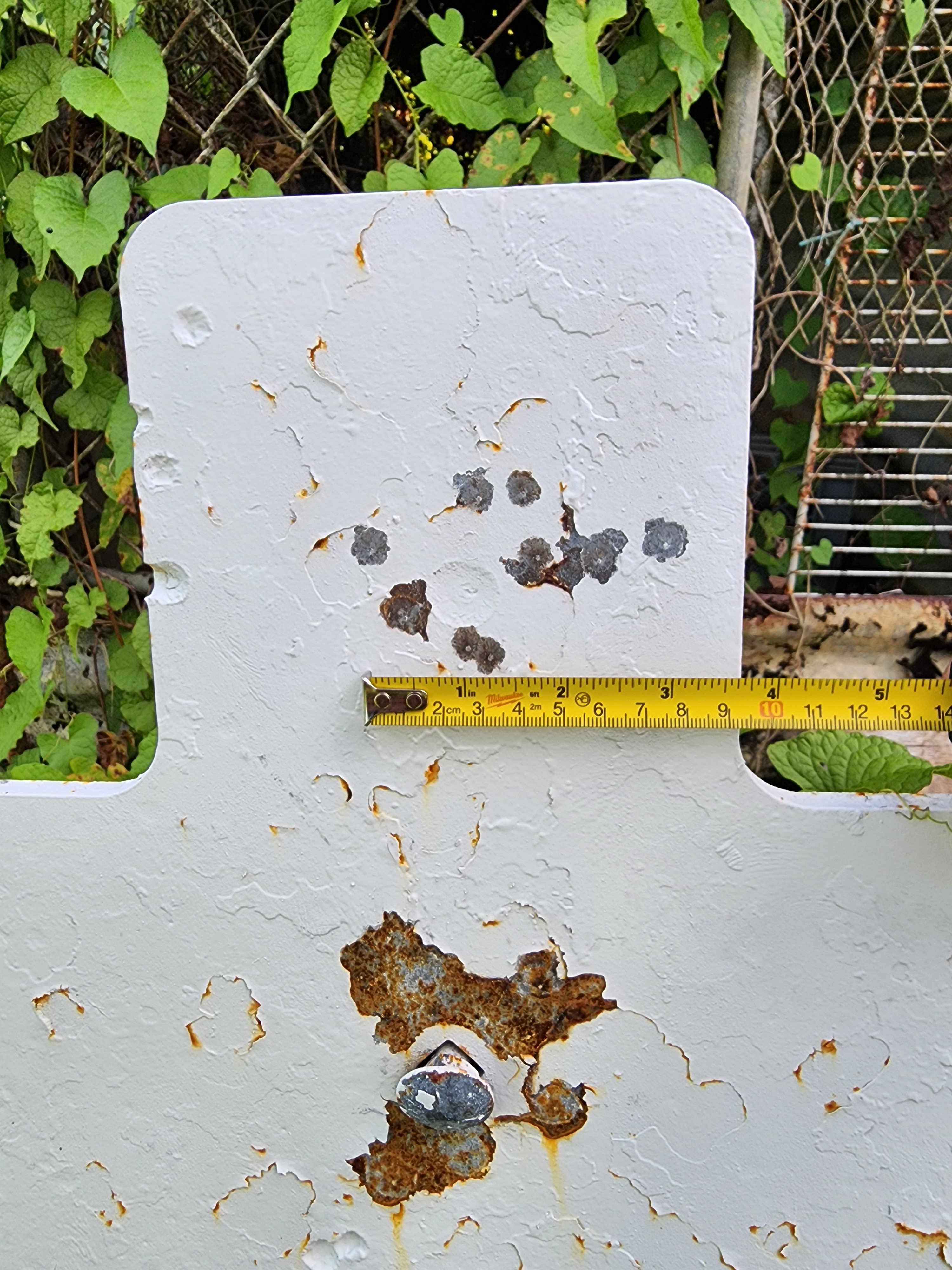

I get 1 inch at 50m with the .25 GK1, with 6 baffles of Impulse Air IA 1200. It widens to 2-3 inches at 50m with my other moderators - the Huggett Standard and some Weihrauchs. This is with 25grain JSBs set at 870 fps.
It might be possible to do 0.5 inches at 50m with a better bypod attachment, the ones that are on the trigger guard like mine move too much because the trigger guard itself is not very well attached to the receiver; it needs to straddle the air tank and to actually attach on the 11mm rail on top.
